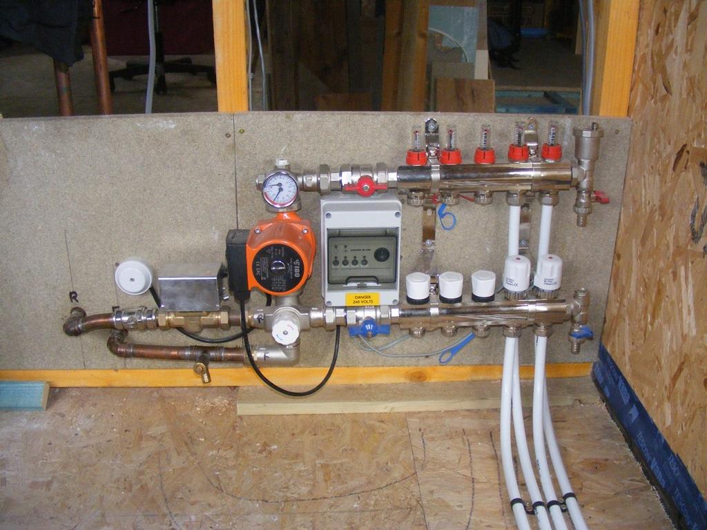

ProDave Posted October 7, 2019 Share Posted October 7, 2019 On the subject of manifold systems. Yes very handy. But finding the right location that does not use up lots of pipe or make the runs longer than they need to can be a challenge. I solved that by putting the manifolds above the ceiling of the utility room. There will be a mini loft hatch arrangement to access it. Acceptable in a utility room but probably not in any other room though. 1 Link to comment Share on other sites More sharing options...
ToughButterCup Posted October 7, 2019 Author Share Posted October 7, 2019 Like this for example ... ( given that I'm using Hep 2o) Link to comment Share on other sites More sharing options...
Jeremy Harris Posted October 7, 2019 Share Posted October 7, 2019 6 minutes ago, AnonymousBosch said: Like this for example ... ( given that I'm using Hep 2o) Yes, exactly like that. You can add reducers for the pipes you may wish to run in 10mm, and if you want absolutely minimum interference between circuits you can run the supply pipes to each manifold to both ends. @PeterStarck has a photo in his blog of this: 1 Link to comment Share on other sites More sharing options...
ToughButterCup Posted October 7, 2019 Author Share Posted October 7, 2019 Just now, ProDave said: [...] But finding the right location that does not use up lots of pipe or make the runs longer than they need to can be a challenge. [...] I have had a look at your site ( url masked so I cant give the exact url). So I stole this image from http://www.willowburn.net/ (without your permission) Red's the hot manifold and white the cold one? Why the spare ports on the manifolds? Link to comment Share on other sites More sharing options...
ProDave Posted October 7, 2019 Share Posted October 7, 2019 17 minutes ago, AnonymousBosch said: I have had a look at your site ( url masked so I cant give the exact url). So I stole this image from http://www.willowburn.net/ (without your permission) Red's the hot manifold and white the cold one? Why the spare ports on the manifolds? There are spare ports because this house has been built in stages. That was taken some tine last year, when we had only got one room complete downstairs, the kitchen / diner, or what people like to call these days the "family room". So those two UFH circuits go off to the "family room" That was how the house was when we first decamped from the caravan. Next to be added was the left two circuits which head off under the gap craftily left under that stud wall, through into the living room. And then, only a few weeks ago the UFH circuit for the utility room was added, that is the room the manifold is in and connects to the middle port of the manifold. Clearly an up to date photo needs to be taken. Edit. As J points out, this is UFH manifolds. My Hot and cold water "manifolds" are a bit less grand and look like this Again that was a work in progress, the en-suite and utility were not connected then. Those are full bore isolators on the showers and bath, and ordinary ones on basins and sinks. All 15mm. Link to comment Share on other sites More sharing options...
Jeremy Harris Posted October 7, 2019 Share Posted October 7, 2019 @AnonymousBosch, worth noting that the manifolds pictured in @ProDave's setup are for the UFH, not hot and cold water distribution. The ones in the photo of @PeterStarck's installation are for hot and cold water distribution, not UFH. 1 Link to comment Share on other sites More sharing options...
