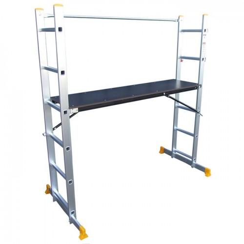

Temp Posted September 24, 2019 Share Posted September 24, 2019 I have some of those Draper Trestles for wood working. They are quite strong but personally I wouldn't use trestles and planks. Depending on the height I'd either go for something like an indoor grade tower or "scaffolding ladder platform" perhaps this sort of thing.. https://www.midlandladders.com/folding-work-platforms/ladder-scaffold-system Link to comment Share on other sites More sharing options...
Digmixfill Posted September 24, 2019 Author Share Posted September 24, 2019 I'm mortally afraid I will screw up and end up with un-straight walls. I check the face of every block. I place a level diagonally across the face and the previous rows. I don't put enough mortar down. I put too much mortar down. Same with the perps. I'm only doing a few hours a day block laying, so it will take me quite some time to gain the confidence and techniques of a professional. I will probably have it nailed shortly before I finish. Link to comment Share on other sites More sharing options...
Digmixfill Posted September 24, 2019 Author Share Posted September 24, 2019 5 minutes ago, Temp said: I have come across these type of things. They looked promising but I haven't spotted one that had a decent sized platform. Link to comment Share on other sites More sharing options...
