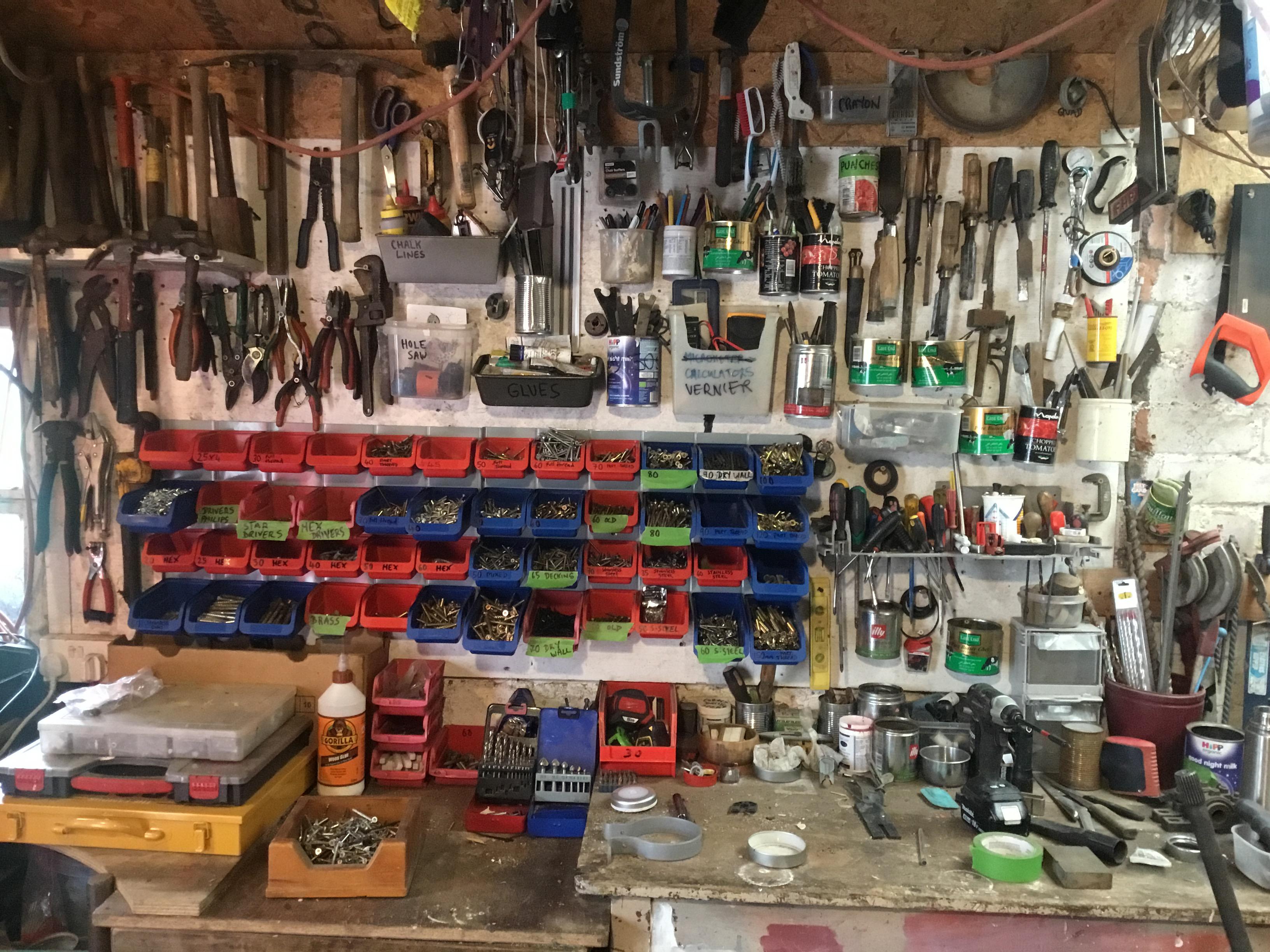

Carrerahill Posted February 26, 2021 Posted February 26, 2021 4 minutes ago, Cpd said: I converted to screws over nails 7 years ago and have never looked back, even if I’m building a shed or new roof I use screws as they are just so darn strong and if like me your a perfectionist then you have the option of redoing any joint that is not up to muster. Costs more but there is no way I would go back to nailing. I am just doing stuff on my own property so don’t have to worry about the extra cost this would add to a quote on a proper job. Storage is easy. In the process of making my tool wall and bench area up in my new garage! Some food for thought there (I love useable workshop and garage photos - always gives me inspiration).
Cpd Posted February 26, 2021 Posted February 26, 2021 My work bench is directly behind where this photo was taken, it’s an island that is bolted to the floor and had various vices and a pillar drill, if I need a tool I can just turn round and reach for it, I find having stuff on view and close to hand really helps me when undertaking tasks as I forget where stuff is if it’s all boxed away. I do ALL my own work on a rural property in the middle of nowhere so have to have an extraordinary amount of equipment, this is just one corner of a workshop related to the storage of screws......

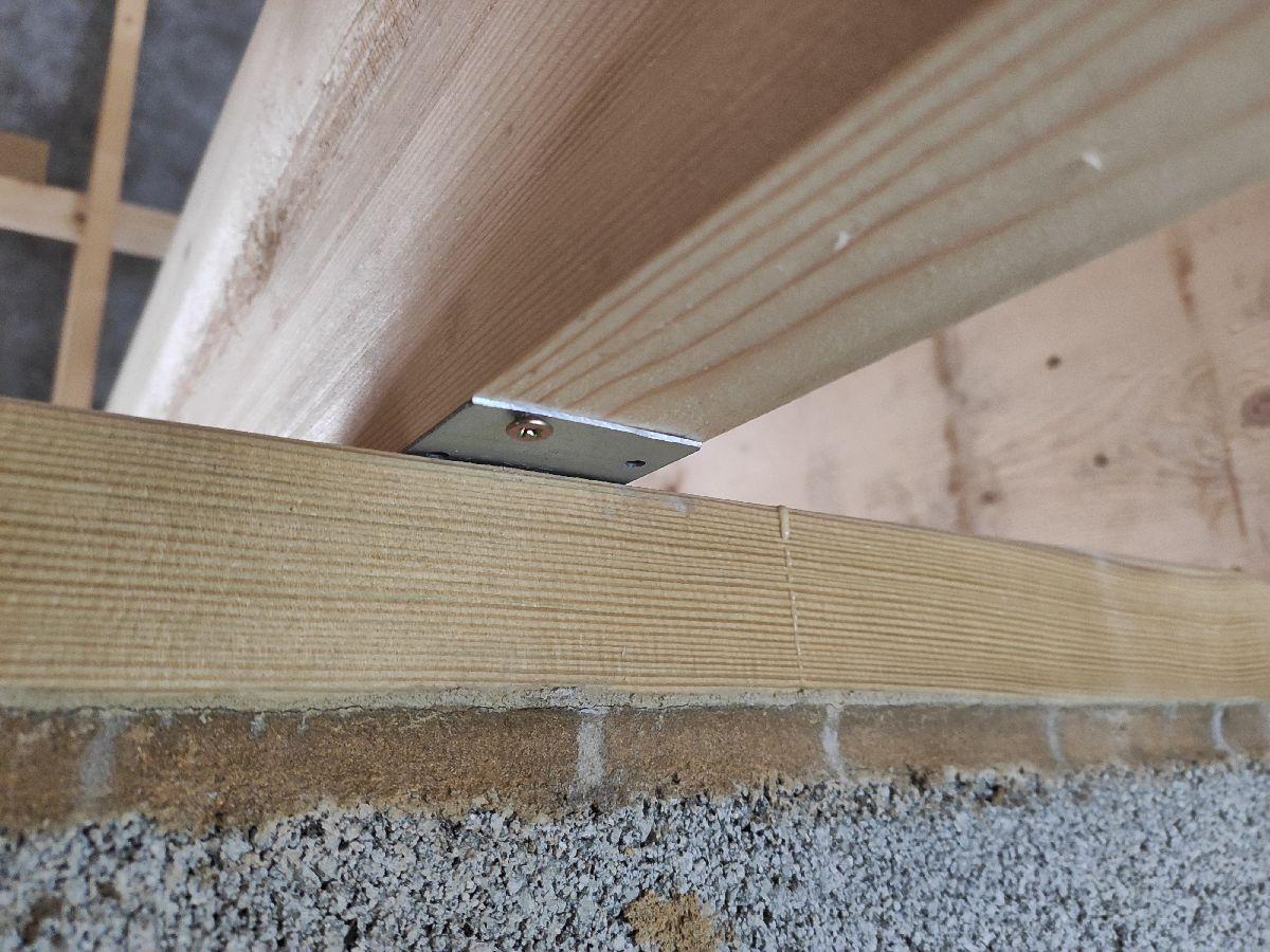

MortarThePoint Posted March 1, 2021 Posted March 1, 2021 I have a supporting wall close to midspan (62%) and all the trusses look to be resting on it well except for one. This one is about 1mm above and deflects down onto the wallplate if I hang my weight from it. In the photo I've slipped a piece of galvanised steel between the two. Is this a good idea or should I do something else?
