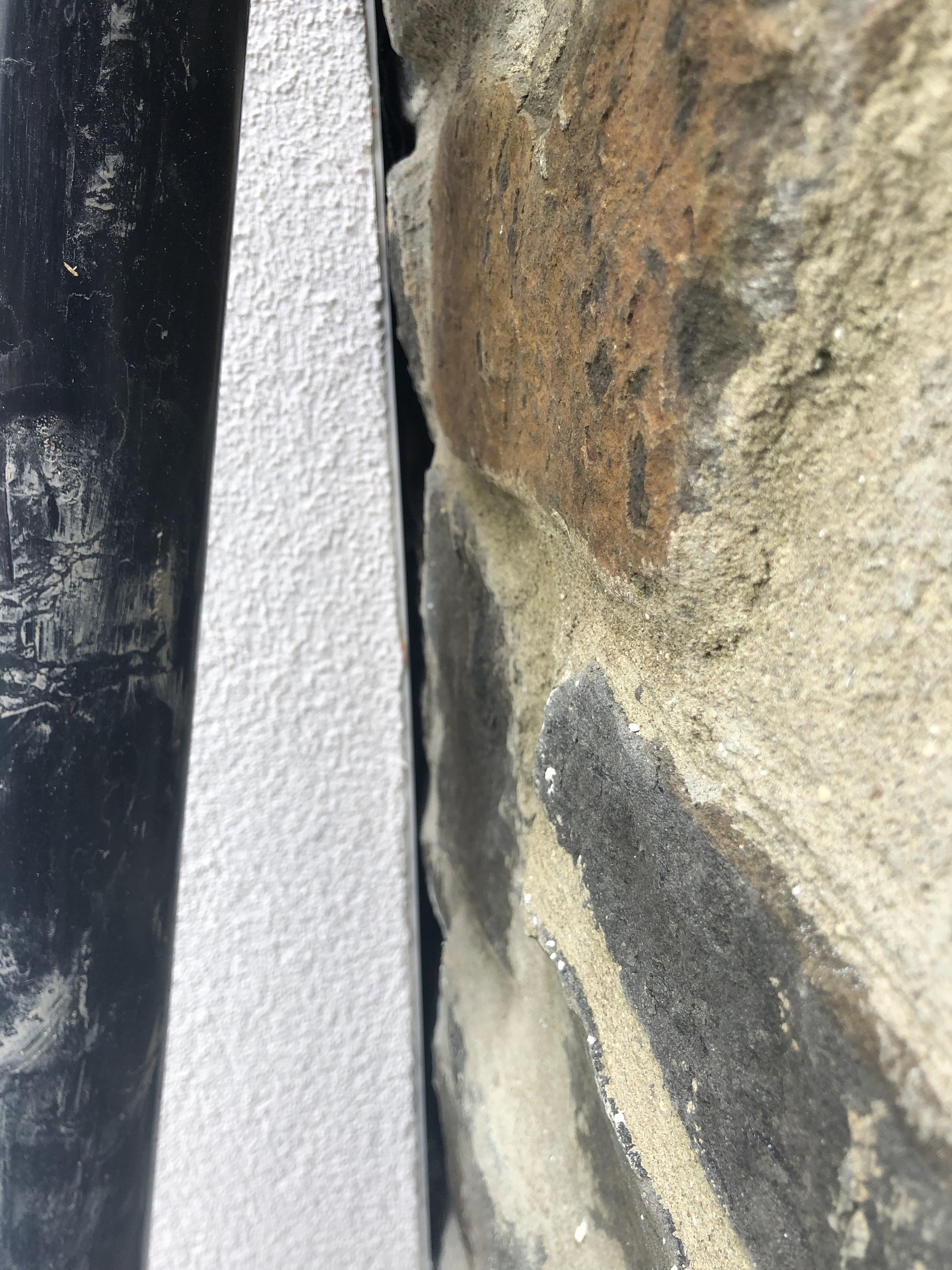

Pocster Posted September 11, 2019 Posted September 11, 2019 Hey all K rend done ; looks great ! Some gaps between random stone wall and build . Is this a job for white CT 1 ??? Or something else ?? cheers 2
PeterW Posted September 11, 2019 Posted September 11, 2019 Use clear CTI as the edge is nice and crisp. And white discolours.
Pocster Posted September 11, 2019 Author Posted September 11, 2019 17 minutes ago, PeterW said: Use clear CTI as the edge is nice and crisp. And white discolours. Thanks . So clear CT1 won’t discolour , mould , flake ?? In an external environment?
PeterW Posted September 11, 2019 Posted September 11, 2019 @Nickfromwales clear CT1 doesn’t change colour does it ..?? Other option is grey or black, both are suitable for outdoors.
Onoff Posted September 11, 2019 Posted September 11, 2019 20 minutes ago, pocster said: Thanks . So clear CT1 won’t discolour , mould , flake ?? In an external environment? Clear is fine. White CT1 goes "near custard yellow" to quote the Welsh Wizard. 1
bassanclan Posted September 11, 2019 Posted September 11, 2019 Clear CT1 does discolour. I don't know about outside, but in a bathroom I fitted 6 months ago it's gone yellow - even though it has some natural light. What about using the same mortar as the stone?
Onoff Posted September 11, 2019 Posted September 11, 2019 Kevin Cashin at C-Tec said something to me about white CT1 on the lines of it can be cleaned with a mild bleach solution I think to bring back the white.
Pocster Posted September 11, 2019 Author Posted September 11, 2019 19 minutes ago, Bitpipe said: Is there insect mesh at that interface? No . Essentially it’s the edge of the timber frame with insulation pir meeting the wall - foamed in the gaps . So this gap is just where the Renderer ended his bead .
Pocster Posted September 11, 2019 Author Posted September 11, 2019 24 minutes ago, bassanclan said: Clear CT1 does discolour. I don't know about outside, but in a bathroom I fitted 6 months ago it's gone yellow - even though it has some natural light. What about using the same mortar as the stone? Going to be awkward ! . Don’t want to get it on the nice render nor the stone . Suspect mortar that thin would crack and eventually fall out ...?!
Bitpipe Posted September 11, 2019 Posted September 11, 2019 I always meant to seal the gaps where my render met the soffits (which were installed after the render). Never got round to it and not sure there's a massive benefit other than aesthetics as there's insect screen top and bottom and I'd never get up to clean it. Bit of a shadow gap effect. Anyway, as my render is likely need removed and replaced, glad I didn't bother. So my choice would to leave it be and see how you live with it - nice home for the spiders... 1
bassanclan Posted September 11, 2019 Posted September 11, 2019 OK what about a white frame sealant such as around windows. The concern being it won't match the render or the stone 1

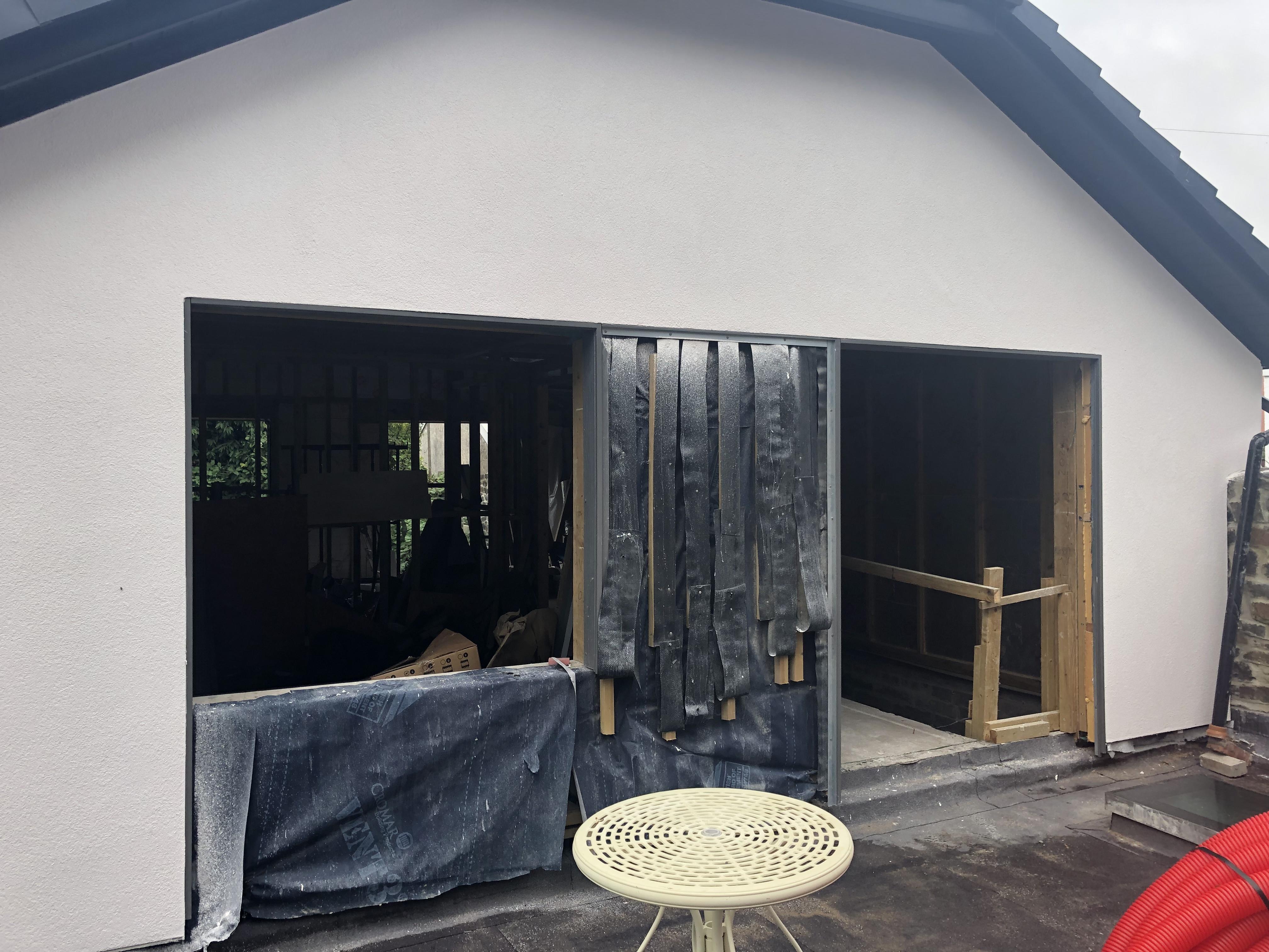

soapstar Posted September 11, 2019 Posted September 11, 2019 @pocster Looks nice, very similar to what I would like. Can you tell me what K-Rend product you used and colour? I get confused with all the different products they have! 1
Pocster Posted September 11, 2019 Author Posted September 11, 2019 6 minutes ago, soapstar said: @pocster Looks nice, very similar to what I would like. Can you tell me what K-Rend product you used and colour? I get confused with all the different products they have! Erm ! i get confused also ! The front as in the photo is a different k product to the sides . Sides were thermolite front was render board . Colour is limestone white . It’s almost like ‘pure’ white but a bit off . Renderer recommended the colour other than pure white because any ‘ageing’ will be less noticeable.

Cpd Posted September 11, 2019 Posted September 11, 2019 1 hour ago, nod said: I wouldn’t bother with silicone I normally tape the render with Jaffa taped and point with a motar gun Then flatten it down with a finger trowel + 1 this is what I would do
nod Posted September 11, 2019 Posted September 11, 2019 1 hour ago, Cpd said: + 1 this is what I would do It does look really slick against the render mans now with the roughneck type guns it’s so Quick
