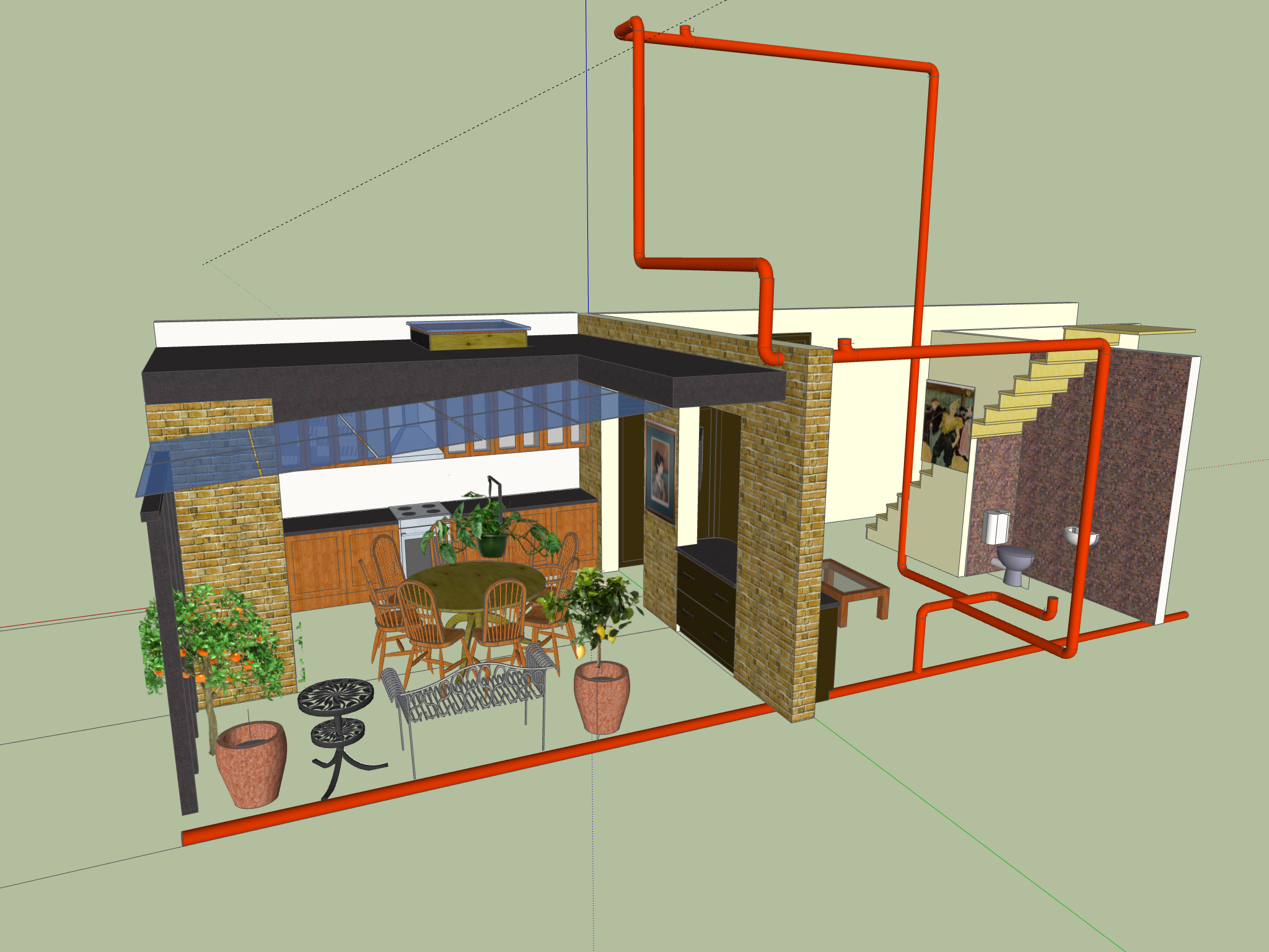

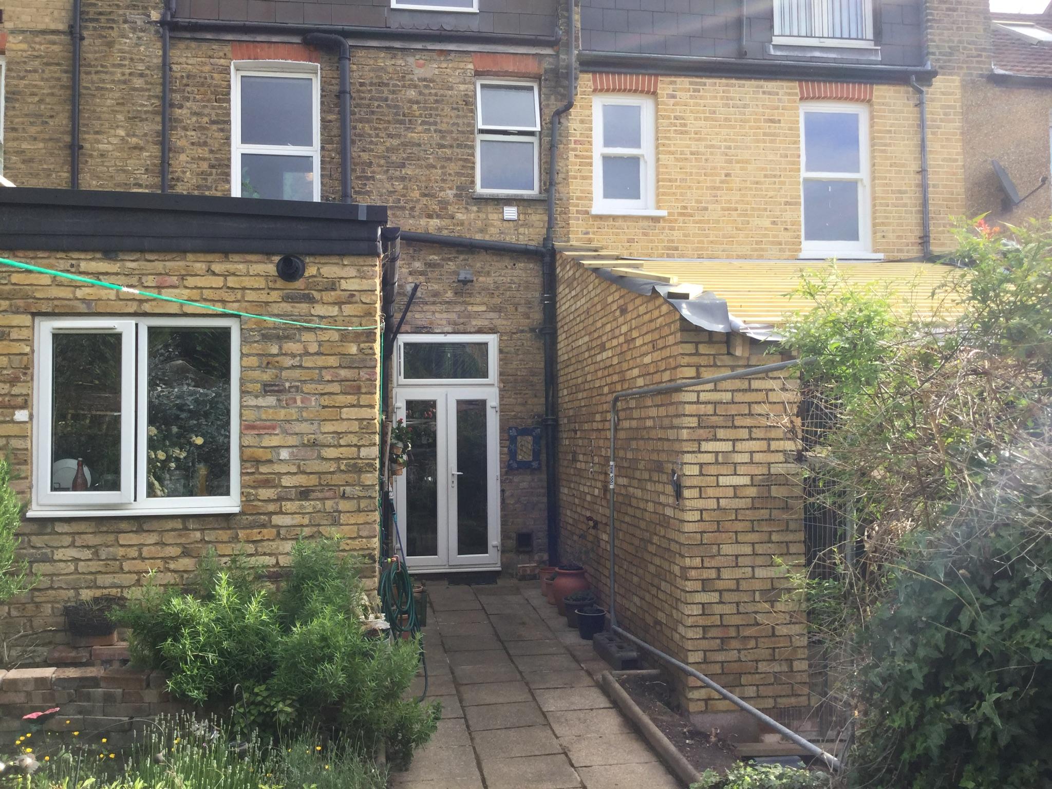

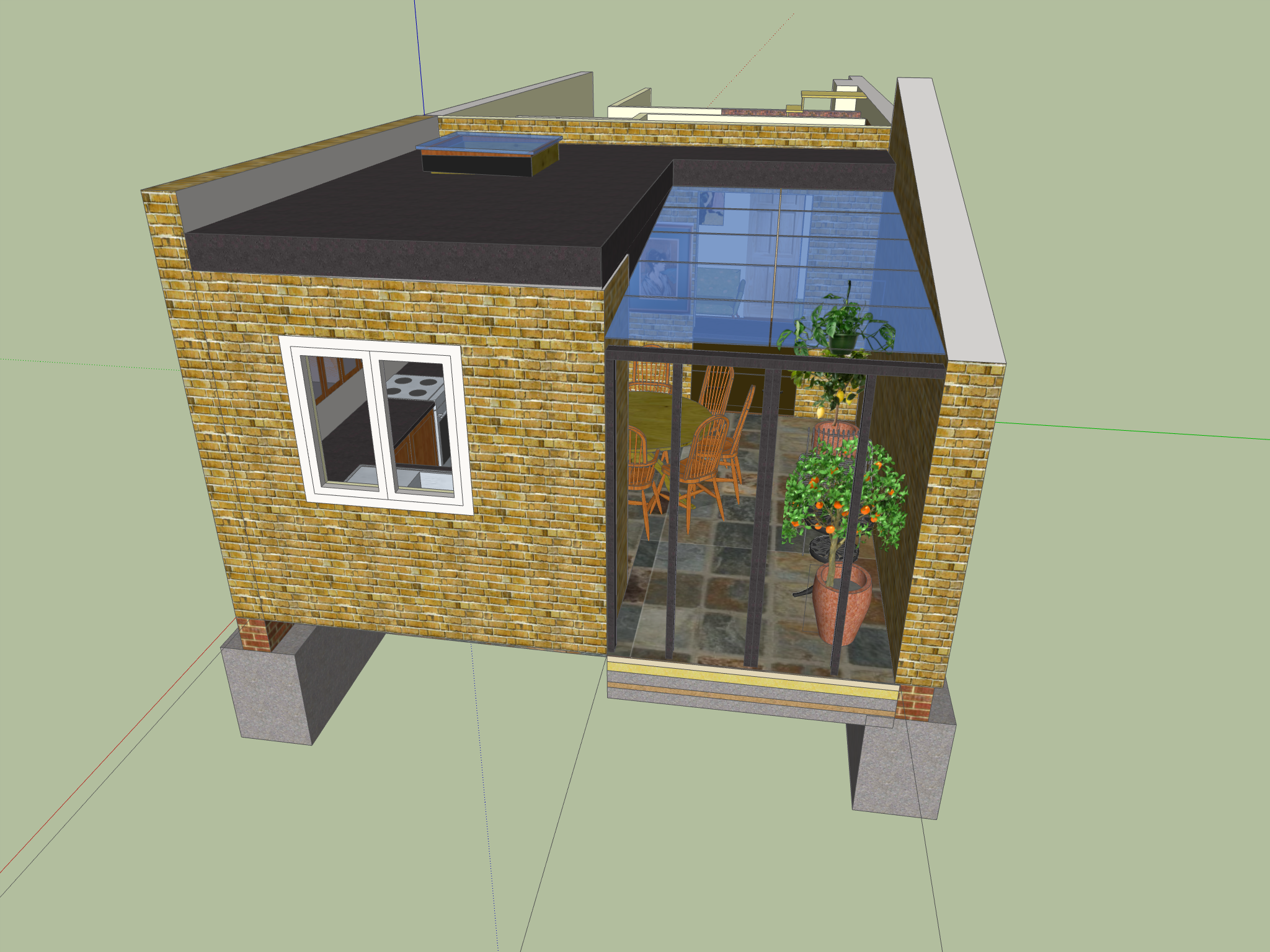

Adam Smith Posted September 11, 2019 Posted September 11, 2019 I have a Victorian terraced house in London W4 and I want to fill in the L shape of the ground floor so as to create an extension/conservatory. I want to emphasise the conservatory aspect so that I don’t have to apply for planning permission and building control, but I want to have a good, solid floor with insulation and under floor heating. The area to be filled in is 5 m long by 2 m wide with solid foundations to either side. The ground is 250 mm below the floor level inside the house. At the moment there is an inspection chamber for the drain, but I want to get rid of this and have a rodding eye outside the new conservatory. I would like to be able to do it all myself. What is the cheapest, least hassle way of doing it? Thanks.
ProDave Posted September 11, 2019 Posted September 11, 2019 First, have you talked to your neighbour about joining onto his new wall? His extension looks to be still under construction. Is that wall built on the party line, or set back his side of it so as to be entirely inside his boundarry?

Adam Smith Posted September 11, 2019 Author Posted September 11, 2019 1 hour ago, ProDave said: First, have you talked to your neighbour about joining onto his new wall? His extension looks to be still under construction. Is that wall built on the party line, or set back his side of it so as to be entirely inside his boundarry? The wall is on the Boundry and it is agreed that either side can share it.

Ferdinand Posted September 11, 2019 Posted September 11, 2019 (edited) I think you need PP anyway, as you are within 2m of a boundary. And I don't think it will be a "conservatory": "In the UK the legal definition of a conservatory is that it is a building with at least 50% side walls and 75% roof area with translucent glass or polycarbonate glazing" https://www.eygwindows.co.uk/lifestyle-blog/do-you-need-planning-permission-for-a-conservatory You are already under 50%, unless you make a glass wall facing his bricks. Sorry to post that. Given PP requirement, I think I would be looking at a real roof spanning from your existing wall to the neighbour (and coming to an agreement whilst his roof is still in bits, with you giving him a small benefit - once it is finished it will be much more difficult), then considering how to link to the existing, A full width room, or with perforations in the existing wall, will be much more attractive, and - given Chiswick (I lived in Grove Park for a couple of years) - you should get it back on the value. Things that matter are light to your middle room, and maintainability of whatever your build, and new drains and waterhandling (and maintenance thereof). It will be easy to create a nightmare. One thing you have not said is whether you want something warm or cool. If it looks like a conservatory you will not get the benefit on valuations. F Edited September 11, 2019 by Ferdinand
Russell griffiths Posted September 11, 2019 Posted September 11, 2019 Do you have a picture of the drain with the lid off, it could be more involved than you think to move it, depends what is connecting to it. Why not not bring your front wall over to meet the new wall, and remove the old side wall of your kitchen and make it all one room. What sort of budget do you have.
Adam Smith Posted September 11, 2019 Author Posted September 11, 2019 12 minutes ago, Ferdinand said: I think you need PP anyway, as you are within 2m of a boundary. And I don't think it will be a "conservatory": "In the UK the legal definition of a conservatory is that it is a building with at least 50% side walls and 75% roof area with translucent glass or polycarbonate glazing" https://www.eygwindows.co.uk/lifestyle-blog/do-you-need-planning-permission-for-a-conservatory You are already under 50%, unless you male a glass wall facing his bricks. Sorry to post that. Given PP requirement, I think I would be looking at a real roof spanning from your existing wall to the neighbour (and coming to an agreement whilst his roof is still in bits, with you giving him a small benefit - once it is finished it will be much more difficult), then considering how to link to the existing, Things that matter are light to your middle room, and maintainability of whatever your build, and new drains and waterhandling (and maintenance thereof). It will be easy to create a nightmare. One thing you have not said is whether you want something warm or cool. If it looks like a conservatory you will not get the benefit on valuations. F Light in the middle room is not a problem. Here is what I plan.
PeterW Posted September 11, 2019 Posted September 11, 2019 Ok so that may well meet the definition of a conservatory as I’m pretty sure the “wall” element when it’s referred to is that as built, not necessarily the supporting walls. I’m sure this is the case as a corner conservatory by definition only has 50-60% glazing at best in its walls. @Adam Smith I hope you have deep pockets as that looks like very expensive structural glazing ...
Adam Smith Posted September 11, 2019 Author Posted September 11, 2019 6 minutes ago, Russell griffiths said: Do you have a picture of the drain with the lid off, it could be more involved than you think to move it, depends what is connecting to it. Why not not bring your front wall over to meet the new wall, and remove the old side wall of your kitchen and make it all one room. What sort of budget do you have. I can’t imagine why moving the drain would be difficult. The lid is in front of the French doors. The stack coming down in the corner goes into the drain and it is also fed by the kitchen sink, which is behind the window to the left. I plan to move the stack in doors, like the houses to the left and right. The drain goes straight out to the front of the house. I have already driven a connection down through the middle of the house – where we have a toilet.
Ferdinand Posted September 11, 2019 Posted September 11, 2019 (edited) 15 minutes ago, Adam Smith said: I can’t imagine why moving the drain would be difficult. The lid is in front of the French doors. The stack coming down in the corner goes into the drain and it is also fed by the kitchen sink, which is behind the window to the left. I plan to move the stack in doors, like the houses to the left and right. The drain goes straight out to the front of the house. I have already driven a connection down through the middle of the house – where we have a toilet. I would not suggest that it is difficult, but that it is very painful (potentially) if you get it wrong. My conservatory is similar in some ways (I left a narrow maintenance alley down the rhs, and it has a lot of roof draining towards it), and I have some problems that are currently being addressed. And I see you are taking your dividing wall out. F Edited September 11, 2019 by Ferdinand
Mr Punter Posted September 11, 2019 Posted September 11, 2019 Planning consent should not be an issue because of PD rights (unless they have been removed or are restricted), but to be outside of building regs it needs wall / doors between it and the kitchen, which you don't have and over a metre from the boundary, which it is not. This is an extension and you will need to comply with all the regs. Most onerous may be part L because you have a lot of glazing in relation to floor area. This will mean the glazing would need to be extra energy efficient and you will need some calcs to prove the heat losses are not excessive and possibly make improvements elsewhere to offset. Regarding the floor, this will also need to comply and since it is now part of the kitchen it will be important that there is no settlement between them.
ProDave Posted September 11, 2019 Posted September 11, 2019 I see the drains as the biggest issue here. If as you say your mains drains run out to the front, then your target is to convert ALL your drains to internal stacks running under the (presumably) suspended ground floor out to the front, to clear that back wall of drain pipes and make the inspection chamber redundant. You will need a rodding eye for the drain run out to the front but that might be able to extend rearwards beyond the conservatory. The drain coming down from the loft looks the hardest to deal with.

Adam Smith Posted September 11, 2019 Author Posted September 11, 2019 20 minutes ago, ProDave said: I see the drains as the biggest issue here. If as you say your mains drains run out to the front, then your target is to convert ALL your drains to internal stacks running under the (presumably) suspended ground floor out to the front, to clear that back wall of drain pipes and make the inspection chamber redundant. You will need a rodding eye for the drain run out to the front but that might be able to extend rearwards beyond the conservatory. The drain coming down from the loft looks the hardest to deal with. You’re right – the toilet in the loft is the biggest problem to deal with – but I’m having good ideas all the time. I imagined an intermediary stage in which I would take the drain from the loft down to join up with the toilet on the first floor, which would drain internally. It might be possible, as I’ve shown in the drawing here, to take the drain from the loft toilet to the middle of the house and bring it down by the stairs – I’m still thinking about it.

ProDave Posted September 11, 2019 Posted September 11, 2019 I think it is a mistake to make this bit as a conservatory AND take down the kitchen wall. To do so would lead to massive heat loss through the inferior conservatory wall and roof structure. Either make is as a conservatory as a separate room that can be shut off when it is too cold, or make it as a proper extension with a proper insulated roof and walls, with it opened up to the kitchen.
Adam Smith Posted September 11, 2019 Author Posted September 11, 2019 3 minutes ago, SteamyTea said: Under floor heating Thanks, I guessed as soon as I pressed the send button.
Adam Smith Posted September 11, 2019 Author Posted September 11, 2019 25 minutes ago, ProDave said: I think it is a mistake to make this bit as a conservatory AND take down the kitchen wall. To do so would lead to massive heat loss through the inferior conservatory wall and roof structure. Either make is as a conservatory as a separate room that can be shut off when it is too cold, or make it as a proper extension with a proper insulated roof and walls, with it opened up to the kitchen. Okay - Double glazing with low emissivity glass (with argon gas cavity) U value = 1.5?? w/m2K. Total area of glass on the roof and front two doors – 12 m². Assume the heat loss to the sides and floor is negligible. Assume a 20° C differential on a cold day. Total heat loss is 1.5 X 12 X 20 = 360W. You could do that with quite a small radiator. Wickes quotes a 1200 mm x 600 mm radiator as 2332 W. At 15p per kilowatt hour my glass would add about 5p per kilowatt hour to run in the worst of weather - £1 per day.
SteamyTea Posted September 11, 2019 Posted September 11, 2019 5 minutes ago, Adam Smith said: U value = 1.5?? w/m2K That is just the steady state value. There are surface affects that will increase the losses. I think they are in the Building Regs. 30 minutes ago, Adam Smith said: I guessed as soon as I pressed the send button. That is exactly the time I see spelling and grammar errors.
