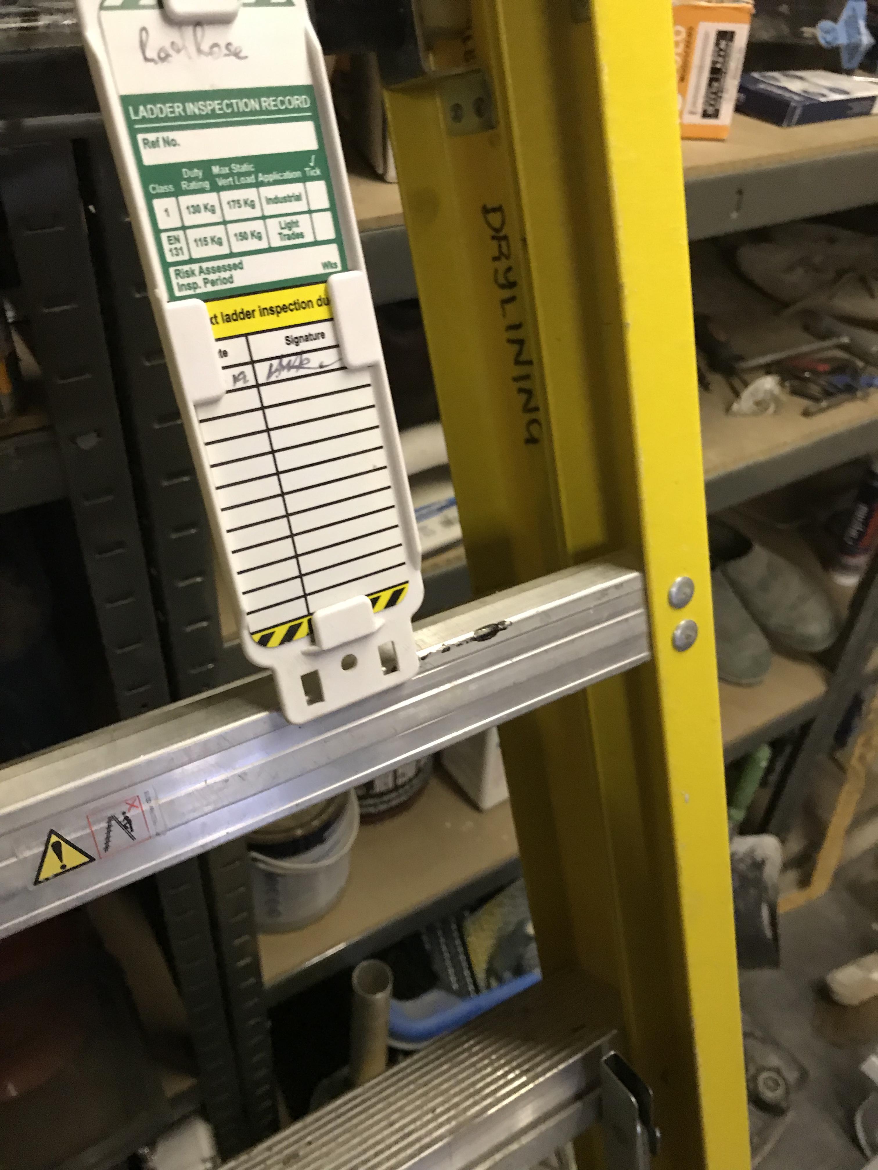

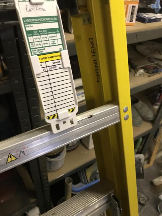

nod Posted September 4, 2019 Share Posted September 4, 2019 As Dave has pointed out If you are off the beaten track your fine We are on the main road and had two HSS visits Just walked on The first time they asked for a scaf cert When told them it was a friends company that had erected it They told me there should be a sign HSS came back the following day with the scaffolding company boss and had a walk through As a rendering company we would always alter bits that are in the way Now most sites tell us that if we are caught with a scaffold spanner We will be asked to leave I hired mainly due to insurance issues If there was an accident I’m sure they would expect your scaffolding to have a certificate Onsite even ally tiers and Step ladders when allowed have to have a weekly certificate Link to comment Share on other sites More sharing options...

nod Posted September 5, 2019 Share Posted September 5, 2019 As Dave has pointed out If you are off the beaten track your fine We are on the main road and had two HSS visits Just walked on The first time they asked for a scaf cert When told them it was a friends company that had erected it They told me there should be a sign HSS came back the following day with the scaffolding company boss and had a walk through As a rendering company we would always alter bits that are in the way Now most sites tell us that if we are caught with a scaffold spanner We will be asked to leave I hired mainly due to insurance issues If there was an accident I’m sure they would expect your scaffolding to have a certificate Onsite even ally tiers and Step ladders when allowed have to have a weekly certificate Who would have thought we would ever need weekly scaf tags on step ladders Link to comment Share on other sites More sharing options...
