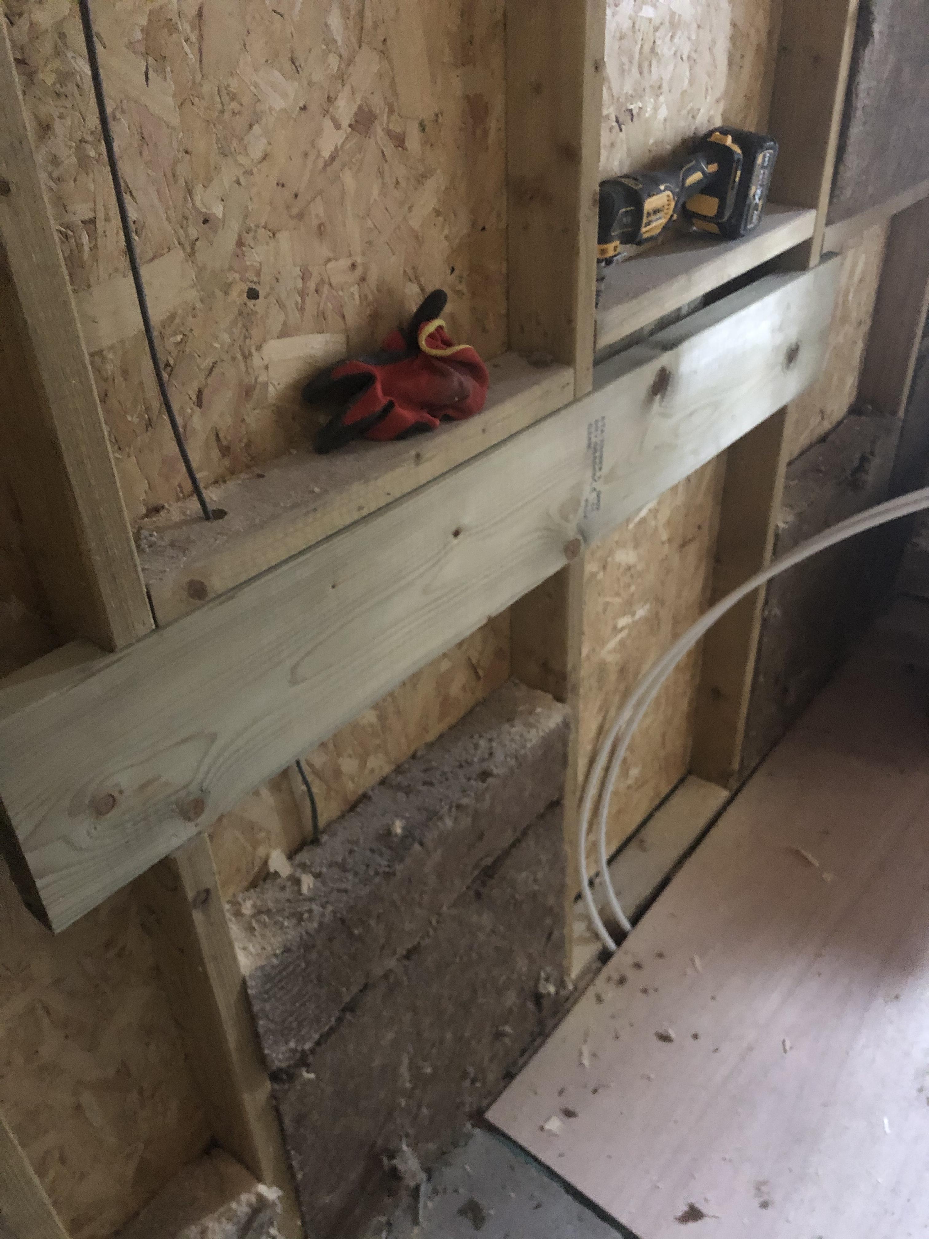

Pocster Posted February 28, 2020 Author Share Posted February 28, 2020 Thickened up the ensuite wall to allow for 80cm depth geberit in wall cistern . Undoubtedly using far too much timber and screws - but it won’t move !! Link to comment Share on other sites More sharing options...

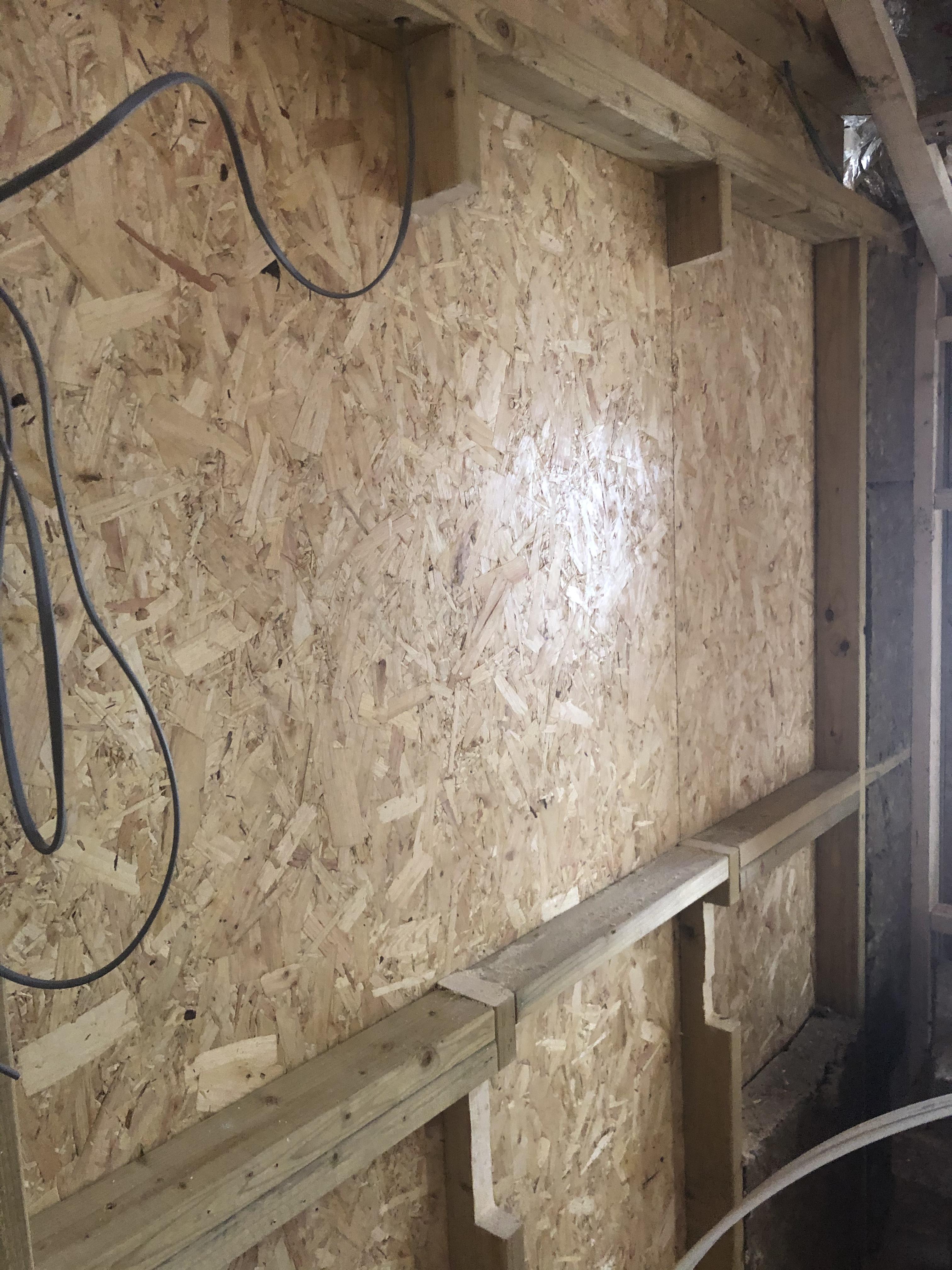

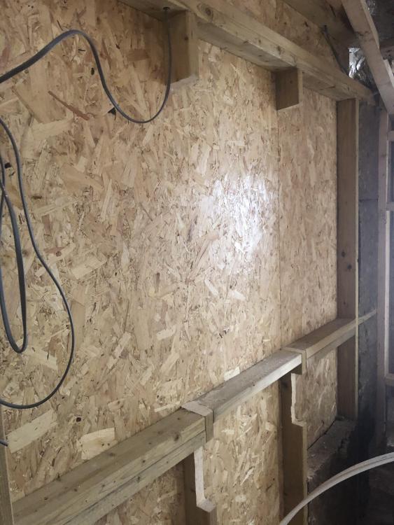

Pocster Posted March 3, 2020 Author Share Posted March 3, 2020 Sink support ( not fixed yet ! ) in place . Now have to cut out above that for recessed mirror ... Link to comment Share on other sites More sharing options...
Pocster Posted March 3, 2020 Author Share Posted March 3, 2020 Space cut for mega mirror ! Link to comment Share on other sites More sharing options...

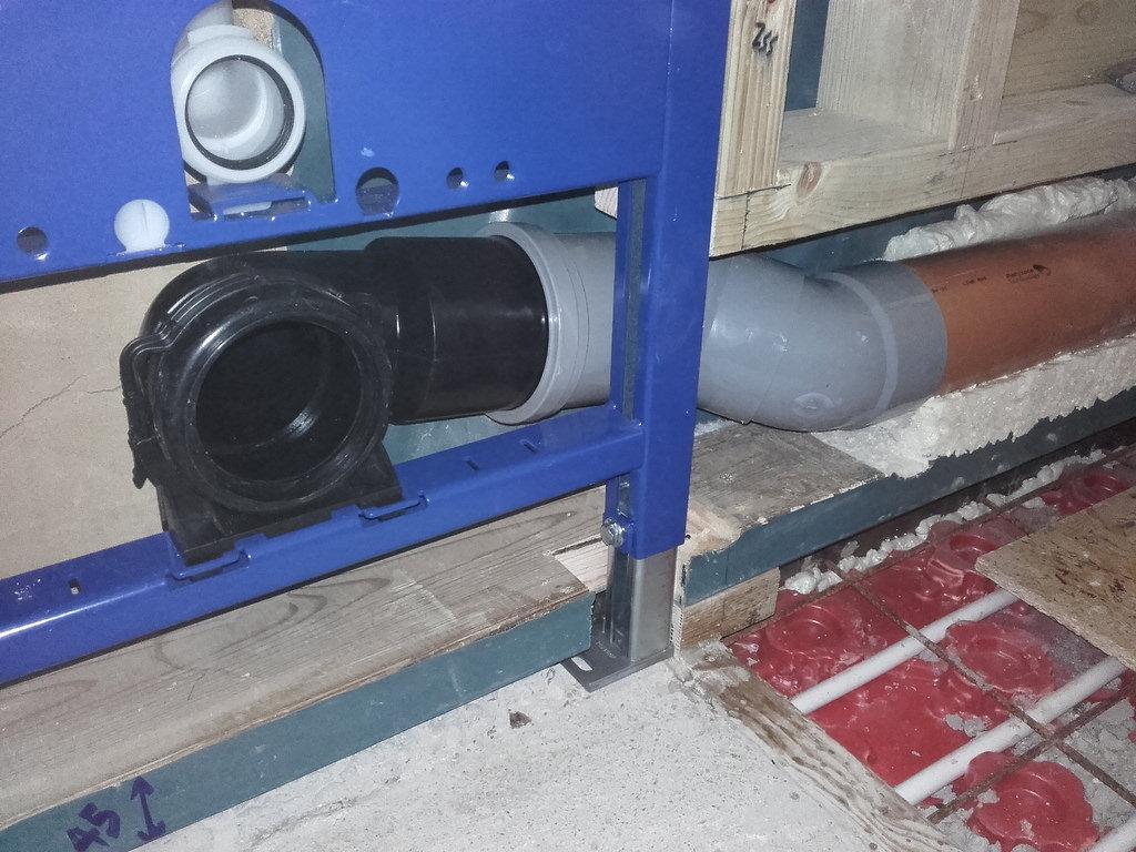

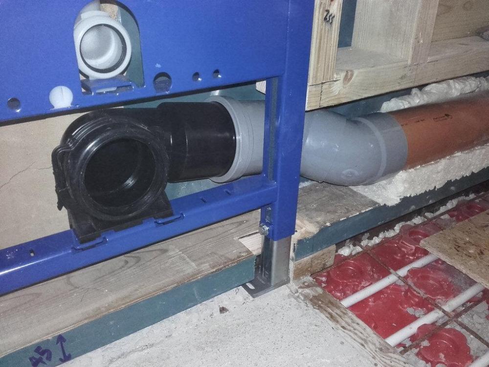

Pocster Posted March 9, 2020 Author Share Posted March 9, 2020 On 25/02/2020 at 14:30, Onoff said: Erm... that black elbow isn't glueable type pvc (I don't think). It's HDPE. The elbow goes into an adapter that comes with the Geberit then that push fits into a 110mm female. The 3 black fittings are all Geberit: So in my ceiling I’ll have push fit ? ? I really want solvent weld all the way I.e after the pan 90 tee . If I get one of those geberit extenders you linked to I’ll still need push fit at the end which is bad Link to comment Share on other sites More sharing options...
Onoff Posted March 9, 2020 Share Posted March 9, 2020 10 minutes ago, pocster said: So in my ceiling I’ll have push fit ? ? I really want solvent weld all the way I.e after the pan 90 tee . If I get one of those geberit extenders you linked to I’ll still need push fit at the end which is bad It's all male into female going downhill so even if the push fit seal failed it'd all have to back up seriously to leak at the Geberit to "other" push fit joint. There's TAP Poly Weld 2-part epoxy that is supposed to stick HDPE to PVC. Tbh I think I'd just push the Geberit in then CT1 around the whole joint after cleaning it if that worried. 1 Link to comment Share on other sites More sharing options...
Pocster Posted March 9, 2020 Author Share Posted March 9, 2020 53 minutes ago, Onoff said: It's all male into female going downhill so even if the push fit seal failed it'd all have to back up seriously to leak at the Geberit to "other" push fit joint. There's TAP Poly Weld 2-part epoxy that is supposed to stick HDPE to PVC. Tbh I think I'd just push the Geberit in then CT1 around the whole joint after cleaning it if that worried. Yeah I did think that also i.e. downhill away from the push joint, but you know. When I post 5 years from now about this brown stain on my ceiling......? 1 Link to comment Share on other sites More sharing options...
Pocster Posted March 9, 2020 Author Share Posted March 9, 2020 5 minutes ago, pocster said: Yeah I did think that also i.e. downhill away from the push joint, but you know. When I post 5 years from now about this brown stain on my ceiling......? 1 hour ago, Onoff said: It's all male into female going downhill so even if the push fit seal failed it'd all have to back up seriously to leak at the Geberit to "other" push fit joint. There's TAP Poly Weld 2-part epoxy that is supposed to stick HDPE to PVC. Tbh I think I'd just push the Geberit in then CT1 around the whole joint after cleaning it if that worried. Hmmm, sounds like a problem for another day. I'll email Geberit - they do seem to do weld stuff - so hopefully they have a magic coupler that takes push fit to weld. I'll report back with what they say ; assuming they reply.... Link to comment Share on other sites More sharing options...
Pocster Posted March 9, 2020 Author Share Posted March 9, 2020 (edited) Actually do I HAVE to use any of the Geberit supplied pipework?? - can I not just get weldable in the same size? ( assuming geberit is a 'standard' size )? Or is that initial 90 degree tee a Geberit special fitting..... Edited March 9, 2020 by pocster Link to comment Share on other sites More sharing options...
Pocster Posted March 9, 2020 Author Share Posted March 9, 2020 Hmmmm Hunting - I find this @Nickfromwales suggests the 90/110 reducer ( surely that’s an enlarger ) push fits straight into the 110 soil . Still means I’d have a push fit in my vertical rather than a weld .... Link to comment Share on other sites More sharing options...
Onoff Posted March 9, 2020 Share Posted March 9, 2020 7 minutes ago, pocster said: Hmmmm Hunting - I find this @Nickfromwales suggests the 90/110 reducer ( surely that’s an enlarger ) push fits straight into the 110 soil . Still means I’d have a push fit in my vertical rather than a weld .... The "reducer" Nick suggested is the same bit I showed but it's really an adapter. 90mm Geberit male goes into the 90mm female on the adapter. 110mm male on the adapter push fits into a 110mm female. Link to comment Share on other sites More sharing options...
Pocster Posted March 9, 2020 Author Share Posted March 9, 2020 (edited) 8 minutes ago, Onoff said: The "reducer" Nick suggested is the same bit I showed but it's really an adapter. 90mm Geberit male goes into the 90mm female on the adapter. 110mm male on the adapter push fits into a 110mm female. You are right ! Doesn’t solve my problem does it - as I still need to get to solvent weld Edited March 9, 2020 by pocster Link to comment Share on other sites More sharing options...
Pocster Posted March 9, 2020 Author Share Posted March 9, 2020 @Onoff what did you do here ? You seem to connect into the brown 110 soil - that grey pipe not a push fit onto it is it ?? Link to comment Share on other sites More sharing options...
Onoff Posted March 9, 2020 Share Posted March 9, 2020 11 minutes ago, pocster said: @Onoff what did you do here ? You seem to connect into the brown 110 soil - that grey pipe not a push fit onto it is it ?? Grey is solvent weld female. Brown is 110mm pvc soil. I made a cock up there. Should have used black or grey solvent weld 110mm. The brown is the underground stuff and although still pvc, seems a bit more rubbery/resilient as opposed to the slight brittleness you seem to feel with true solvent weld pipes/fittings. Different makes too. I used solvent, gap filling cement. Link to comment Share on other sites More sharing options...
Pocster Posted March 9, 2020 Author Share Posted March 9, 2020 (edited) 4 minutes ago, Onoff said: Grey is solvent weld female. Brown is 110mm pvc soil. I made a cock up there. Should have used black or grey solvent weld 110mm. The brown is the underground stuff and although still pvc, seems a bit more rubbery/resilient as opposed to the slight brittleness you seem to feel with true solvent weld pipes/fittings. Different makes too. I used solvent, gap filling cement. So ! I could take the geberit fitting into a similar grey fitting you have and solvent weld that end to my black 110 soil?? The geberit you show ; just pushed into the grey ?? Must have rubber ring or something surely? Edited March 9, 2020 by pocster Link to comment Share on other sites More sharing options...

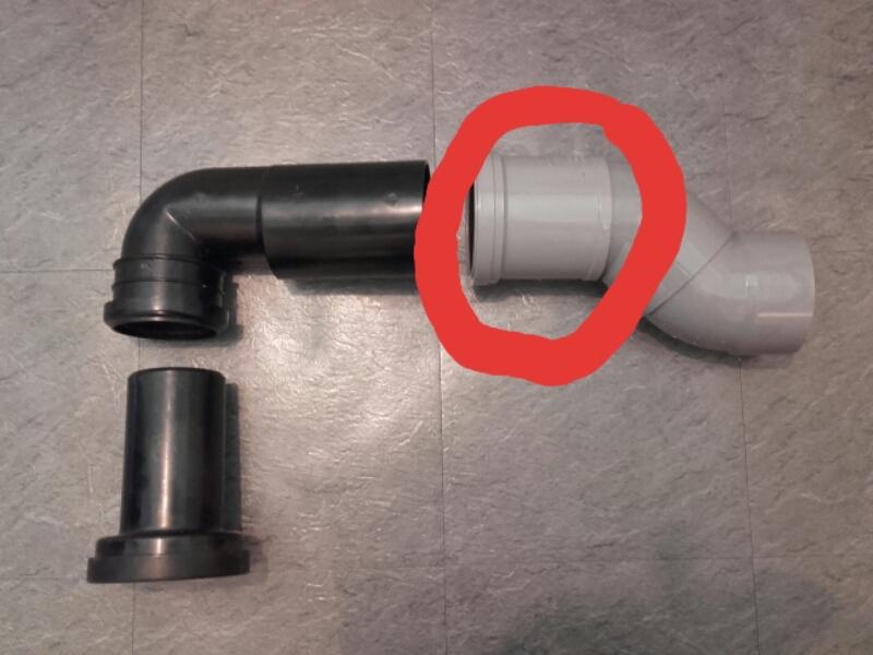

Onoff Posted March 9, 2020 Share Posted March 9, 2020 10 minutes ago, pocster said: So ! I could take the geberit fitting into a similar grey fitting you have and solvent weld that end to my black 110 soil?? The geberit you show ; just pushed into the grey ?? Must have rubber ring or something surely? The pan connector is Geberit. The elbow I got from @PeterStarck Push fit into the grey via rubber seal. The grey, short, straight is push fit male, solvent female. Then a couple of grey m/f solvent weld fittings. Brown soil into the rhs with gap filling cement. Link to comment Share on other sites More sharing options...
Pocster Posted March 9, 2020 Author Share Posted March 9, 2020 Just now, Onoff said: The pan connector is Geberit. The elbow I got from @PeterStarck Push fit into the grey via rubber seal. The grey, short, straight is push fit male, solvent female. Then a couple of grey m/f solvent weld fittings. Brown soil into the rhs with gap filling cement. Ooooooo push fit one end solvent the other That’s what I need ! But a straight one . Link to comment Share on other sites More sharing options...
Onoff Posted March 9, 2020 Share Posted March 9, 2020 23 minutes ago, pocster said: Ooooooo push fit one end solvent the other That’s what I need ! But a straight one . It is a straight one! This I think: https://www.ebay.co.uk/itm/Polypipe-110mm-Grey-sh43g-single-socket-coupler-adaptor-solvent-push-weld-fit/174180814011? 1 Link to comment Share on other sites More sharing options...
Pocster Posted March 10, 2020 Author Share Posted March 10, 2020 11 hours ago, Onoff said: It is a straight one! This I think: https://www.ebay.co.uk/itm/Polypipe-110mm-Grey-sh43g-single-socket-coupler-adaptor-solvent-push-weld-fit/174180814011? Now I looked online for a push fit to solvent weld converter and couldn’t find anything Link to comment Share on other sites More sharing options...
Pocster Posted March 10, 2020 Author Share Posted March 10, 2020 It’s been suggested ... I would possibly suggest discarding that pan connector/bend and buying a new pan connector either straight and a bend or possibly flexible and coming away from that in solvent soil so it’s all the same . https://www.jtmplumbing.co.uk/pipe-fittings-c433/toilet-pan-connectors-c187/viva-straight-wc-pan-connector-4-110mm-p4704 https://www.jtmplumbing.co.uk/pipe-fittings-c433/toilet-pan-connectors-c187/viva-long-flexible-pan-connector-300-700mm-p6980 Link to comment Share on other sites More sharing options...
Onoff Posted March 10, 2020 Share Posted March 10, 2020 Will those non Geberit pan connectors clip into the Geberit frame still? You want to ensure the flush to poo pipe centres. You'll still have a flanged rubber push fit connection hidden behind the tiles. I'd say the Geberit rubber seals are far superior to that flanged sort. Maybe one of these solvent weld will float your weird boat: https://www.ebay.co.uk/i/223472460110? or https://www.polypipe.com/pan-connector-110mm-90-s-socket-solvent-weld-white 1 Link to comment Share on other sites More sharing options...
Pocster Posted March 10, 2020 Author Share Posted March 10, 2020 8 minutes ago, Onoff said: Will those non Geberit pan connectors clip into the Geberit frame still? You want to ensure the flush to poo pipe centres. You'll still have a flanged rubber push fit connection hidden behind the tiles. I'd say the Geberit rubber seals are far superior to that flanged sort. Maybe one of these solvent weld will float your weird boat: https://www.ebay.co.uk/i/223472460110? or https://www.polypipe.com/pan-connector-110mm-90-s-socket-solvent-weld-white Yeah that was my concern - rather use the geberit supplied fitting initially . Ordered that coupler you linked to earlier - give that a try first . Link to comment Share on other sites More sharing options...
