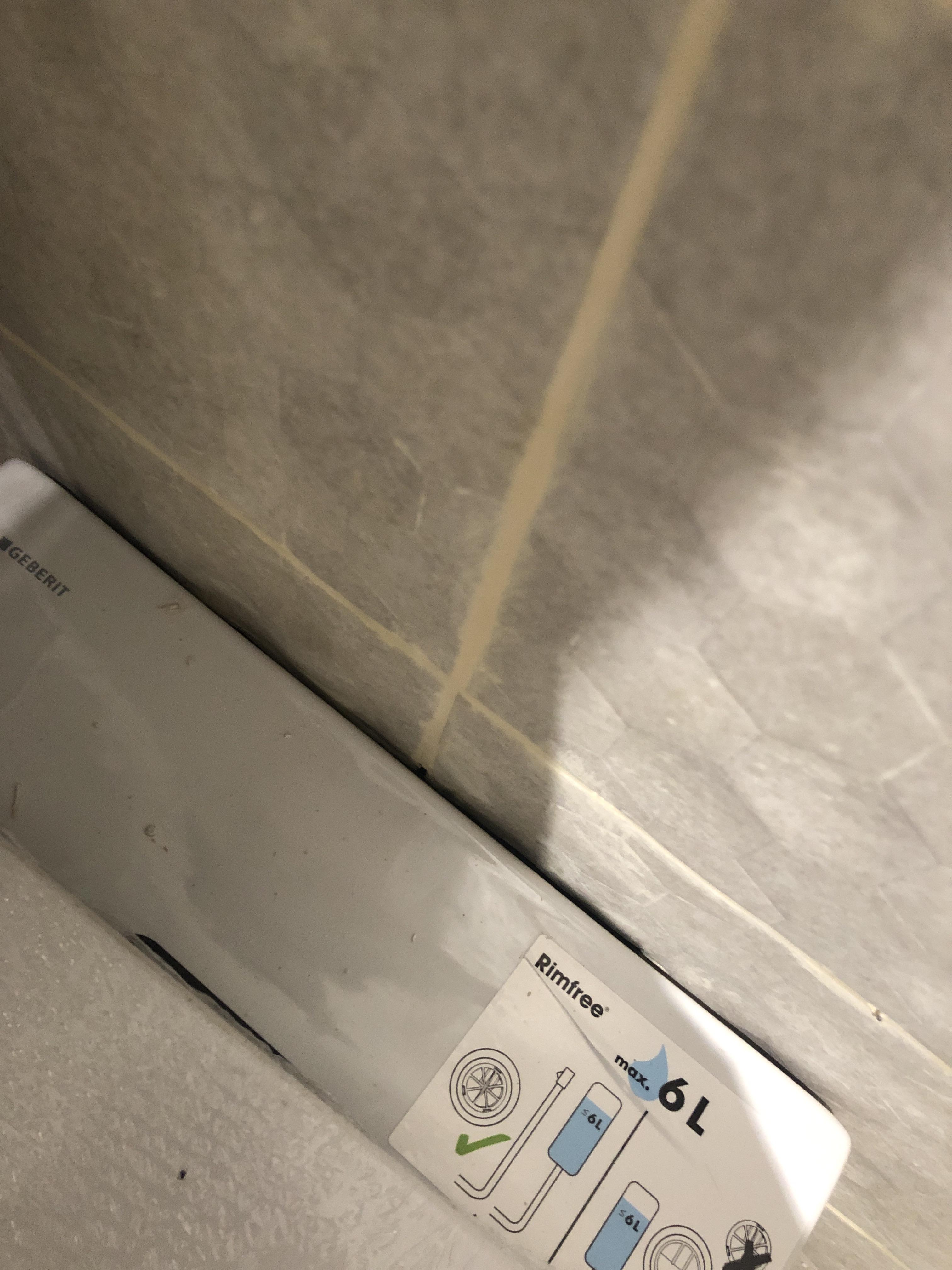

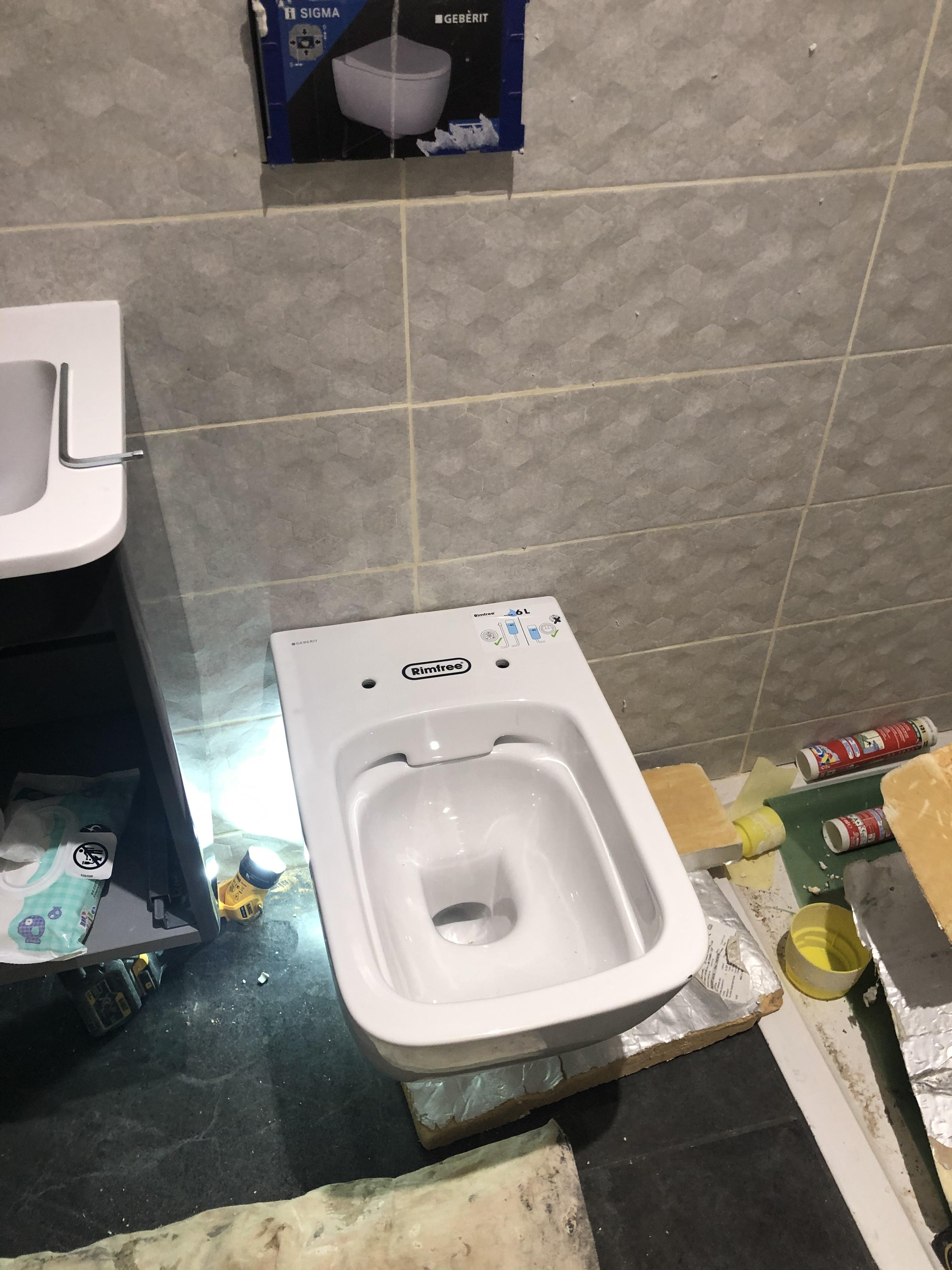

Pocster Posted January 21, 2021 Author Posted January 21, 2021 Fighting wc . It’s on dry ( no silicone ) If I grab the front though it ‘moves’ up a fraction . The only wall fixings are those 2 high bolts so nothing to stop the bottom lifting - this correct ? Going to tip water down the pan as test 1 Then flush it for test 2 In theory ( as I’m less than confident ) I should be able to sit on this now ? Take my feet off the floor and it takes my weight ?? ( the ultimate test !! )
joe90 Posted January 21, 2021 Posted January 21, 2021 Brave boy! I don’t like the idea of wall hung (in theory), regarding “lift up” I guess ct1 as a gasket on the back before it’s bolted to the wall would take up any slack? 1
Pocster Posted January 21, 2021 Author Posted January 21, 2021 Both tests successful! zero leaks . I stuck a bit of tissue in it . Set my camera to video hanging over the edge of the manhole . Flushed it . How sad eh ? . Where else would the (expletive deleted)ing water go ? All good ! . Would like to weight test it for my peace of mind but will wait until other ‘wall hangers’ say it’s ok .... too scared !! 1
Pocster Posted January 21, 2021 Author Posted January 21, 2021 @Onoff or any ‘ wall hangers ‘ this safe to weight test in this state ???
Pocster Posted January 21, 2021 Author Posted January 21, 2021 Too slow everyone ! I sat on it and lifted my feet off the floor . It does ‘move’ a bit is this normal ?? . I might be able to get tighter to the wall ...
TonyT Posted January 21, 2021 Posted January 21, 2021 Nope, shouldn’t move, get a pair of grips on the end of the Allan key, and give it a turn! 1
Onoff Posted January 21, 2021 Posted January 21, 2021 (edited) I didn't sit on mine until the CT1 had gone off. I used it as both packer & gasket as my pan sat across 2 tiles that weren't dead flush. Didn't over tighten for fear of cracking the pan but it certainly didn't wobble. Edited January 21, 2021 by Onoff 1
PeterW Posted January 21, 2021 Posted January 21, 2021 It will move as it is pivoting on the wall at the bottom of the pan. Take it all off and bed on either the Geberit gasket if it was supplied with one or a good bead of sealant and then do it up and leave it. This also stops any point loads from the pan and cracking any tiles. Don’t do it up any tighter than hand tight or you will crack the porcelain. 1

Pocster Posted January 21, 2021 Author Posted January 21, 2021 5 minutes ago, PeterW said: It will move as it is pivoting on the wall at the bottom of the pan. Take it all off and bed on either the Geberit gasket if it was supplied with one or a good bead of sealant and then do it up and leave it. This also stops any point loads from the pan and cracking any tiles. Don’t do it up any tighter than hand tight or you will crack the porcelain. Yeah no geberit pan to wall gasket supplied . I saw that in a video and asked geberit . They said only really needed for pan against glass tiles not ceramic . Will take off the wall ct1 the back then reset . Clean up , then leave until Monday 1 1
PeterW Posted January 21, 2021 Posted January 21, 2021 Just before you do ... Insert a 2mm packer under the bottom edge of the pan - wrap it in cling film if possible and CT1 all round. Then pull the packer out when it’s all dry on Monday. This means you don’t squash all the CT1 out and also means if the pan connectors do leak you will get a tell tale line down the wall rather than it disappearing behind tiles etc. 1 2
Pocster Posted January 21, 2021 Author Posted January 21, 2021 3 minutes ago, PeterW said: Just before you do ... Insert a 2mm packer under the bottom edge of the pan - wrap it in cling film if possible and CT1 all round. Then pull the packer out when it’s all dry on Monday. This means you don’t squash all the CT1 out and also means if the pan connectors do leak you will get a tell tale line down the wall rather than it disappearing behind tiles etc. Now that’s a good plan !
