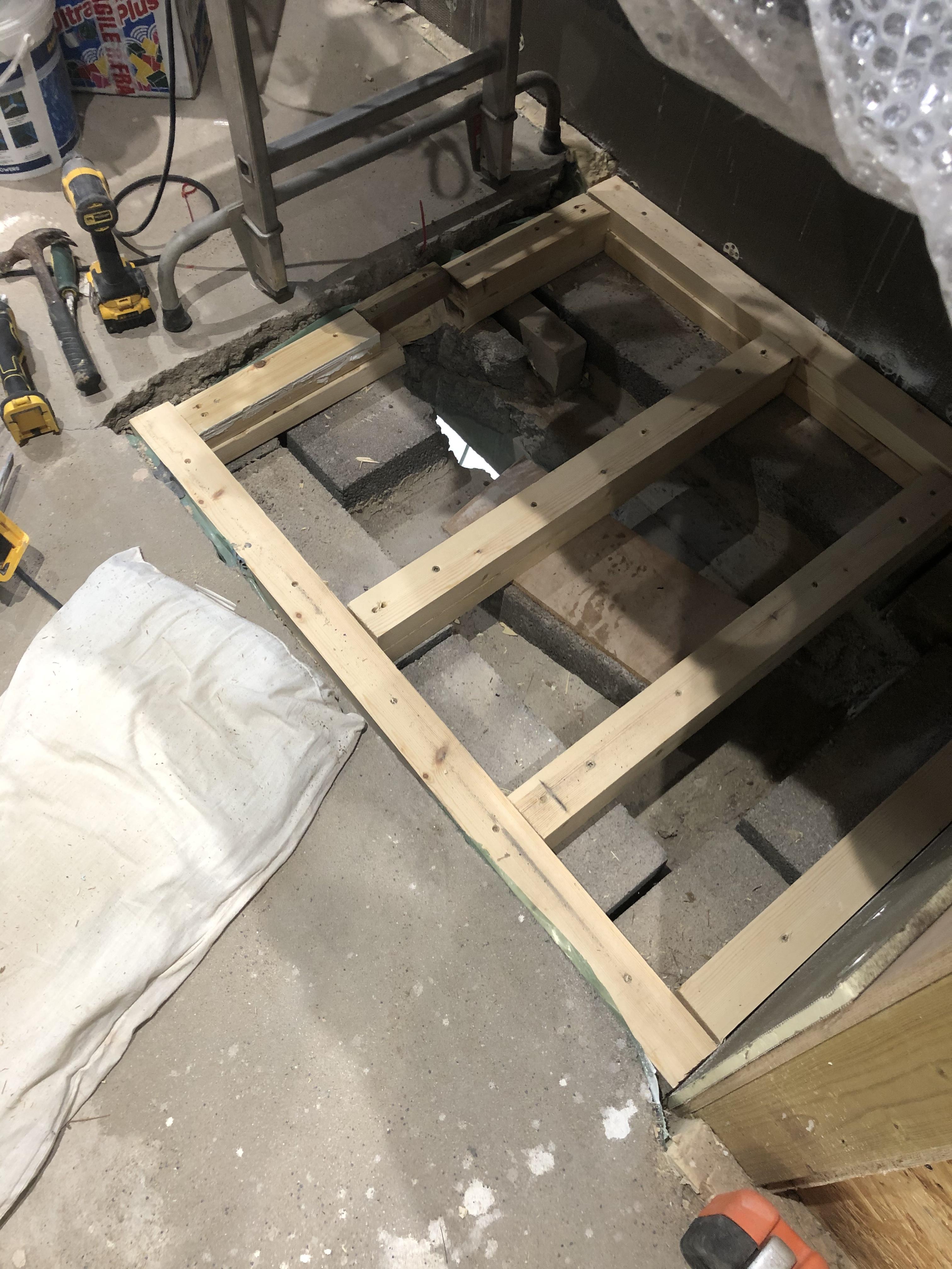

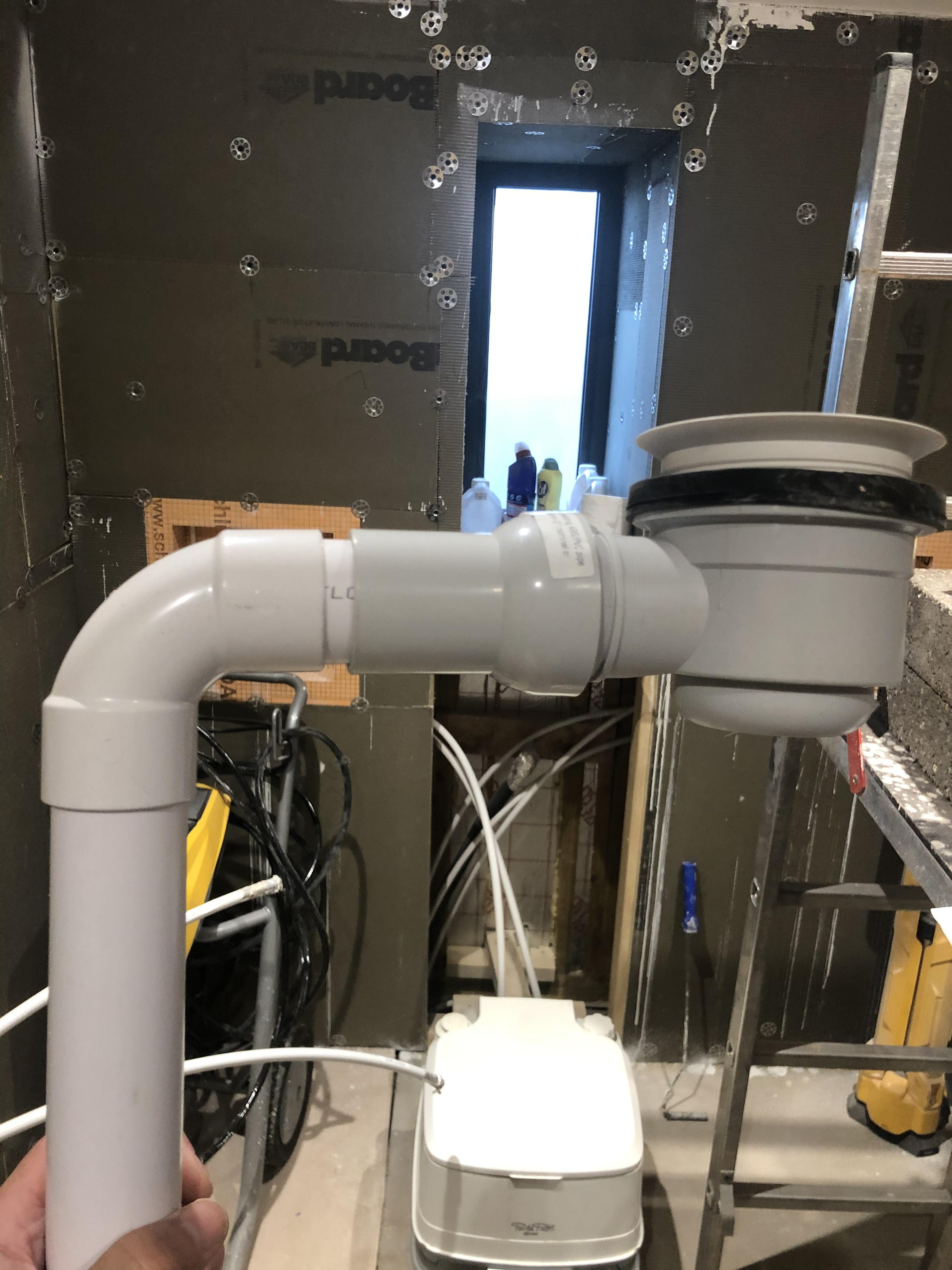

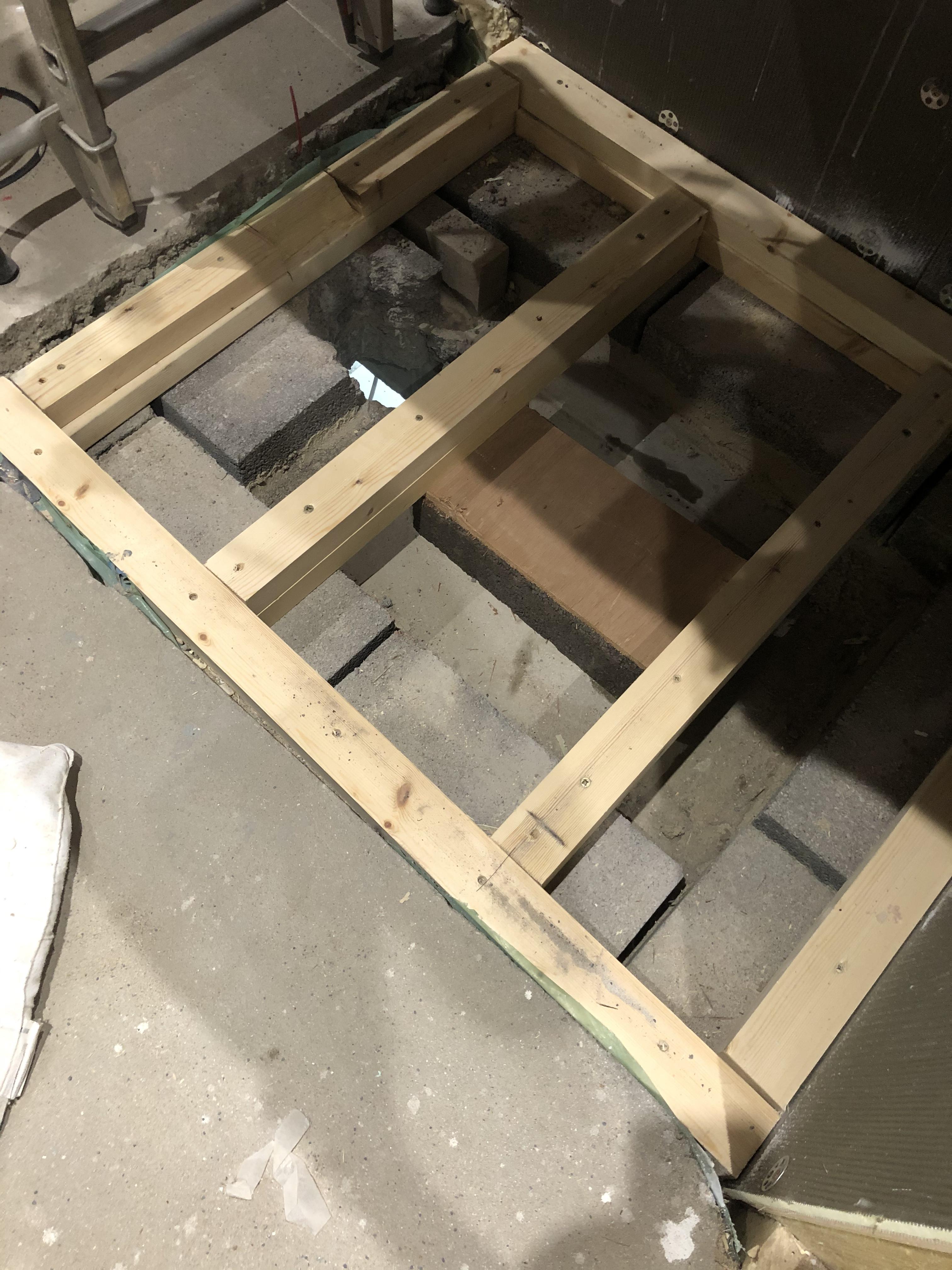

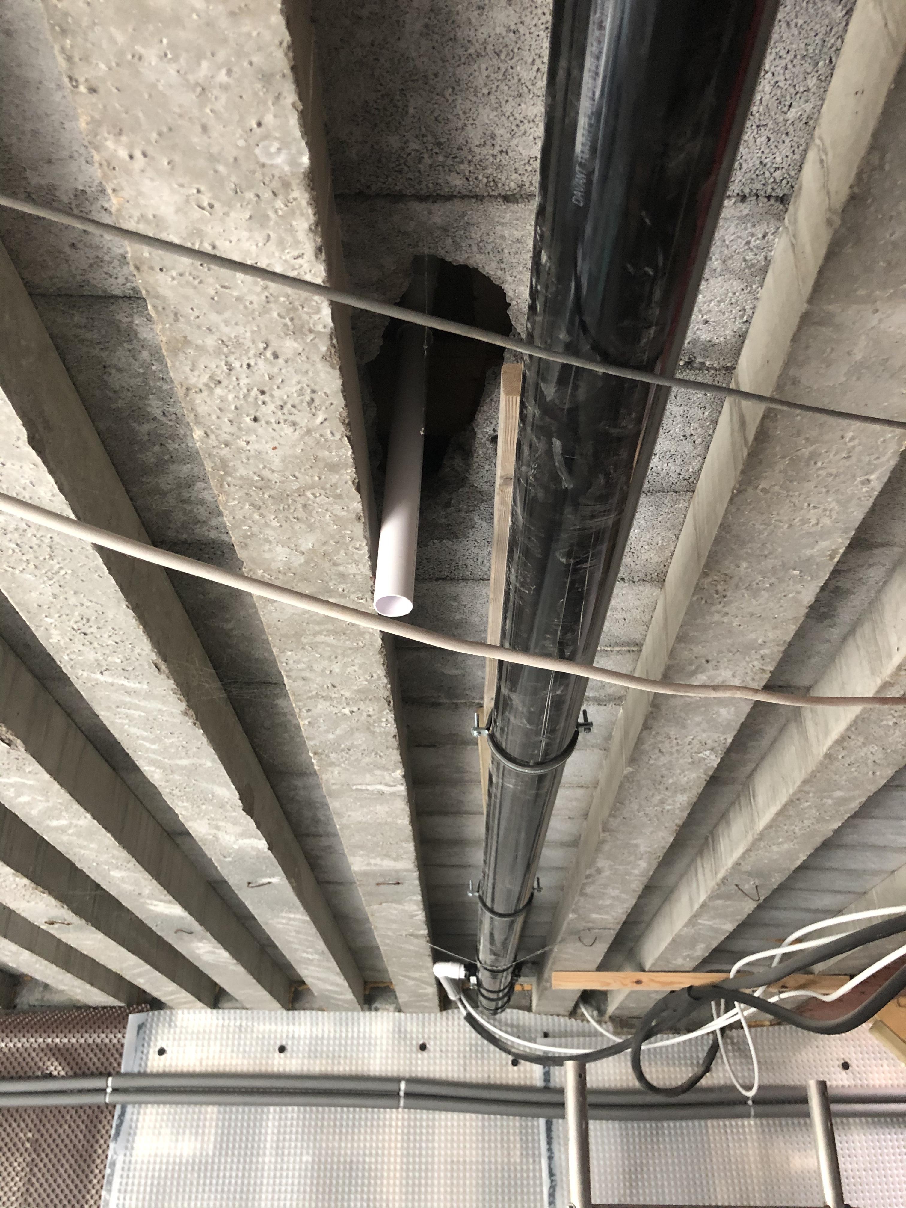

Pocster Posted October 14, 2020 Author Share Posted October 14, 2020 Breaking through ready for the main bathroom shower tray . Waste has to be a swept 90 - would of preferred a 45 degree bend , but it’s the not going to happen 1 Link to comment Share on other sites More sharing options...

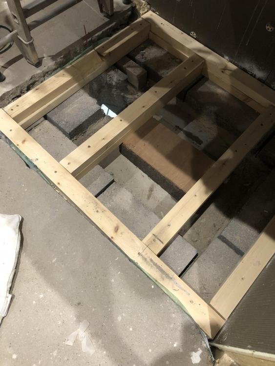

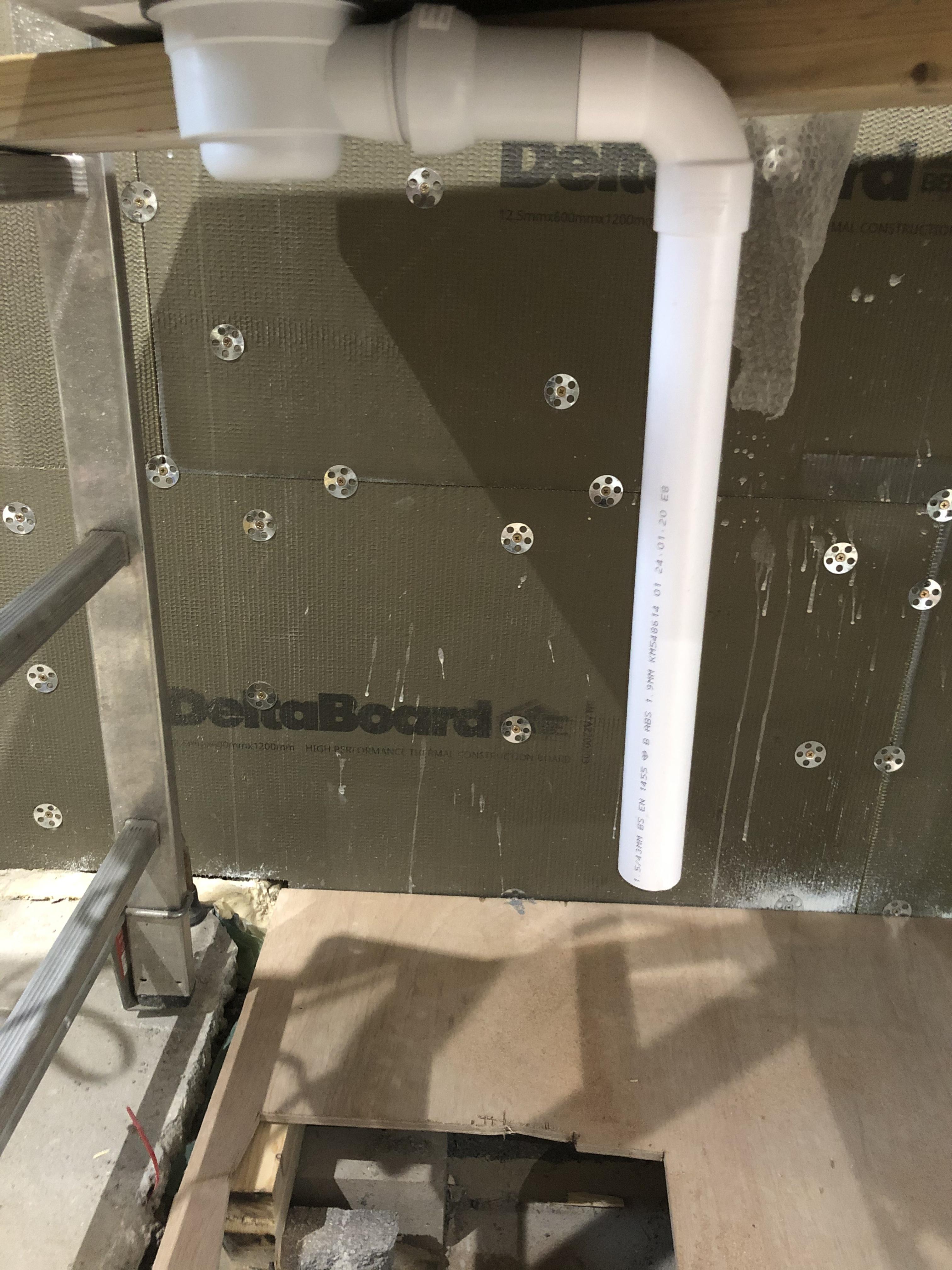

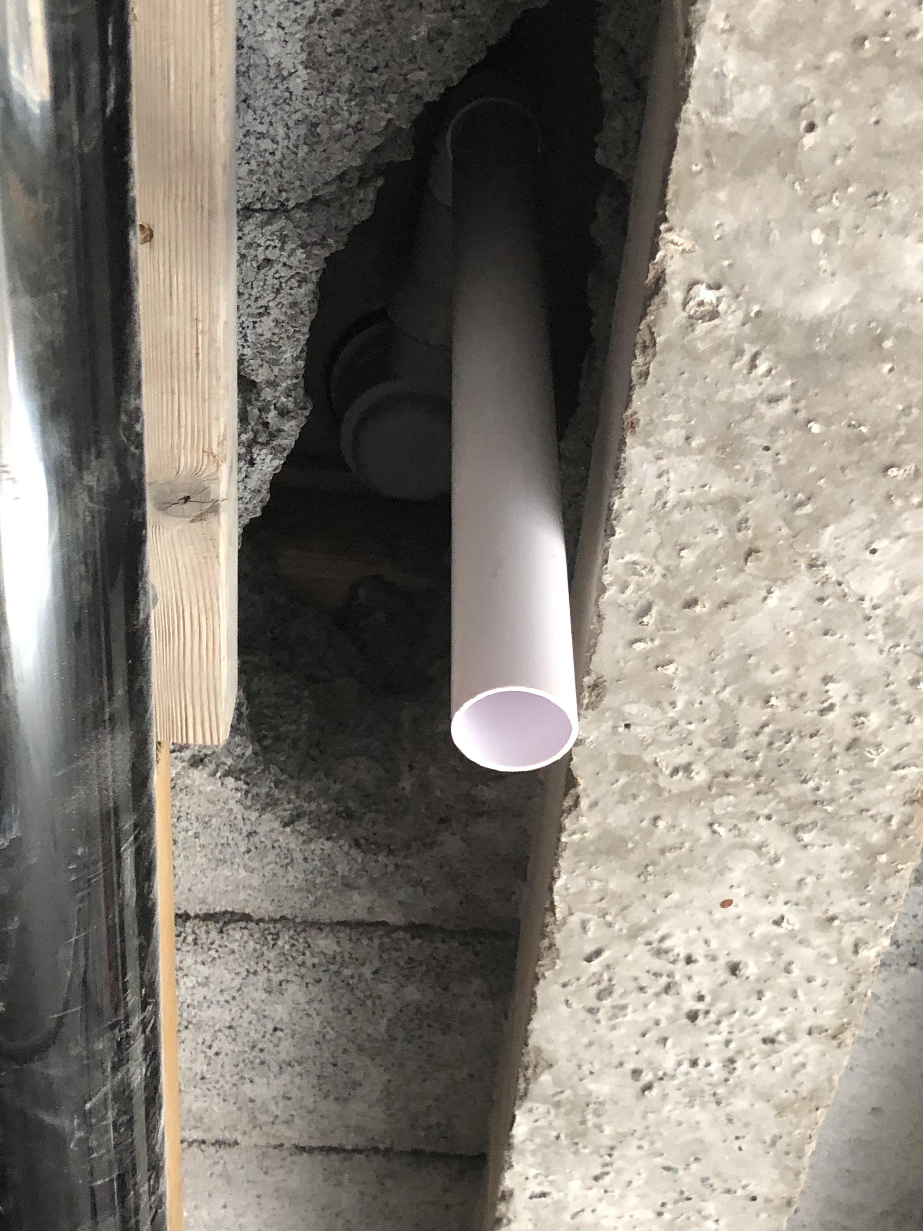

Pocster Posted October 14, 2020 Author Share Posted October 14, 2020 As suspected ,the trays been up and down more times than a vicar on steroids . Just as well I had a winch ! ? More alterations - the waste is a pain . Think it’ll go now ! . Probably have to put it in as I bed the tray - putting it in afterwards would be tricky as 2nd photo shows . Link to comment Share on other sites More sharing options...

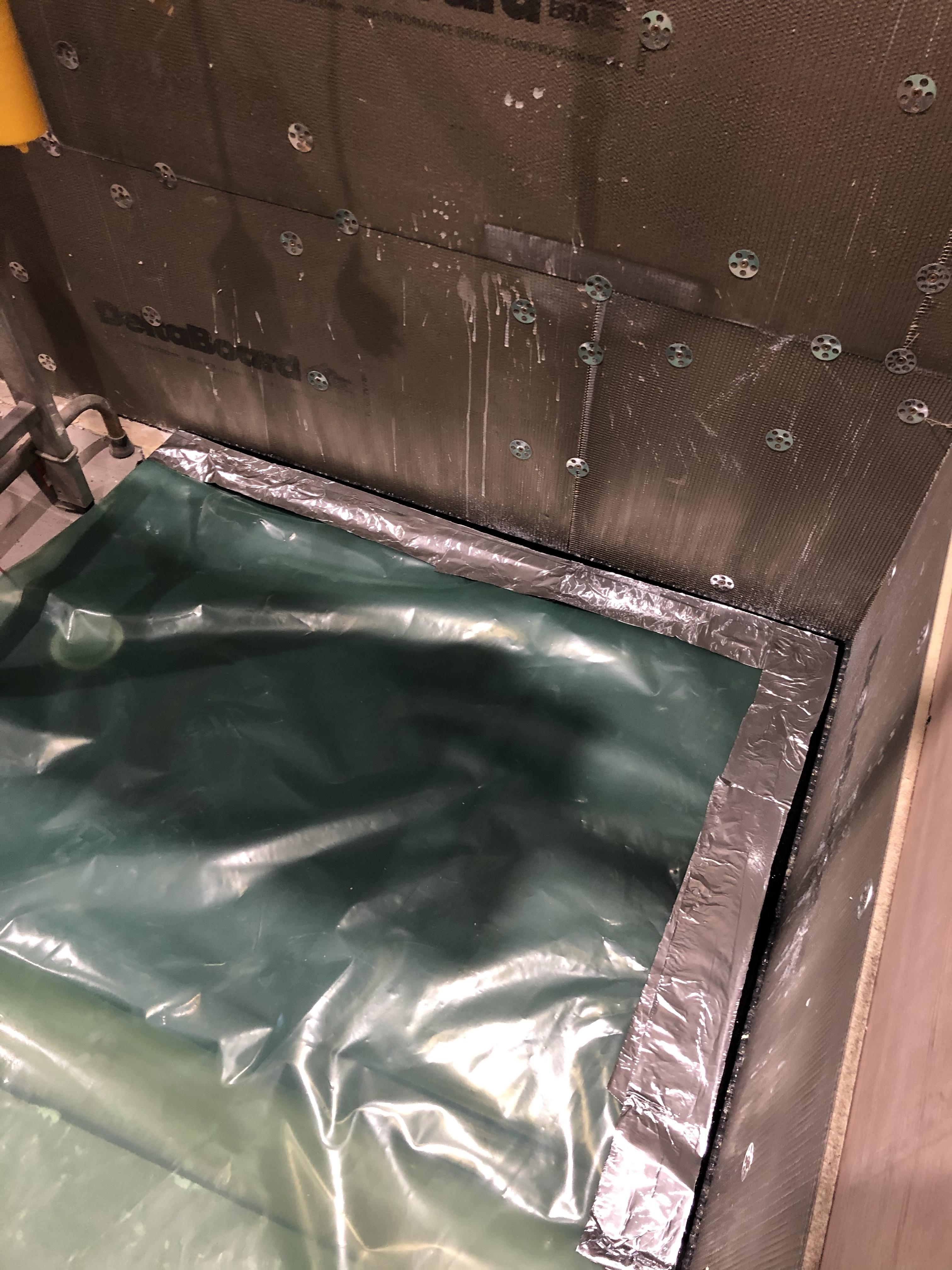

Pocster Posted October 14, 2020 Author Share Posted October 14, 2020 There ! Test phase 1 complete ! As you can see from underneath its a dog to access . Link to comment Share on other sites More sharing options...

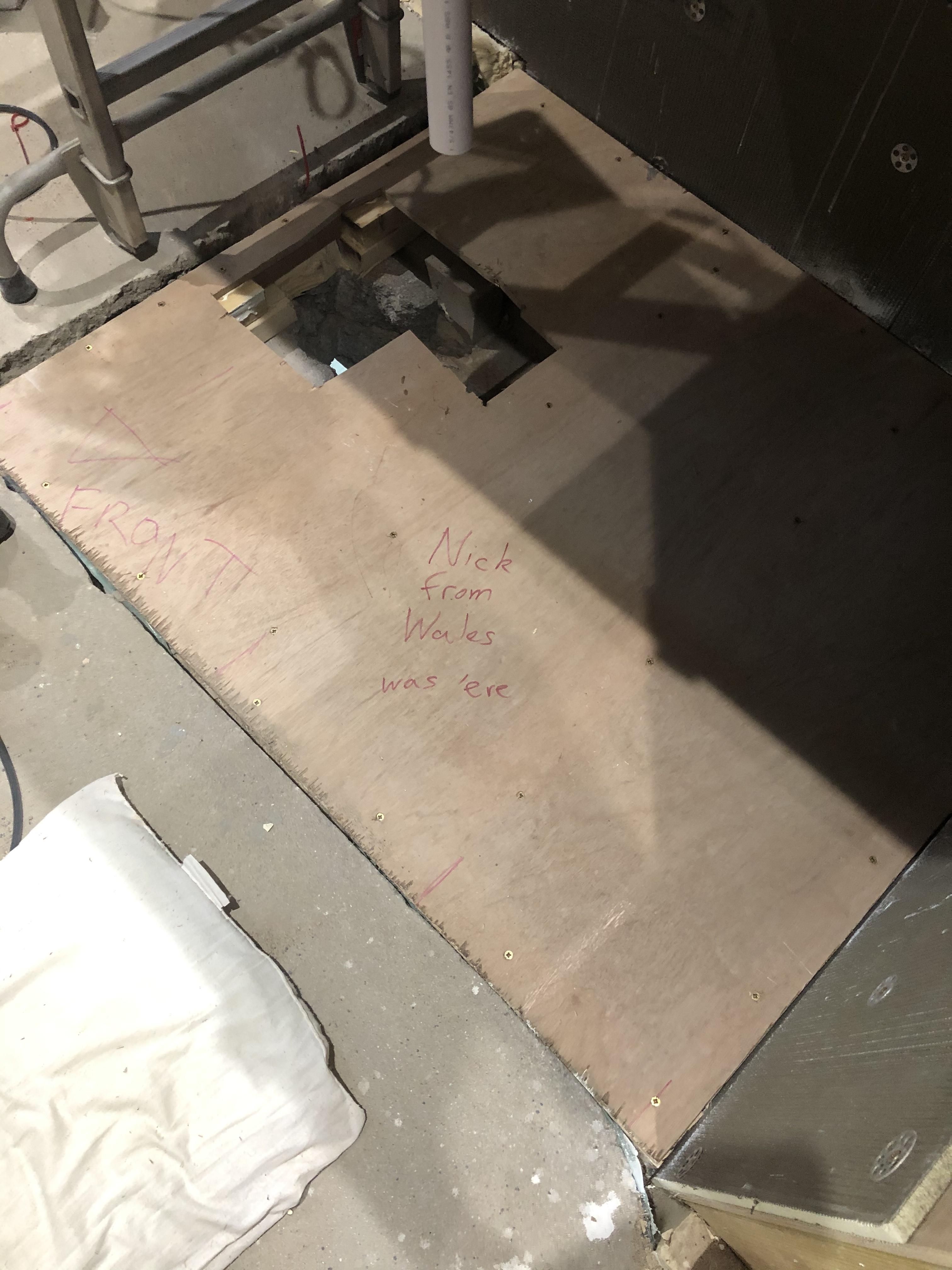

Pocster Posted October 14, 2020 Author Share Posted October 14, 2020 Glue and screw marine ply now . Tomorrow the big black shiny goes in ! ?? Link to comment Share on other sites More sharing options...
Pocster Posted October 14, 2020 Author Share Posted October 14, 2020 Glued screwed and autographed by uncle Nick as usual . The floor not my Mum . 1 Link to comment Share on other sites More sharing options...

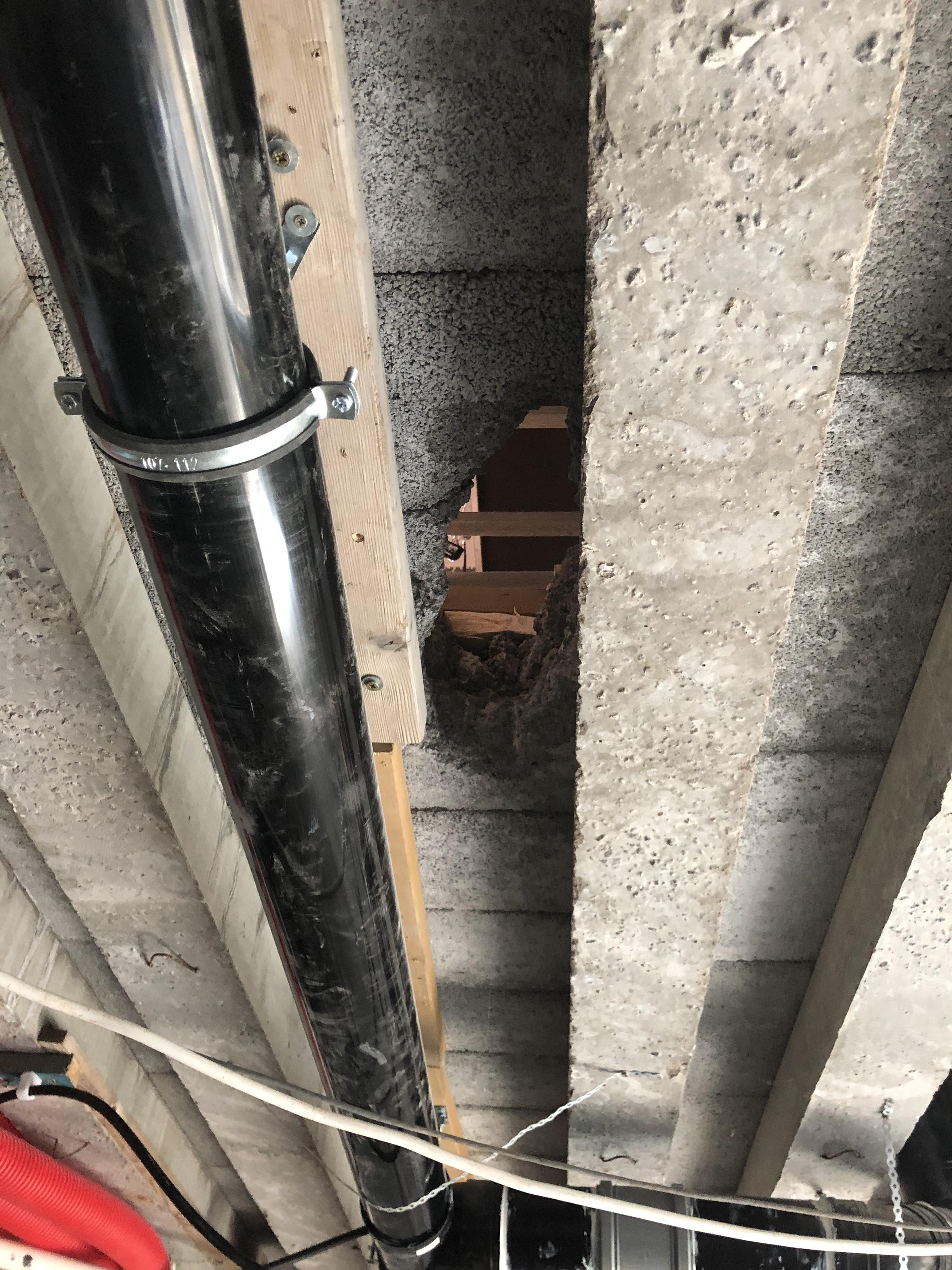

Big Jimbo Posted October 14, 2020 Share Posted October 14, 2020 Don't know if you have noticed fella. There is a soil pipe very near where you have broken through. You should be able to join up with that. 1 Link to comment Share on other sites More sharing options...
Pocster Posted October 14, 2020 Author Share Posted October 14, 2020 9 minutes ago, Big Jimbo said: Don't know if you have noticed fella. There is a soil pipe very near where you have broken through. You should be able to join up with that. Like I didn’t plan that ! ?? 1 Link to comment Share on other sites More sharing options...
Big Jimbo Posted October 14, 2020 Share Posted October 14, 2020 Either that, or pure luck ??? Link to comment Share on other sites More sharing options...
Pocster Posted October 14, 2020 Author Share Posted October 14, 2020 9 minutes ago, Big Jimbo said: Either that, or pure luck ??? Planned mate ! 100% . I got da skillz ! Link to comment Share on other sites More sharing options...
Big Jimbo Posted October 14, 2020 Share Posted October 14, 2020 1 minute ago, pocster said: Planned mate ! 100% . I got da skillz ! You is da bad ass Link to comment Share on other sites More sharing options...

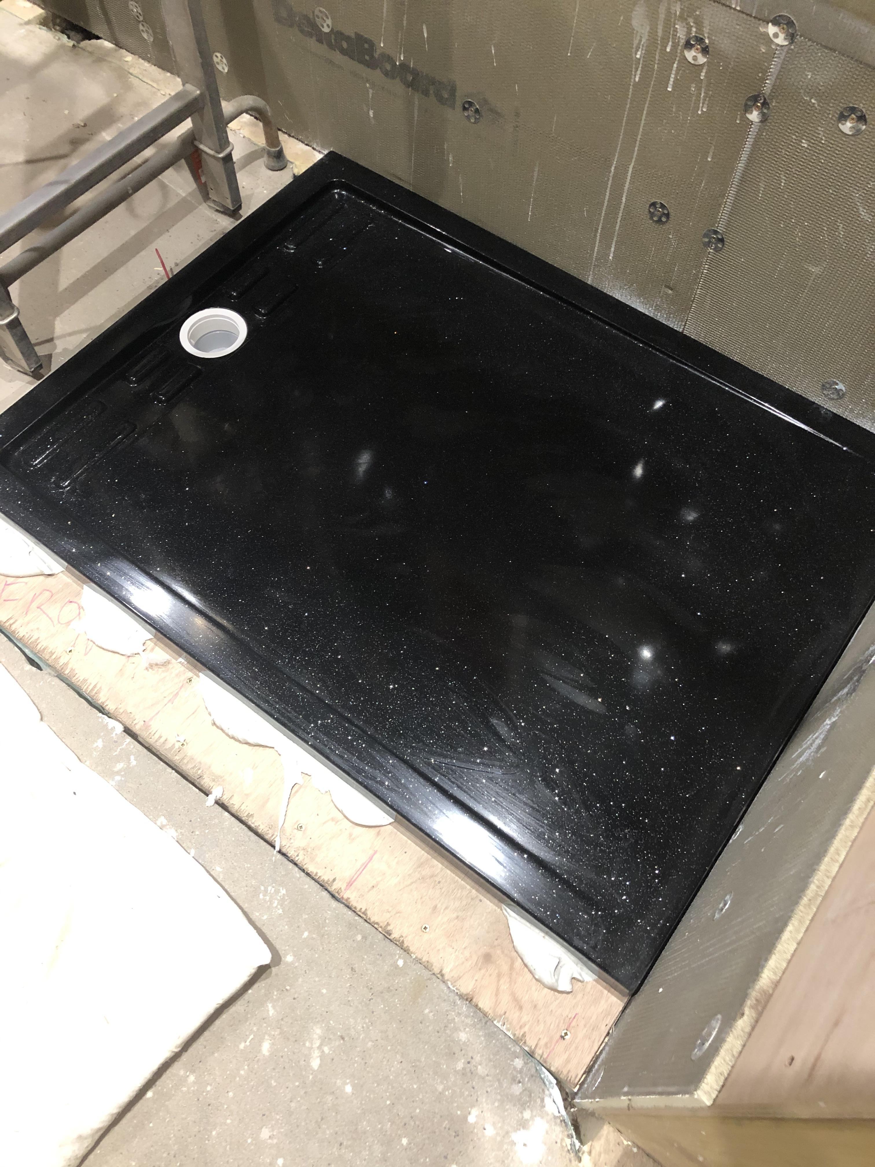

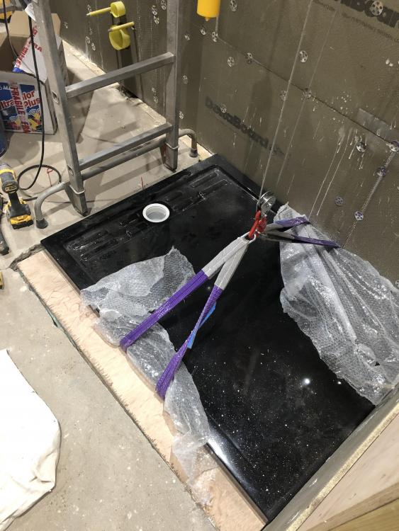

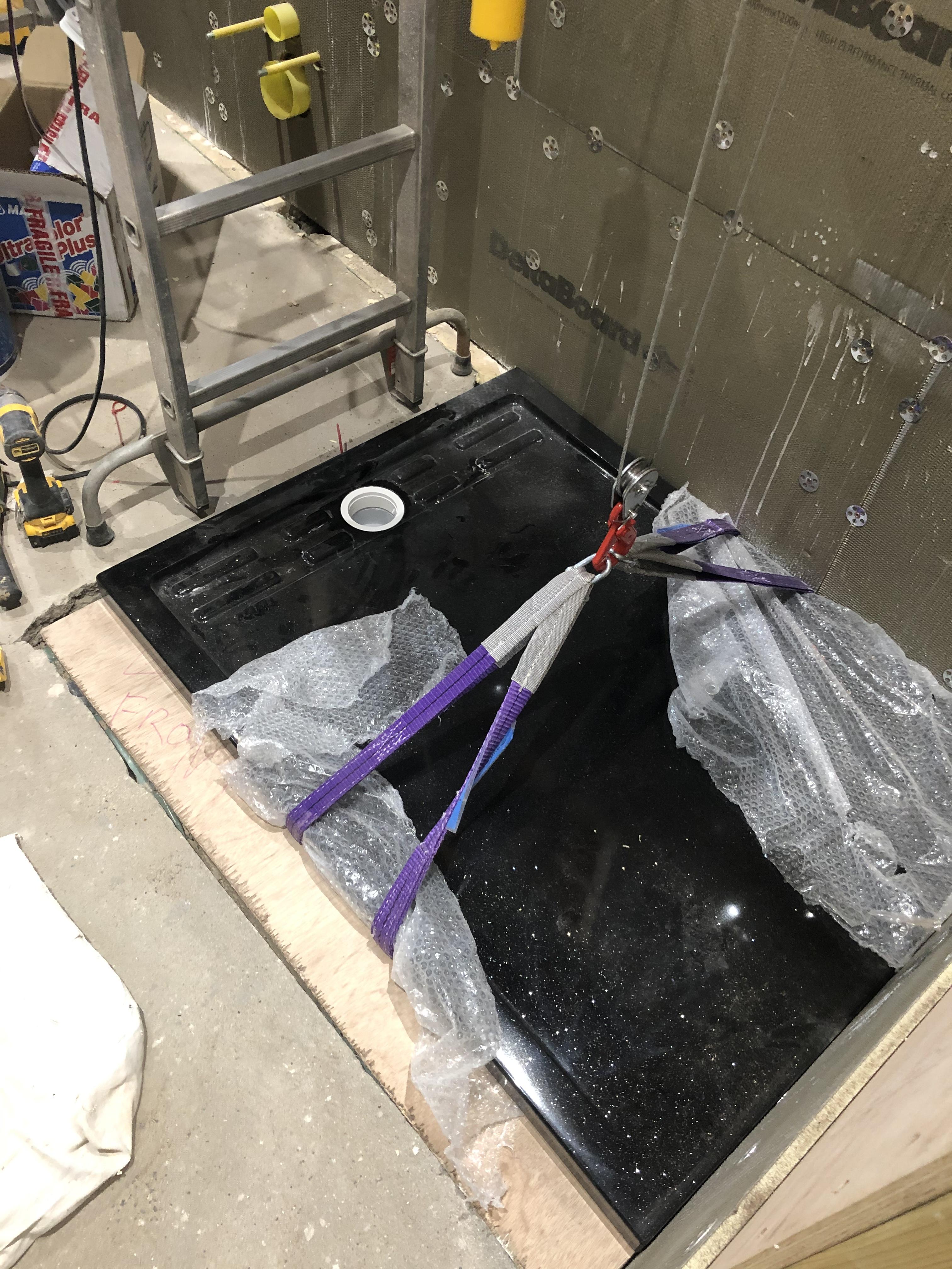

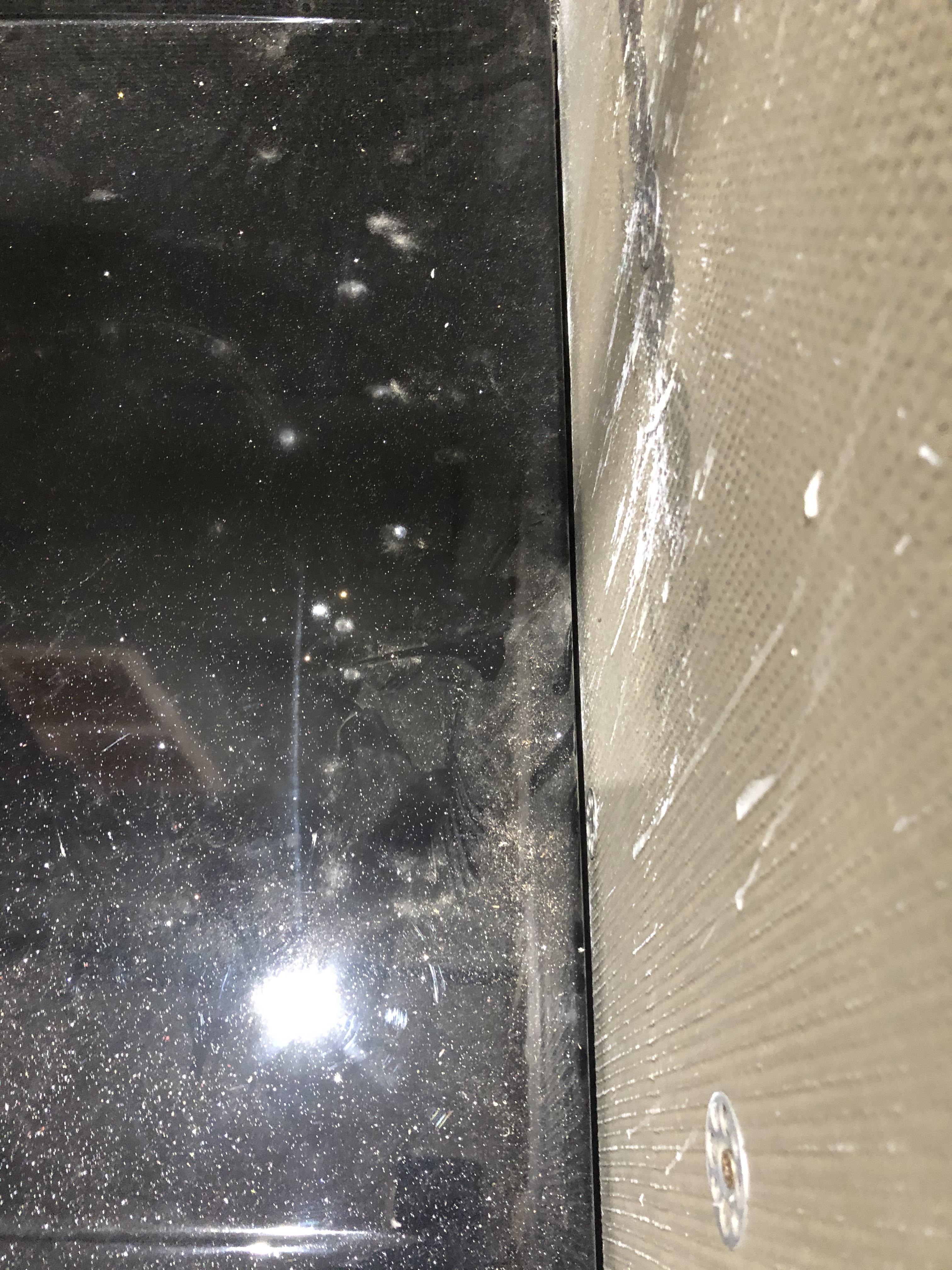

Pocster Posted October 15, 2020 Author Share Posted October 15, 2020 He’s big He’s black He’s sparkly He’s also fecking heavy but ... he’s in ! ?? Learnt my lesson from the ensuite tray and left a nice gap around the edges - probably get 3 tubes of ct1 down there ! I’s da bad ass boy - you get me !? ?? 1 Link to comment Share on other sites More sharing options...
Nickfromwales Posted October 15, 2020 Share Posted October 15, 2020 No time to dwell. Get the tiles on !! ?. Top job, and you only had to pull one T*mpon out to get there. Da iawn cariad. 1 Link to comment Share on other sites More sharing options...

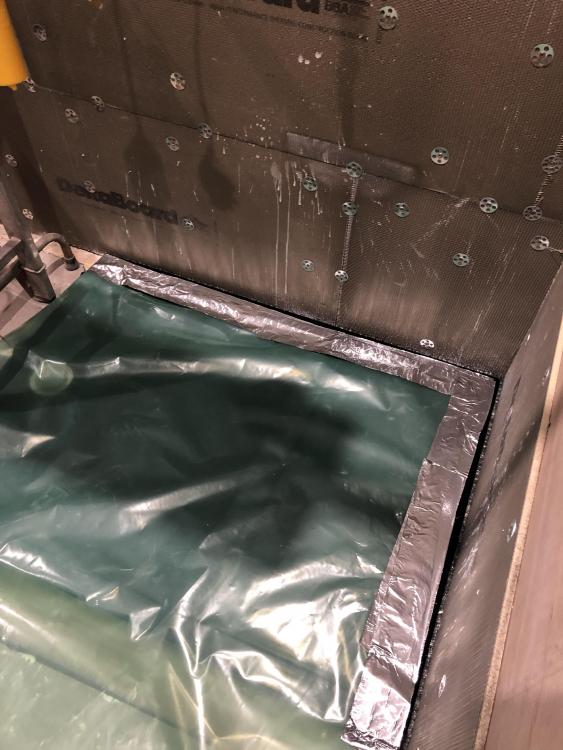

Pocster Posted October 15, 2020 Author Share Posted October 15, 2020 19 minutes ago, Nickfromwales said: No time to dwell. Get the tiles on !! ?. Top job, and you only had to pull one T*mpon out to get there. Da iawn cariad. Why does everyone always want to rush tiling . That’s it for today on the tray . Tomorrow ct1 down the edges . Day after blue tanking stuff ( that needs 2 days to allow for drying ) . Then the ct1 ‘lip’ from wall to tray . Tiling is weeks away ! Chill peeps ; da Pocster is in de ‘Ouse . Link to comment Share on other sites More sharing options...

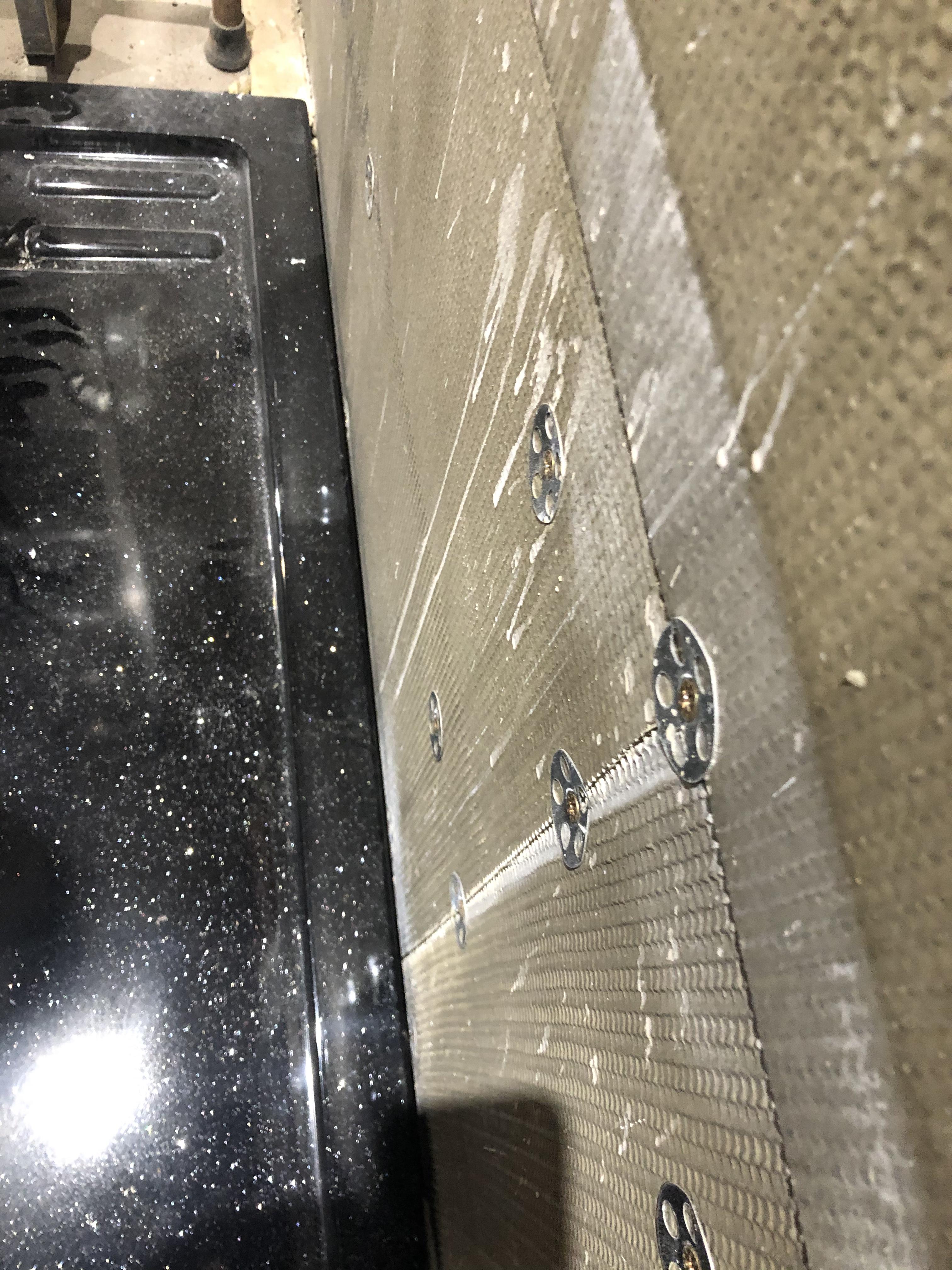

Pocster Posted October 16, 2020 Author Share Posted October 16, 2020 1 and half tubes of ct1 round the edges . I find if I wait 10 mins it will drop - so probably get another half a tube down there . Link to comment Share on other sites More sharing options...
