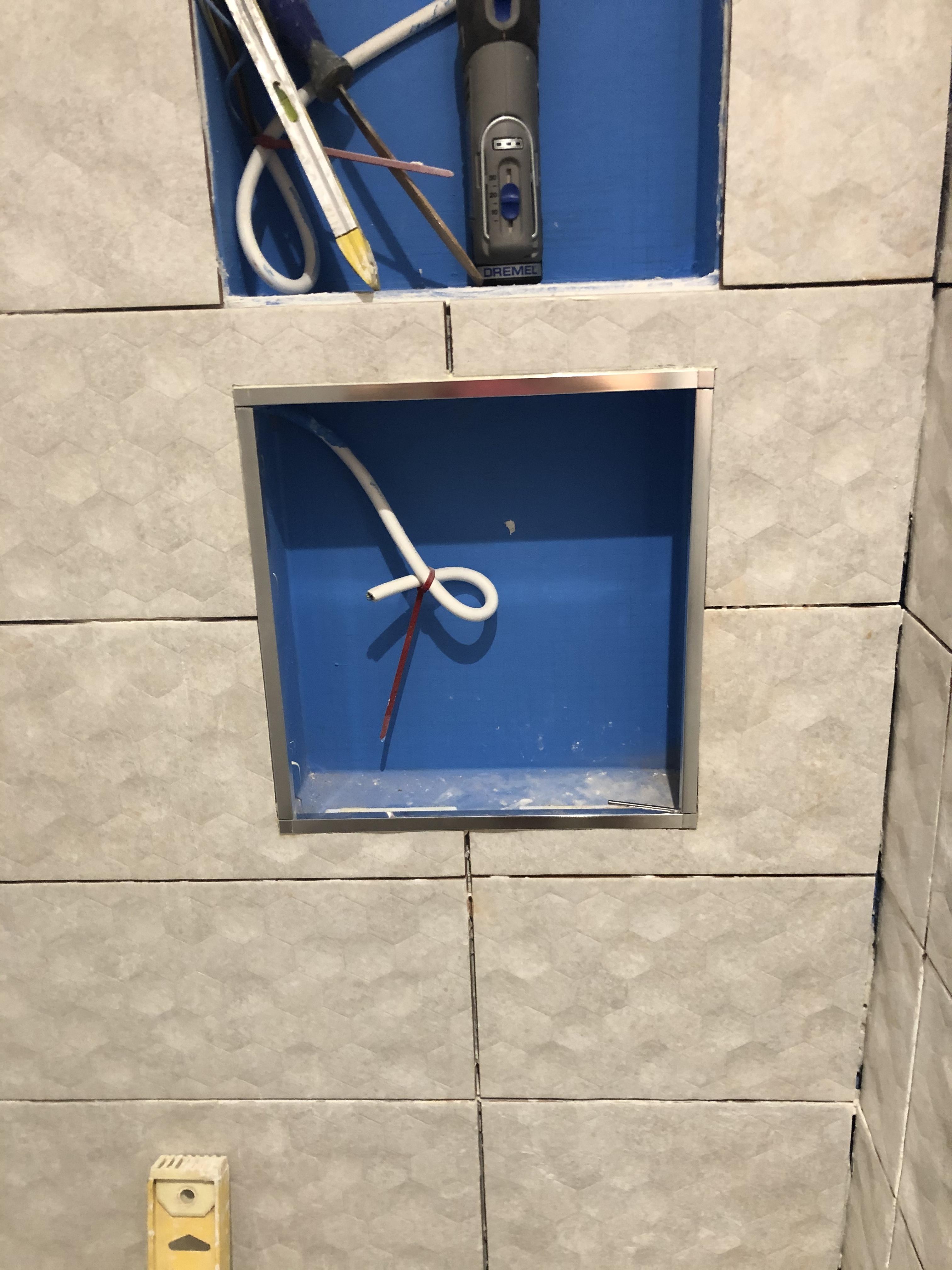

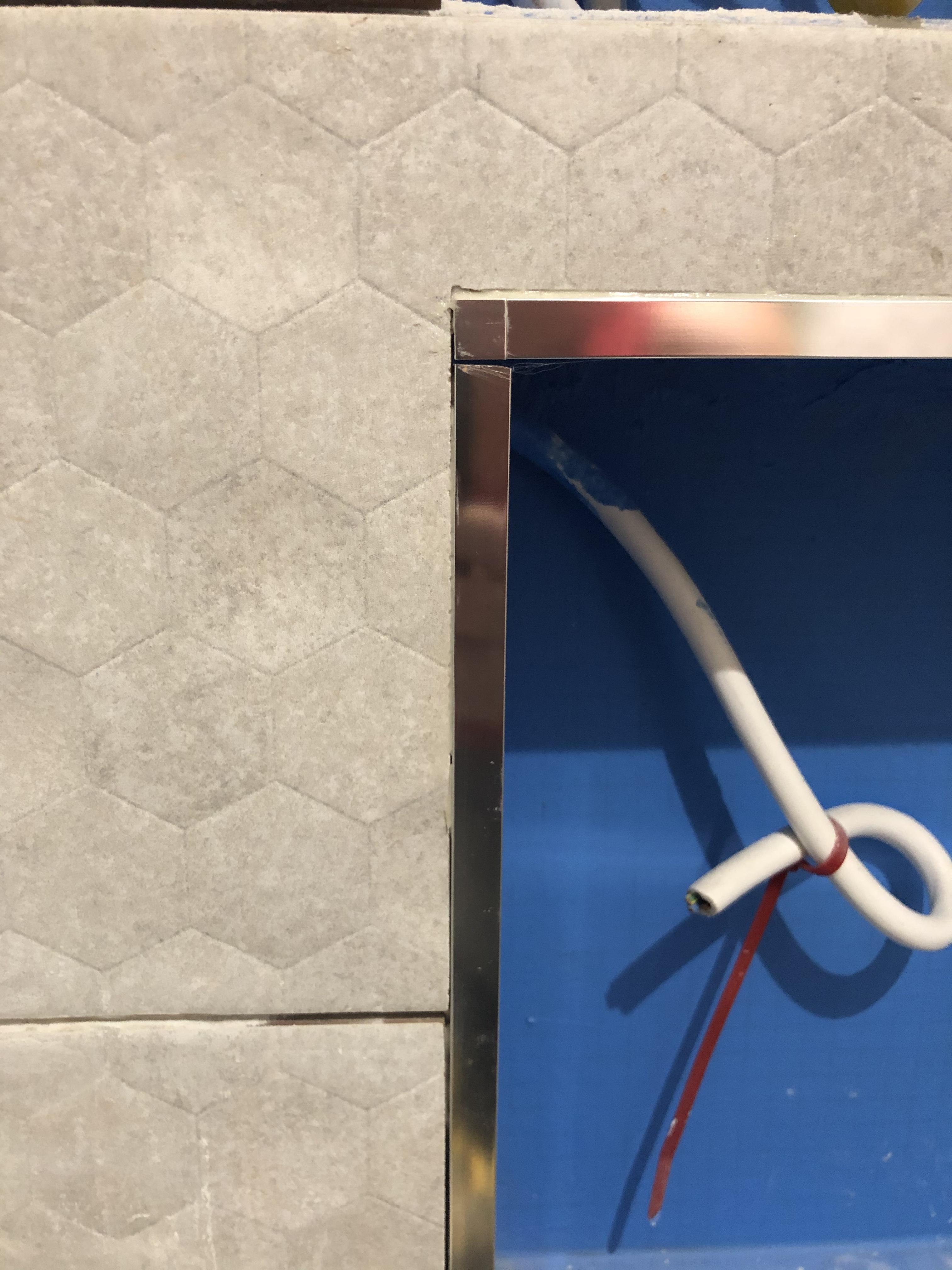

This metal beading feels a bit hopeful !
It requires skill is what I mean !
Ok from a distance .
Less than perfect close up . Will use coloured sealant on ‘gaps’

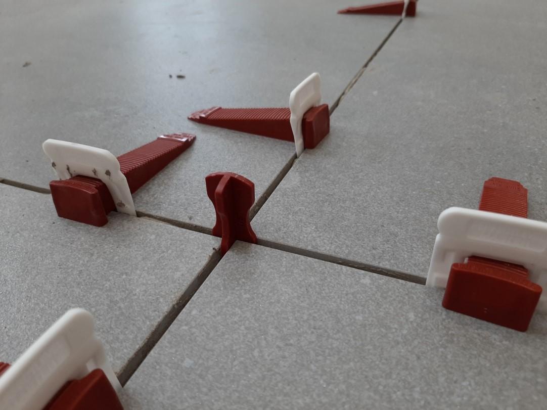

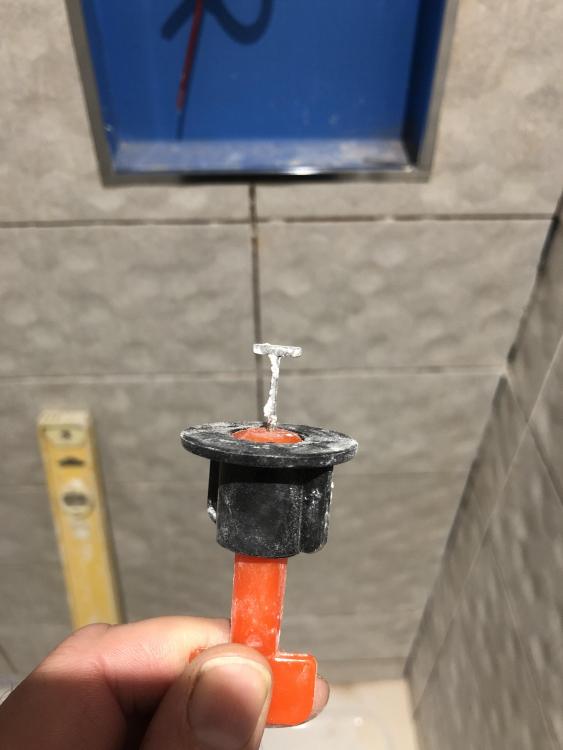

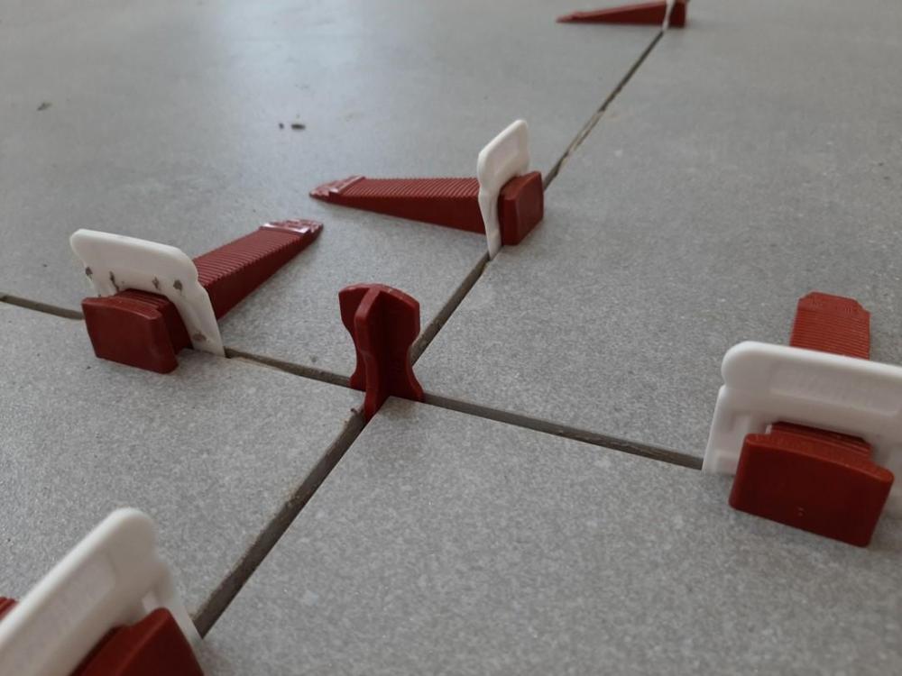

We have just used the Perfect Level Master (tile levelling system) on our large format floor tiles - the clips are available in 1, 2 or 3mm so they space the tile at the same time as levelling it.
I am impressed and certain that the tiles would not be as level as they are if they had not been used.

Don't your red/black things level and keep the gap?
Level yes . Gap no  unless you want 1mm gap

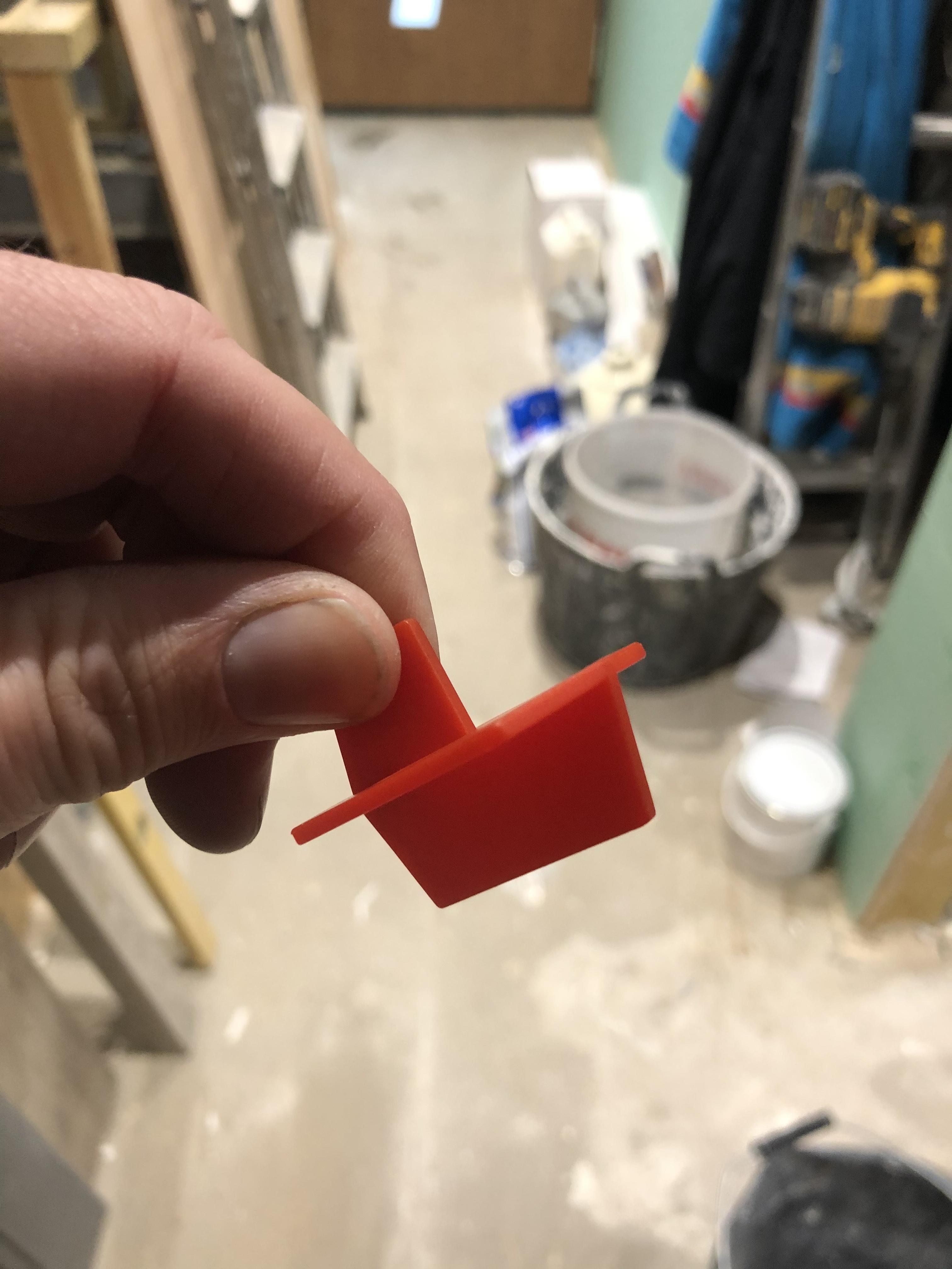

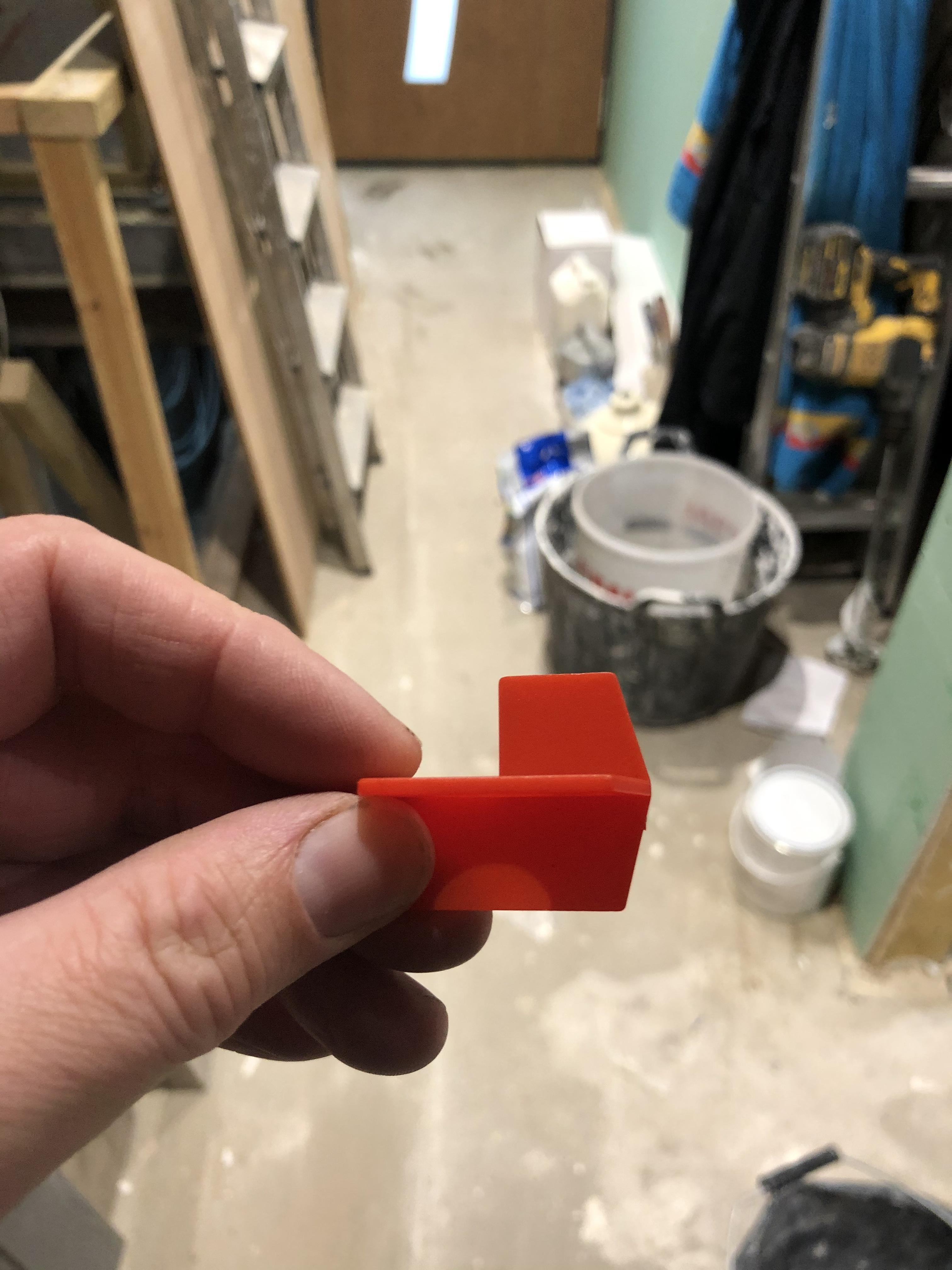

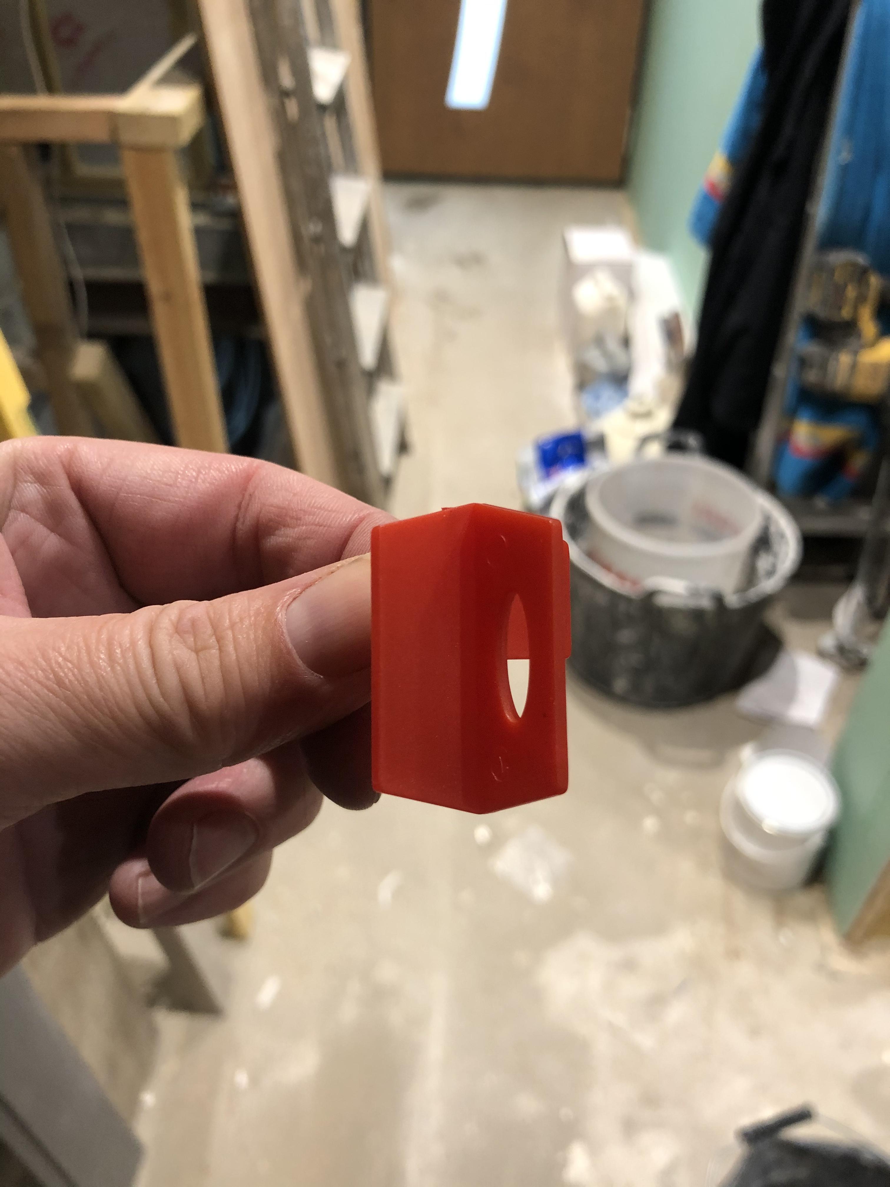

These arrived today . The grout gap maybe 2mm using these . What I do like is they can space corners and edges . Assuming they don’t fall out
Those red/black levellers have a skinny spindle - I felt the gap created would be too narrow

Perfect level master can be used on walls, but as you have already worked out - you can use a spacer with your levelling system.
This our floor using the 3mm clips and corner spacers
Edited by wozza
This our floor using the 3mm clipsimageproxy.php?img=&key=f5f06bfe2c42e69cimageproxy.php?img=&key=f5f06bfe2c42e69cimageproxy.php?img=&key=f5f06bfe2c42e69c and corner spacers

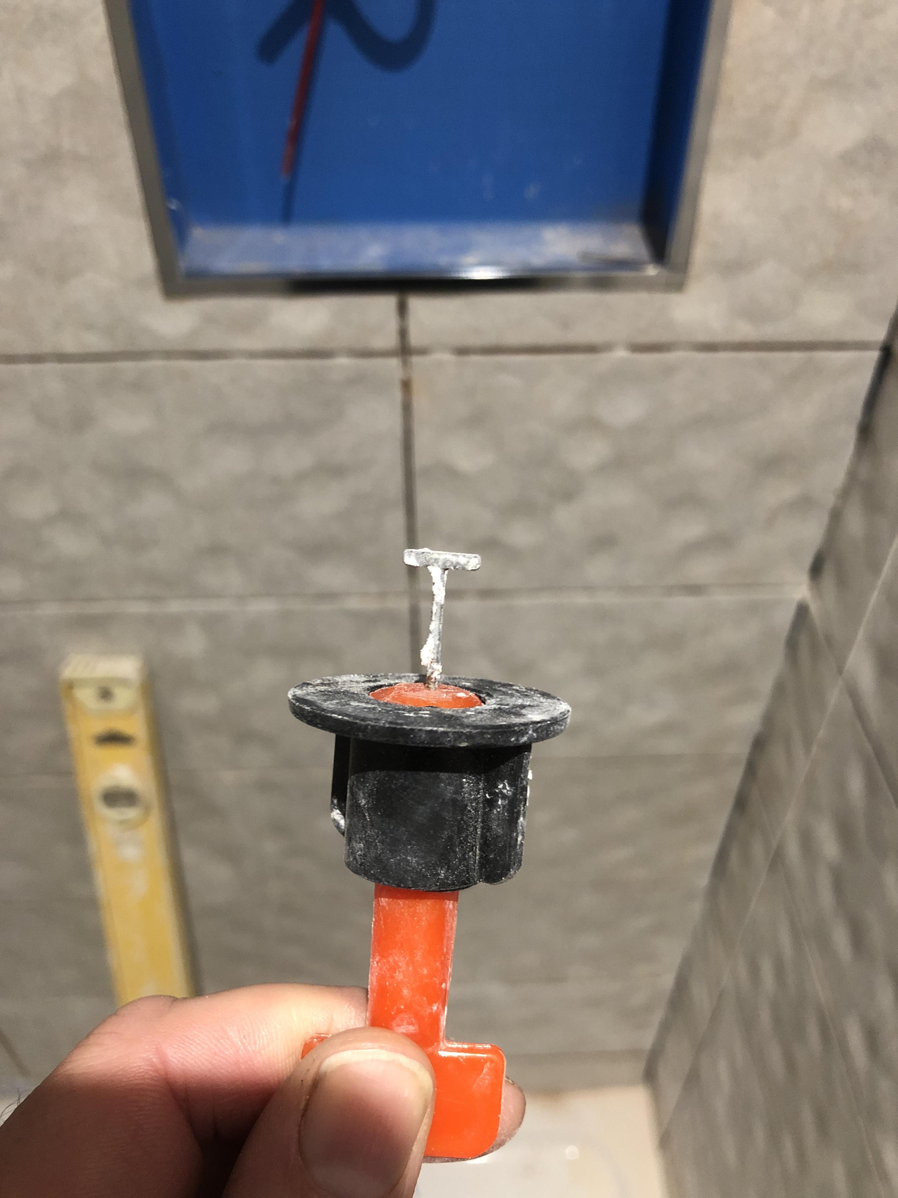

Having said all that I’m sure I’ve got some rubi tile levelling stuff here . I assumed it’s just for floors as you kick off the plastic next day . Not sure you can use in walls ?
Similar to the system you mention .
Don’t fancy hammering plastic bits off wall tiles ?
They snap off easily as you knock them off inline with the grout line.
Yeah ? So even on wall tiles ? . Nothing worse than the snapped plastic isn’t deep enough I.e shows through the grout .
3 minutes ago, wozza said:
Ours all seem to have snapped fine.  I think these are the older clips but its still the same principal.
