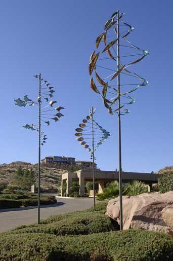

Moira Niedzwiecka Posted August 10, 2019 Share Posted August 10, 2019 I am just starting to think about the garden at the new house. I quite like some of the wind sculptures/spinners that are about. It occurred to me that they generate a lot of energy when it is breezy, like mini turbines or a dynamo. I am really dim at this stuff but would it be possible to harness some of that energy to use in the garden, eg for a water feature or pond pump, or garden lighting? I Link to comment Share on other sites More sharing options...
Temp Posted August 10, 2019 Share Posted August 10, 2019 I guess that would be possible but they will be a less efficient than a regular wind turbine of similar size. There may also be a planning issue. Link to comment Share on other sites More sharing options...
SteamyTea Posted August 10, 2019 Share Posted August 10, 2019 1 hour ago, Moira Niedzwiecka said: It occurred to me that they generate a lot of energy when it is breezy, like mini turbines or a dynamo. They just don't. It is all to do with the area they present to the wind and the windspeed. Link to comment Share on other sites More sharing options...
Moira Niedzwiecka Posted August 10, 2019 Author Share Posted August 10, 2019 48 minutes ago, Temp said: There may also be a planning issue I doubt it, these are just garden ornaments. My garden is quite elevated & gets a bit blowy. I just wondered if the energy from a group of 3 wind sculptures could be harnessed in anyway to power a small water feature. Link to comment Share on other sites More sharing options...
PeterW Posted August 10, 2019 Share Posted August 10, 2019 Yes probably as you only need a few watts of power. Transferring the rotary power to a generator may be the issue though so daft as it sounds a purely mechanical way may be easier such as the way the old wind pumps used to work. Link to comment Share on other sites More sharing options...
Jeremy Harris Posted August 10, 2019 Share Posted August 10, 2019 19 minutes ago, Moira Niedzwiecka said: I doubt it, these are just garden ornaments. My garden is quite elevated & gets a bit blowy. I just wondered if the energy from a group of 3 wind sculptures could be harnessed in anyway to power a small water feature. Possibly, it depends on how large they are, how much wind there is and how much power the water pump needs. I've been looking at using a small solar panel to power a pump for a small water feature. I want to be able to pump around 10 litres per minute (about the flow rate of a shower) to a head of about 0.2 to 0.3m to create a small artificial stream. The power needed to move that much water is between about 0.32 W and 0.5 W, and allowing for the efficiency of the water pump it looks as if I'd need between about 1 W to 1.5 W of electrical power from a solar panel. This is surprisingly little, I had to double check the sums to make sure I'd got them right. I can now see how the small solar pond fountains work as well as they do; they just don't need very much power at all. If your wind sculptures had a swept area (the area exposed to the wind) of, say, 1m², then with a wind speed of just under 5mph the theoretical power available would be around 4.92 W, but allowing for the efficiency of the generator the electrical power output would probably only be around 2 W, but even so it seems quite possible to use a fairly large wind sculpture to drive a water feature. Doing as @PeterW suggests, and making the drive purely mechanical, would probably improve things slightly. Link to comment Share on other sites More sharing options...
joe90 Posted August 10, 2019 Share Posted August 10, 2019 I looked into a Wild West type of wind driven pump when considering using well water for my site, simple diaphragm pump to create a head of water. Link to comment Share on other sites More sharing options...
Temp Posted August 10, 2019 Share Posted August 10, 2019 4 hours ago, Moira Niedzwiecka said: I doubt it, these are just garden ornaments. When you connect them to a generator or pump they become a wind turbine :-) The ones in your original picture don't look that different to this type of vertical axis wind turbine. Smaller ones are sometimes used on boats. Link to comment Share on other sites More sharing options...

MikeSharp01 Posted August 11, 2019 Share Posted August 11, 2019 19 hours ago, Moira Niedzwiecka said: We saw these in UTAH earlier in the year and purchased one, can't imagine it will generate much electricity but it does generate a lot of interest Link to comment Share on other sites More sharing options...

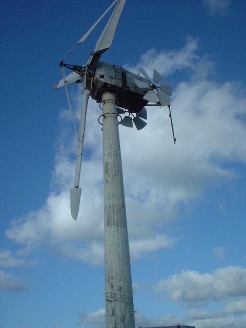

SteamyTea Posted August 11, 2019 Share Posted August 11, 2019 The very first commercial wind turbine was installed down here, between Falmouth and Helston at Sewogan. It sat unused for decades, but I think it has gone now. Was pretty ugly. Link to comment Share on other sites More sharing options...
