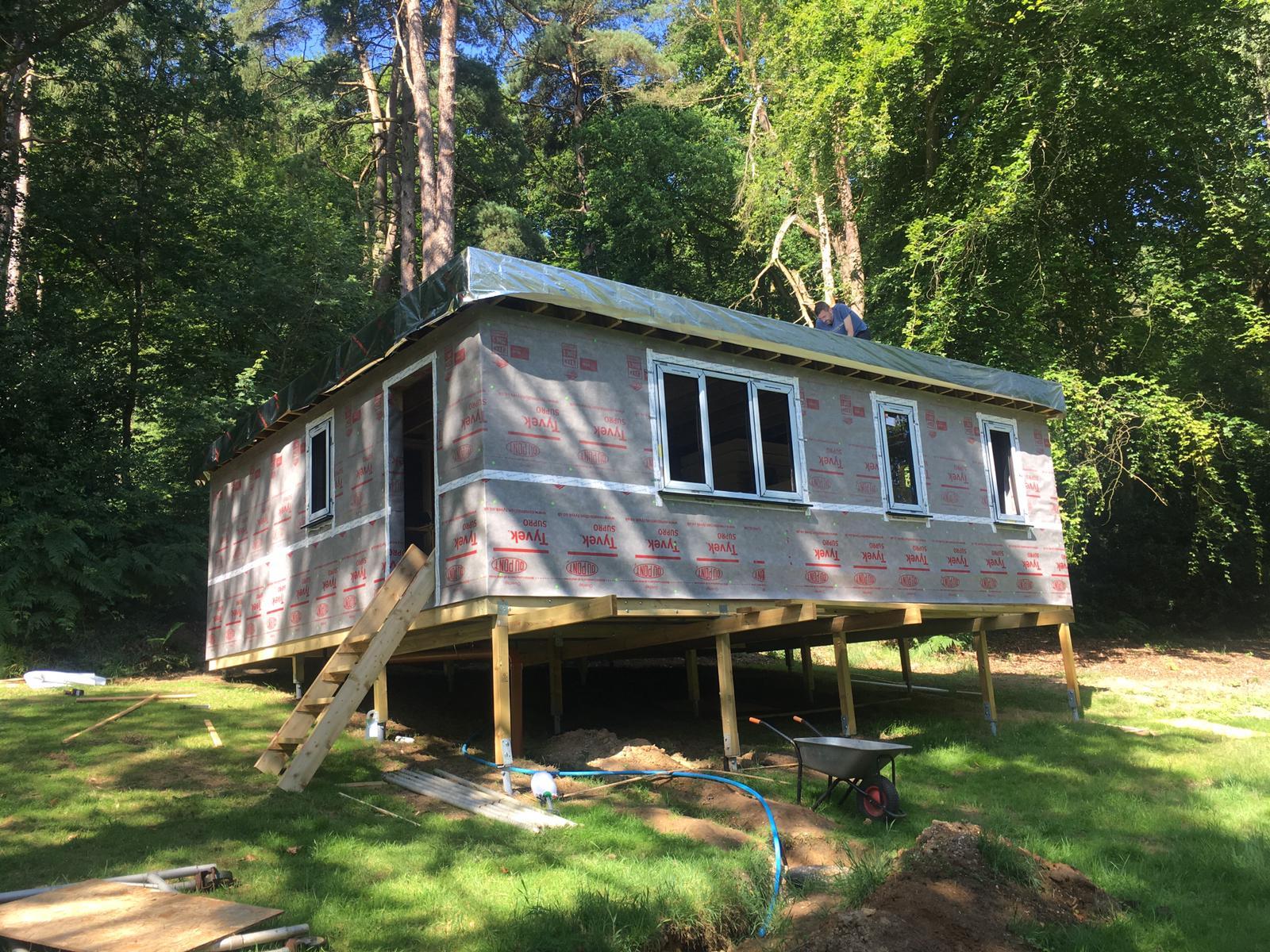

Piers Posted August 3, 2019 Share Posted August 3, 2019 "You could heat it with a candle, mate" was what a visiting roofer told me recently. He thought we'd overdone it by installing insulation properly and (horror of horrors) taping joints. But now I AM thinking about how to heat it (our PD outbuilding) and I'd hoping for some advice/tips/sales pitches/etc. This is what it currently looks like: : It's about 55m2 inside - 3 rooms inc. open-plan workshop, yoga studio and a bathroom. Strictly incidental use as it's a PD building. The building is too small for ASHP (IMO) and doesn't have access to gas. We're looking at ways to heat it with 'leccy. Default idea was to stick some electric rads in. But my Polish plumber has persuaded me to look at Termofol, infrared UFH. He tells me it's very popular in Poland. (https://termofol.co.uk/) Has anyone used this stuff, or anything similar? Any good? Limitations? The other idea, which I'm a bit less keen on, is using wall-mounted infrared panels like those made by Herschel (https://www.herschel-infrared.co.uk/) and others. Has anyone tried these? I'm really open to ideas on this. And if nothing works out, I've always got a candle as a fallback.... 1 Link to comment Share on other sites More sharing options...

ProDave Posted August 3, 2019 Share Posted August 3, 2019 Why is it too small for an ASHP? Seek out a cheap one on ebay and DIY install it with some under floor heating. the HP won't be complaining that it does not turn on much. P.S I would be wanting some diagonal bracing on those longer front legs that it is standing on. Link to comment Share on other sites More sharing options...

Onoff Posted August 3, 2019 Share Posted August 3, 2019 Any pics of the timber frame construction supporting everything? As in pre the floor going on. Might help @zoothorn on here who's aiming for something similar on his stream bank. +1, I thought 30m2 was the limit? Tbh I'd have expected it to have been built on piers... 1 Link to comment Share on other sites More sharing options...

Russell griffiths Posted August 3, 2019 Share Posted August 3, 2019 Plus one for looking at those front legs, triangulation needed on those I would have thought. 1 Link to comment Share on other sites More sharing options...
Piers Posted August 4, 2019 Author Share Posted August 4, 2019 21 hours ago, ProDave said: P.S I would be wanting some diagonal bracing on those longer front legs that it is standing on. 19 hours ago, Russell griffiths said: Plus one for looking at those front legs, triangulation needed on those I would have thought. Yes, absolutely. They're going to be braced. 21 hours ago, ProDave said: Why is it too small for an ASHP? Seek out a cheap one on ebay and DIY install it with some under floor heating. I just remember someone telling me that ASHP doesn't really make sense for a building of this size. I was also told that because the floor is timber and suspended off the ground, we won't have an awful lot of thermal mass to heat using UFH (and to retain heat after the UFH goes off). I think that's what @JSHarris is saying too 21 hours ago, JSHarris said: For your design, raised on piers, the heat loss rate from any UFH systems will be a bit higher in cold weather 21 hours ago, JSHarris said: Direct electric heating will be close to the most expensive way to heat the building, and direct electric floor heating will be more expensive to run than electric heating that doesn't heat an internal surface, but whether that matters really depends on the balance of installation cost versus typical running cost through life. Are you saying that, as the lesser of two evils, direct electric rads are going to be cheaper to run than direct electric UFH? 21 hours ago, SteamyTea said: Air to air heat pump, get some cooling too. @SteamyTea, what kind of A2A have you got? Something like this: //www.appliancesdirect.co.uk/p/iqool-2ms9k9k/tcl-iqool2ms9k9k-air-conditioner Link to comment Share on other sites More sharing options...

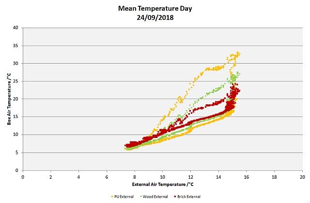

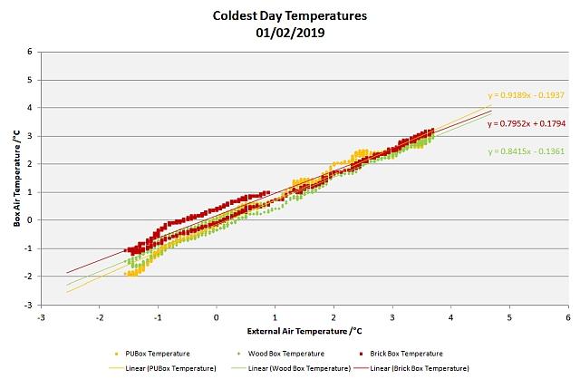

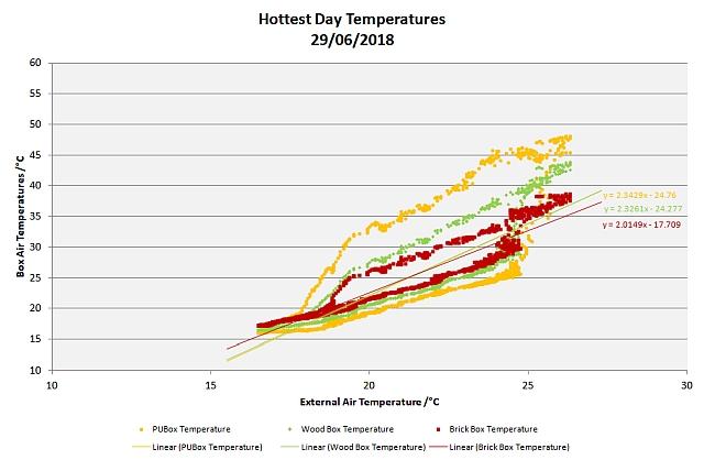

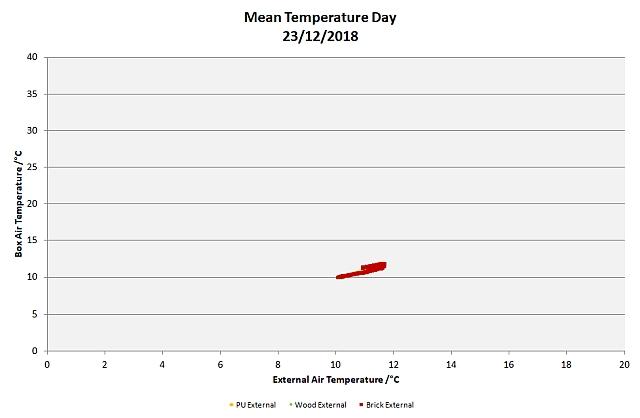

SteamyTea Posted August 4, 2019 Share Posted August 4, 2019 7 minutes ago, ProDave said: There is no such thing as "thermal mass" I have been running an experiment for over a year now, just three boxes, exposed to the weather, with the same volume of different masses in them. This does not model a house, but shows that during cold spells, there is effectively no difference. Hot spells are a bit different. Mean temperature days are so variable that it is hard to draw a conclusion from temperature differences alone. Below are the coldest day and the hottest day charts. Lots of variation on the hottest day. 1 Link to comment Share on other sites More sharing options...

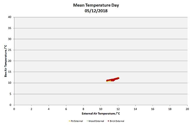

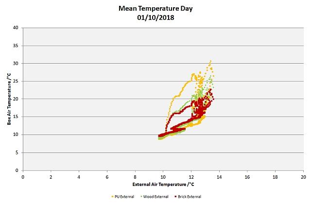

SteamyTea Posted August 4, 2019 Share Posted August 4, 2019 Just to highlight the variation of 'normal days'. The charts below all have the same external air mean temperature, within 0.1°C. I shall restate, this is not modelling a house. Link to comment Share on other sites More sharing options...
