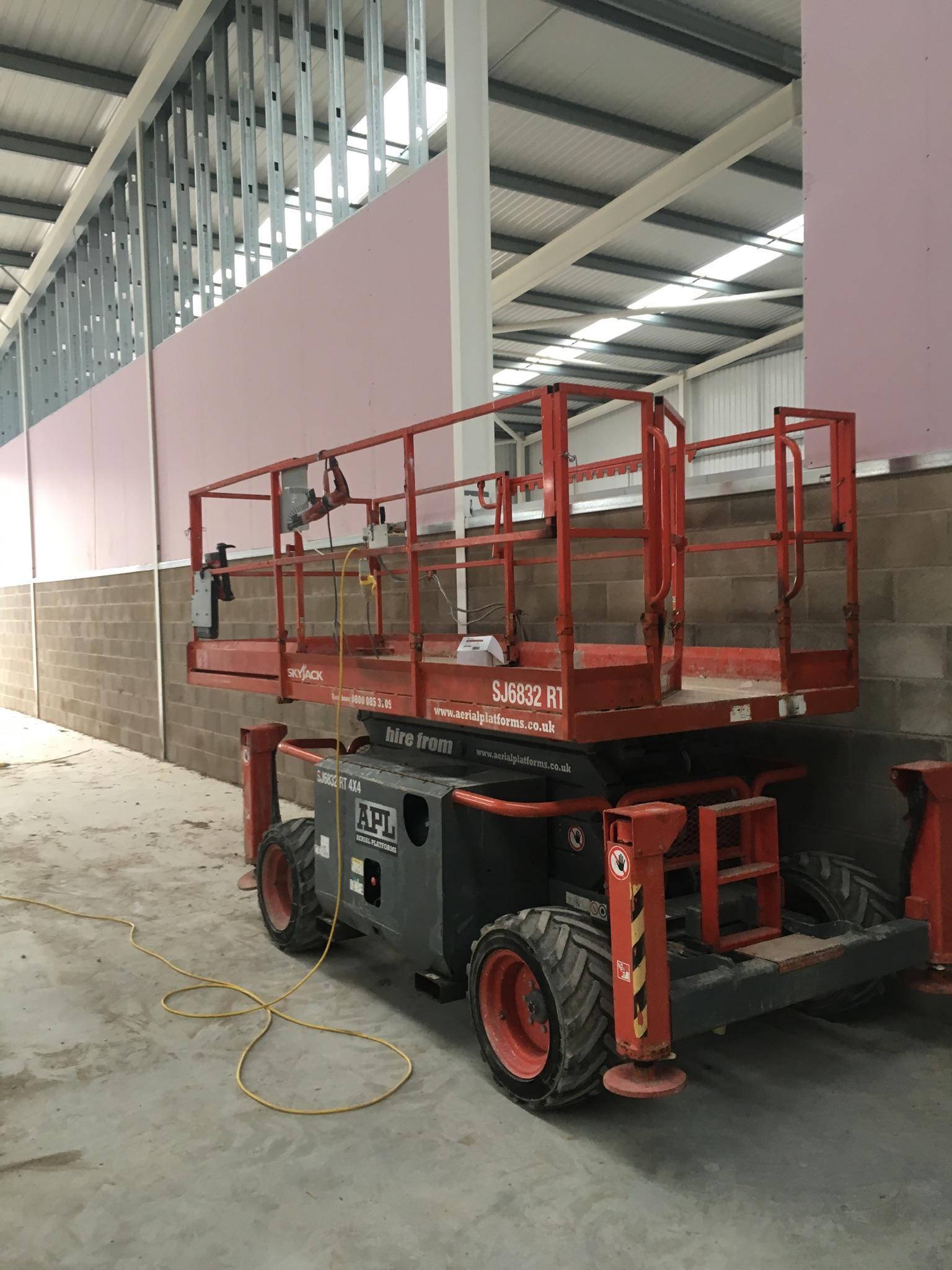

nod Posted July 23, 2019 Share Posted July 23, 2019 Just now, nod said: Just two Ian A lot the work I do is party walls Factories offices The sound will carry through dense material The middle unit is engineering lots of noice and radios The other two are offices staff So sound could easy become an issue Link to comment Share on other sites More sharing options...

nod Posted July 23, 2019 Share Posted July 23, 2019 1 minute ago, Oz07 said: @nod so 150mm total though exc plasterboard. 150 plus single layer of 15 sound block 180 in total 100 mil acoustic quilt Link to comment Share on other sites More sharing options...
nod Posted July 23, 2019 Share Posted July 23, 2019 18 minutes ago, Oz07 said: Yeh what about 4" sole and header with 3" studs art staggered 300mm centres. Would this give a superior sound resistance? Can't put nogs in centre I suppose with this way Ideally you would have two independent walls so thy sound doesn’t travel You can brace across the middle using mdf straps Link to comment Share on other sites More sharing options...
