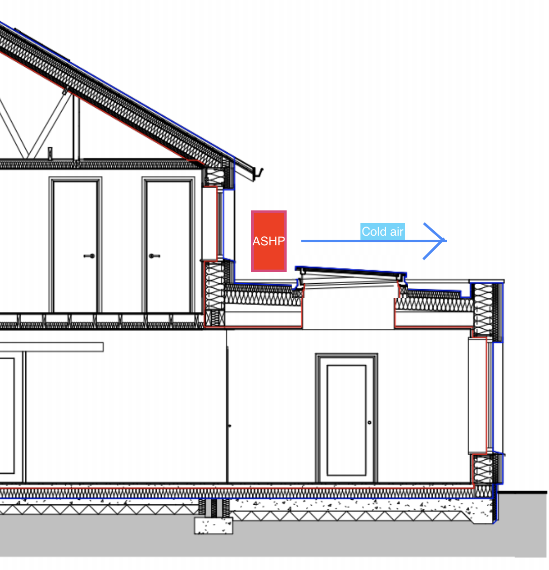

joe90 Posted July 24, 2019 Posted July 24, 2019 Quite hot here yesterday, my son and I stood by the ASHP whilst it was heating the DHW getting a blast of nice cold air!!!, he remarked “was it possible to duct that cold air back into the house “?. I may look into cooling the slab (after I get the last 90% of work done) but do wonder how often, for our location, it would be needed. These are the temps we go on holiday abroad for!!,!

joth Posted July 24, 2019 Posted July 24, 2019 (edited) 2 hours ago, joe90 said: Quite hot here yesterday, my son and I stood by the ASHP whilst it was heating the DHW getting a blast of nice cold air!!!, he remarked “was it possible to duct that cold air back into the house “?. I may look into cooling the slab (after I get the last 90% of work done) but do wonder how often, for our location, it would be needed. These are the temps we go on holiday abroad for!!,! Your son and I were in well tune this morning then! I was thinking about the Ed's comment (re. pity not to capture the ejected heat energy to warm DHW_ and realized in summer this is marginal gain as the building needs to be a "net exporter" of heat energy to outside regardless, to battle against overheating. So rather than focus on capturing the wasted heat export (which low grade energy anyway) and bring back into the hot water tank, wouldn't it be more efficient overall to focus on capturing the wasted cold-air export when running the ASHP to heat DHW. Cue son-of-Joe. My proposed solution [see quick sketch attached] that requires no new moving parts, is simply to relocate the ASHP from ground-level up onto the flat roof at the rear of the house. We have 2 rooflights planned there, if I make one of them open "backwards" with the aperture pointed towards the ASHP, then it's a simply a case of cranking that open when the ASHP is in heat mode and the indoors is overtemperature. A 1.5m x 1m long rooflight with 25 degree opening will give 1m x 0.7m opening, enough to capture a good portion of the draft, and being cold it'll naturally drop down into the opening anyway. Downsides are numerous: the noise and possible mess of having it on the flat roof there, right overhead the dining area, and outside a bedroom window. Probably also needs the flat roof re-specified to be safely walkable, for servicing. But on the flip side, it would make the pipe runs to the services room way shorter and simpler (no need to go under the slab). Realistically, unlikely I'll consider it further, but always fun to think about further optimizations! Edited July 24, 2019 by joth 1
