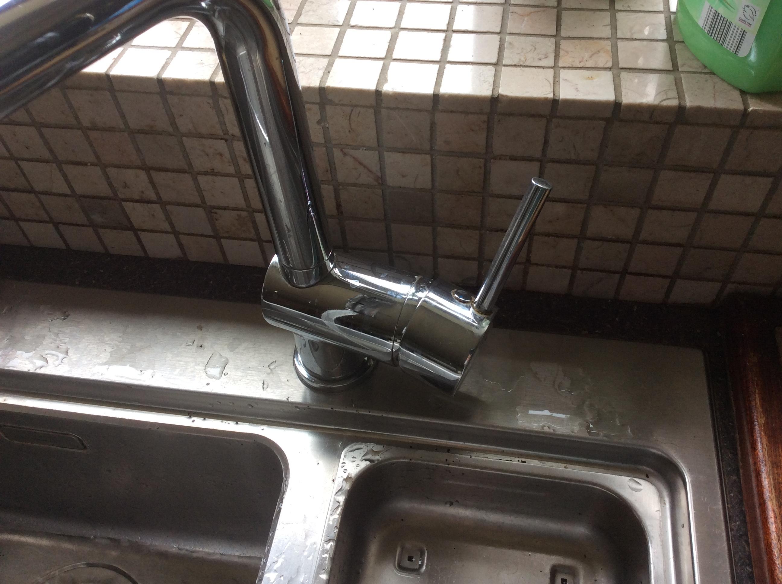

puntloos Posted July 17, 2019 Share Posted July 17, 2019 (edited) Hi all, As anyone tasked with cleaning knows - faucet bases are always hard to clean, especially in limescale-y areas. One ‘obvious’ solution is wall mounting, even though it seems to be a rare approach - very few of the nicer, more feature rich faucets (e.g. with the extendable spray head, let alone quooker-style ones) exist in wall-mounted versions. - http://worldwide.deltafaucet.com/kitchen/details/44004-sq.html ($190) is so far my best find, although not even sure I could easily source them, they’re some indian brand… Anyone have any thoughts on wall-mounting? Is this a good idea? Am I missing any obvious downsides? Any specific faucets that you chose? (link?) To be clear: yes I very much want a ‘kitchen style’ faucet in all my bathrooms too, I have no idea why teensy faucets that force you into weird angles to try to get water on your hands, always at the risk of touching the dirty washbasin are so common.. I want water to comfortably drop in the center of the basin.. Edited July 17, 2019 by puntloos Link to comment Share on other sites More sharing options...
lizzie Posted July 17, 2019 Share Posted July 17, 2019 I had them in previous bathroom its just a style thing. Have seen them in kitchens again a style thing. Think you probably need to look at higher end European brands for more choice. Why on earth would anyone let their fitting get into the state of the one in your picture.....have they never heard of viakal once in a while. Link to comment Share on other sites More sharing options...
jack Posted July 17, 2019 Share Posted July 17, 2019 We wanted wall-mounted in our kitchen, but as you've noticed, they're very unusual. We gave up in the end. We have wall-mounted in our bathrooms. I'd have mounted them a bit higher to give more space underneath for your hands, but otherwise can recommend them as being easy to keep clean. Link to comment Share on other sites More sharing options...
puntloos Posted July 17, 2019 Author Share Posted July 17, 2019 1 minute ago, lizzie said: just a style thing. Mm.. well, clearly there’s some practical benefits, not saying they’re worth it and/or if they are outweighed by other factors(incl price..) 1 minute ago, lizzie said: Why on earth would anyone let their fitting get into the state of the one in your picture.....have they never heard of viakal once in a while. Well, in our current situation viakal is too aggressive for our natural material worktop… Link to comment Share on other sites More sharing options...
lizzie Posted July 17, 2019 Share Posted July 17, 2019 (edited) @puntloos I have had granite but still managed a careful wipe with a limescale cleaner...in this house I have granite too but with the infamous Halcyon device scale is different and wipes away with a microfibre cloth and my apologies I didn't realise it was your own tap thought it was a random pic from internet Edited July 17, 2019 by lizzie Link to comment Share on other sites More sharing options...
jack Posted July 17, 2019 Share Posted July 17, 2019 1 minute ago, puntloos said: Mm.. well, clearly there’s some practical benefits, not saying they’re worth it and/or if they are outweighed by other factors(incl price..) Bear in mind it's the surrounding mounting area that's easier to keep clean, as much as the taps themselves. You don't get pooled water below the taps from wet hands turning them off, for example. Link to comment Share on other sites More sharing options...

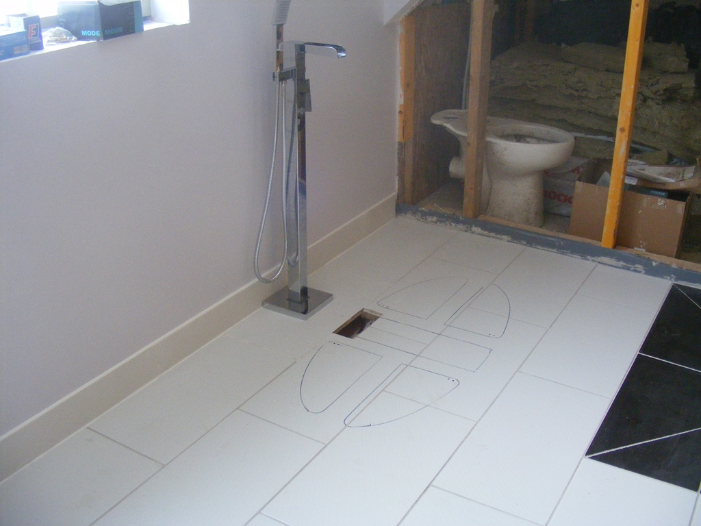

ProDave Posted July 17, 2019 Share Posted July 17, 2019 Slightly related, I fitted a floor standing bath filler. Fitted because I did not want ANY reason to ever have to lift the free standing bath out of it's surround, Link to comment Share on other sites More sharing options...

puntloos Posted July 18, 2019 Author Share Posted July 18, 2019 On 17/07/2019 at 18:28, ProDave said: Slightly related, I fitted a floor standing bath filler. Fitted because I did not want ANY reason to ever have to lift the free standing bath out of it's surround, Newbie question I'm sure but can you explain? Why would a non-freestanding cause you to (possibly) have to lift a bath.. and if so is that a big deal? Link to comment Share on other sites More sharing options...
Ferdinand Posted July 19, 2019 Share Posted July 19, 2019 7 hours ago, puntloos said: Newbie question I'm sure but can you explain? Why would a non-freestanding cause you to (possibly) have to lift a bath.. and if so is that a big deal? I think that would be because the plumbing and gubbins is no longer under the bath. Whilst with a normal bath you remove the front panel and squirm like an eel (this is why some plumbers do Yoga), stand-alone baths are supposed to be either steel ponds-on-legs with Lions’ Feet, or smooth and enclosed like a 30s modernist item (or because someone has sensibly been informed that SWMBO will NOT be dusting The lions’ feet). In the latter case you would probably need to lift it out. F Link to comment Share on other sites More sharing options...

ProDave Posted July 19, 2019 Share Posted July 19, 2019 10 hours ago, puntloos said: Newbie question I'm sure but can you explain? Why would a non-freestanding cause you to (possibly) have to lift a bath.. and if so is that a big deal? It's a free standing bath that is lowered down into a matching surround. If you install it to MI's you would drill one side for taps, fir the taps with long flexi's and use a horrible (supplied with the bath) flexi waste so you could lift the bath up. If ever the taps went wrong and needed replacement or the flexi hoses failed you would have to lift the bath out of it's surround to fix it. I so much hated that flexi waste that I chose not to use it. I used a top access trap and solid waste, lowered the bath plus waste in and made the final solid wste connection from below before the utility room ceiling was put up. If I ever did have to lift the bath out now I would have to cut a trap in the utility ceiling to access that joint. With the floor standing filler, and a top access trap, there should be no need for the bath to ever be removed so that makes use of the solid waste rather than the horrible flexi thing possible. Link to comment Share on other sites More sharing options...
ProDave Posted July 19, 2019 Share Posted July 19, 2019 26 minutes ago, puntloos said: Not a big fan of those freestanding baths anyway, admittedly it looks fairly fancy but it doesn't seem very practical (where do you store your glass of wine, inquiring minds want to know..) etc. On the flat side where one would normally have drilled to fit a set of taps. Now conveniently left as a flat undrilled surface for your wine glass, bar of soap etc. Link to comment Share on other sites More sharing options...
