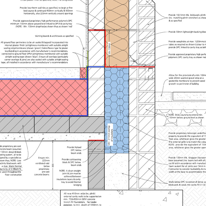

Patrick Posted July 14, 2019 Posted July 14, 2019 I was wondering what you think about insulating under a block and beam floor. Building control specifies approx 200mm ventilated gap under a suspended block and beam floor. I am quite unsure of why this is. Apart from expanding of clay floor underneath, I can't quite see a reason (with suspended timber, it would be air circulation, but for block and beam?) Would it be possible to fill the space underneath with insulation. For example perlite, or some other no moisture/rot sensitive materials, maybe eps in granulated form. What would be the problems that could arise from it? Anybody got some experience in doing this?
bassanclan Posted July 14, 2019 Posted July 14, 2019 The problem is the manufacturer also states a minimum amount of air clearance/circulation so any warranty would be invalidated.

scottishjohn Posted July 15, 2019 Posted July 15, 2019 I think the point is that IF it did get wet underneath --flood -etc then you need an air flow to dry it out or you would get mold--so it needs to be hollow + vented or SOLID like concrete
Jeremy Harris Posted July 15, 2019 Posted July 15, 2019 I'm aware of two methods that have been tried, blown-in EPS beads and poured in Leca (fired clay beads). I believe that Leca may be approved for use under a suspended floor, at least a beam and block one where there isn't really any risk of mould growth. 1

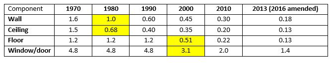

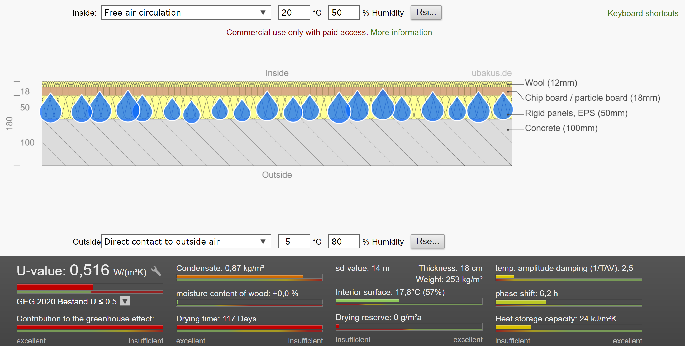

Radian Posted December 19, 2022 Posted December 19, 2022 This thread went quiet a long time ago but the issue has cropped up again recently. There must be an awful lot of houses with suspended concrete B & B floors that have just experienced -10oC rushing around beneath. To meet building regs in the late 90's our house had just 50mm of XPS sheet topped with chipboard flooring: A U-value of 0.5W/(m²K) (0.6 without the carpet 🙄) is not very clever at all. But it exceeded the minimum requirement of 1.2 at the time: Those numbers look criminal now. So what to do?
Radian Posted December 19, 2022 Posted December 19, 2022 The obvious answer of lifting all the carpets, pulling up the chipboard and replacing the EPS with 50mm PUR brings us down to 0.372 W/(m²K) Simply not worth the trouble and the 0.144 W/(m²K) saving will never, ever, cover the cost of the materials let alone the whole job. There's also no prospect of raising the floor level at all. Now, pumping in 300mm of EPS beads (the average depth of the void below floors here) would achieve something like 0.09 W/(m²K) which is well into passive house territory. Apart from the addition of virtually unlimited amounts of insulation in the loft, there's no other single improvement that I can think of that would make such a big difference. I also suspect that there is no XPS in the floor makeup for the kitchen/utility rooms as these were screeded for tiling, and there's not enough depth - maybe 25mm XPS and 43mm screed but I very much doubt it. Insulating under these rooms alone could make a huge difference (the kitchen and utility room have always baffled me as to why they're so cold).
