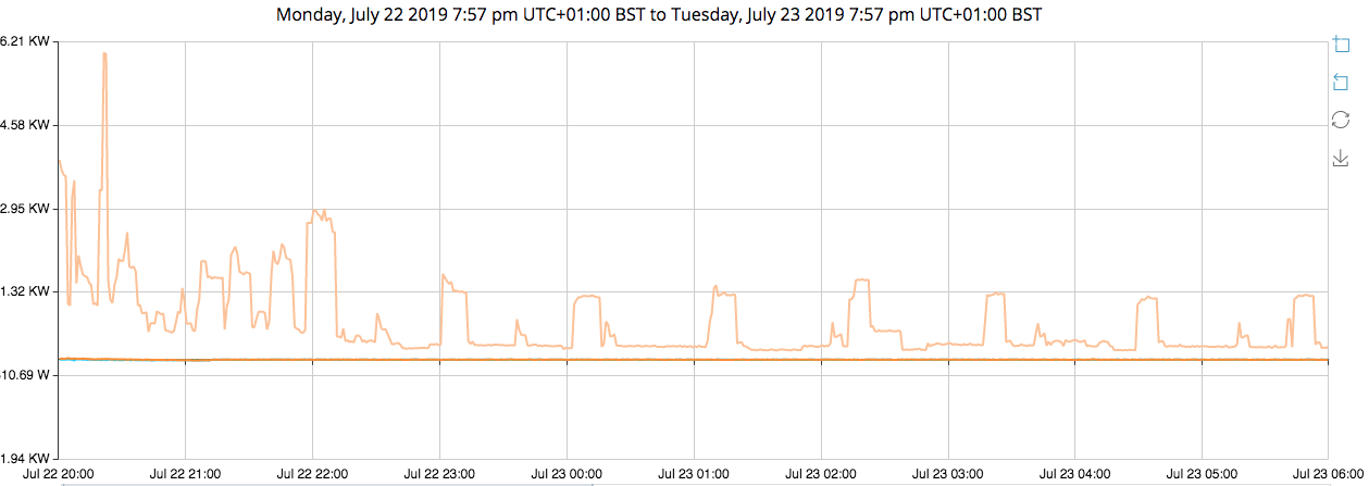

Well done @JSHarris.. just in time too!!
Even in my leaky old house it only runs the compressor for 10-15mins every hour or so to maintain temperature...we turn ours on around 5-6pm so that it's nice and cold come bedtime and also the noisiest bit is over to give the neighbours some peace if they have their windows open.
(Orange line is power household power draw)
