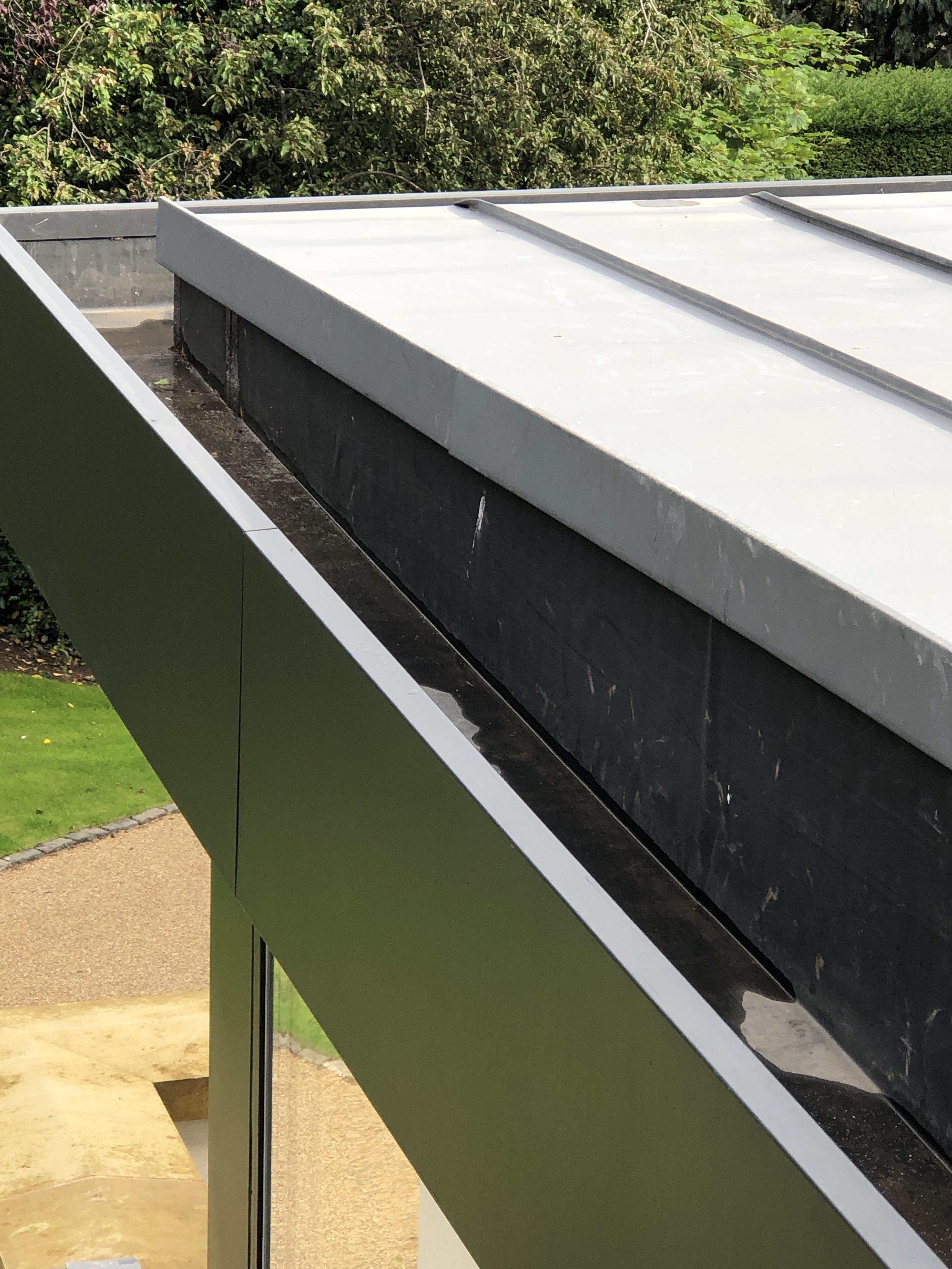

AliG Posted June 29, 2019 Author Posted June 29, 2019 (edited) At the front we have a flat roof with a box gutter that doesn't have downpipes it just exits onto the roof. At the back it is a gutter that exits onto the roof and I think we could add a small downpipe. I would have to replace around £1500 pounds worth of guttering so was hoping for a cheaper fix. Edited June 29, 2019 by AliG
PeterW Posted June 29, 2019 Posted June 29, 2019 2 minutes ago, AliG said: At the front we have a flat roof with a box gutter that doesn't have downpipes it just exits onto the roof. At the back it is a gutter that exits onto the roof and I think we could add a small downpipe. I would have to replace around £1500 pounds worth of guttering so was hoping for a cheaper fix. Got a photo of the outlet from the box gutter ..?? Could possibly do some diversion on it. How many downpipes on the main run of gutter that is overflowing ..?? And what’s it made of ..? No need to replace everything just yet - always ways of making this work ..!!
MikeSharp01 Posted June 29, 2019 Posted June 29, 2019 Can you fit the outlet in the center of the run? As this increases the capacity greatly - can't recall the figures but you can look it up on the floplast website.
AliG Posted June 29, 2019 Author Posted June 29, 2019 In both cases the run is around 10m of 125mm linden guttering with a downpipe at each end. Cant add new downpipes but I think the box gutter could be directed onto the cashing and not the roof. Is that hole a standard size running into the down pipe or can it be made bigger?

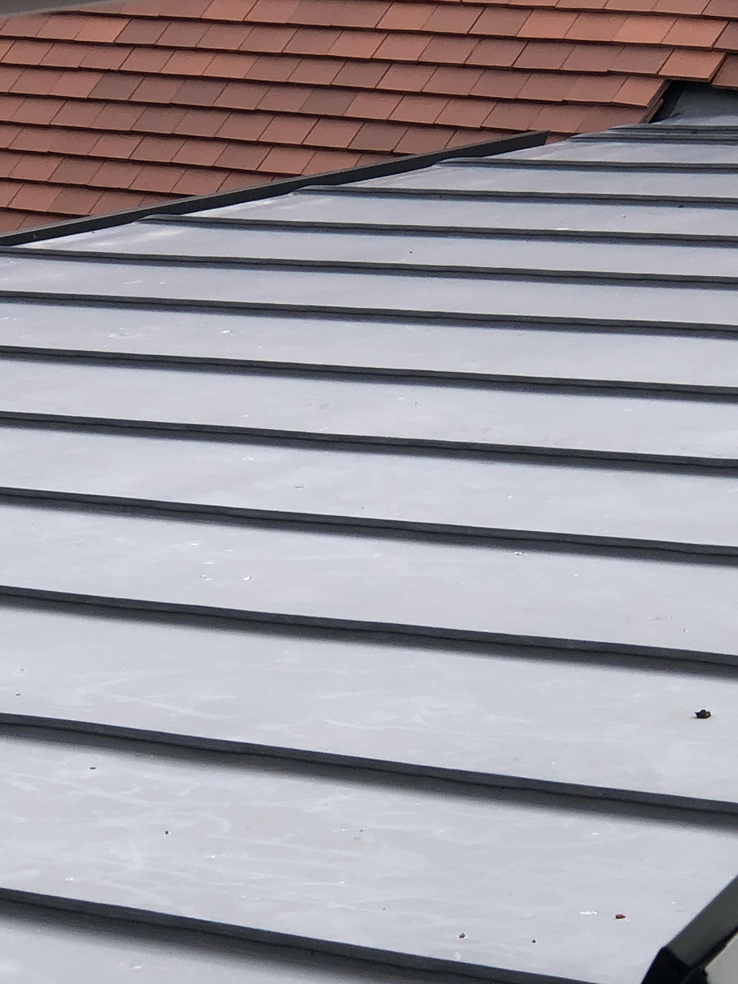

ProDave Posted June 29, 2019 Posted June 29, 2019 Only just saw the video. Right at the start, what is that mass of water running down the roof about 4 tiles in from the end? Is there some form of valley further up putting a lot of water onto one point?
Declan52 Posted June 29, 2019 Posted June 29, 2019 You could move the brackets up slightly to try to catch the main flow rushing off the roof. Can you get to the outlet of the box gutter to reduce its opening so there isn't as much rushing down the roof but still letting enough through do it doesn't back up. A pic of where that comes onto the roof would help.
AliG Posted June 29, 2019 Author Posted June 29, 2019 (edited) At the pub. Will get a picture of the box gutter later. I suspect certainly that a box gutter is easier to alter. We have around 70sq metres of zinc roof above the hall with a wide deep box gutter around it that drains into the roof at each end. That’s where the mass of water is coming from. The gutter is enormous so I reckon you could easily slow down the exit of water with much risk. Edited June 29, 2019 by AliG

AliG Posted June 30, 2019 Author Posted June 30, 2019 Box gutter pics, I cannot get a good pic of the end where the water is running off onto the roof so I also took a pic of the other side. The first video is the front of the house above the garage, the second video is the back above the pool. I had a look at the holes in the gutter. The hole at the front is way larger than the hole at the back. Despite having to cope with more water that gutter was not overflowing. So that is easily fixed, the builder can cut larger holes. Indeed one reason I checked was the gutters had just been cleaned and the guy who did it said that he thought the holes were too small. I do think that something to slow the exit of water at the end of the box gutter would help. The box gutter is so large that it never appears to have that much water in it so you can allow it to back up. I am thinking some kind of plate across the gutter with a small gap below it so that water runs out with a maximum rate but if it backs up too much it would go over the top of the plate. At the back of the house the water coming down the roof is from the end of the gutter above. One end of the gutter has a downpipe and the other end is open onto the roof. It might be necessary to put a downpipe onto the end or something to direct the water across the roof and not straight down. I think we can maybe slightly pull the end of the gutters out to catch more water also. I notice at the back the grout between the paving slabs has gone in the area below the gutter where the water hits the ground so it has been happening before yesterday.
