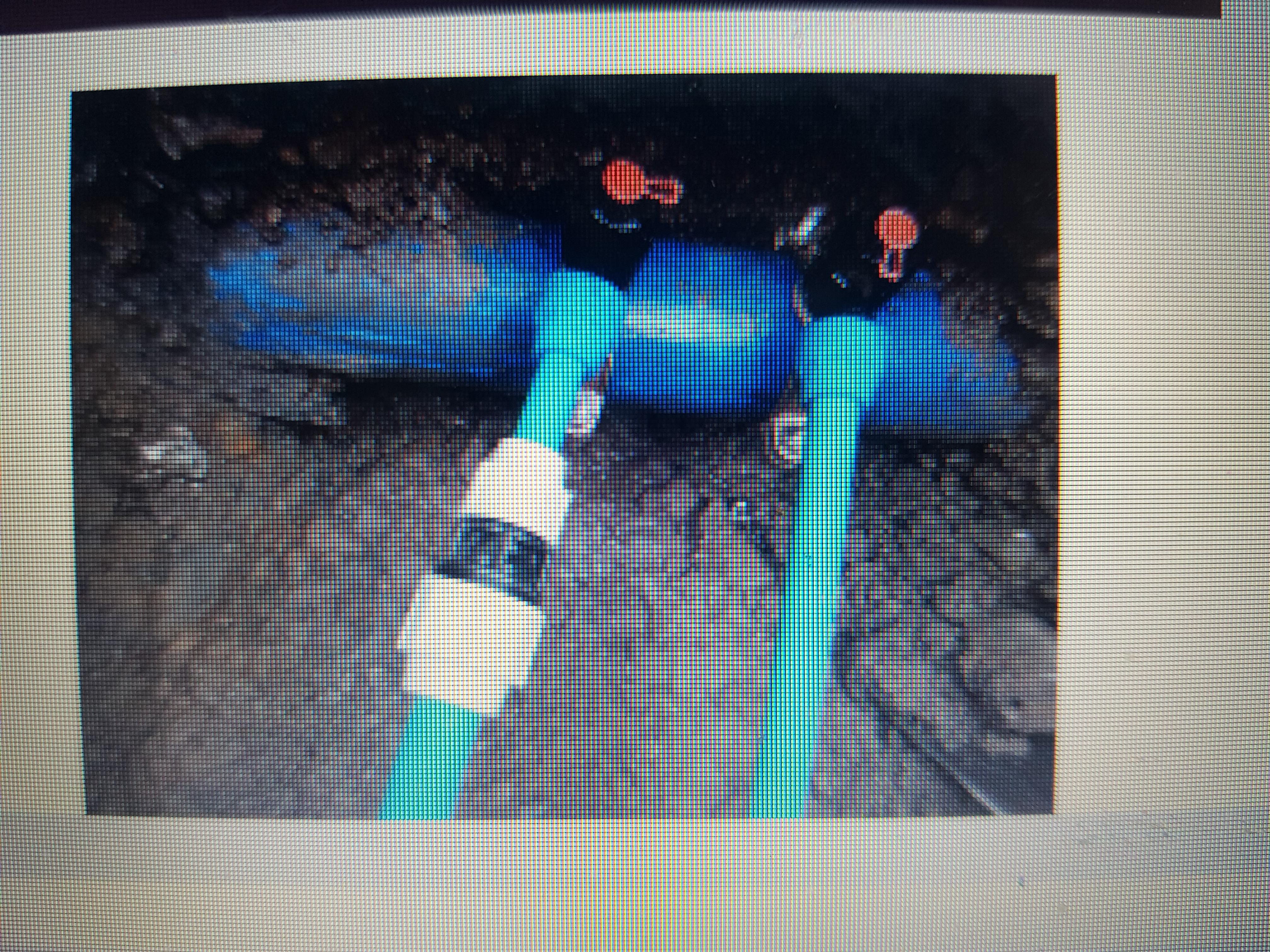

Pete Posted June 25, 2019 Author Share Posted June 25, 2019 That's my new connection on the left, the other is my neighbour also building his own house. My nephew (who used to work for UU) asked a senior man at UU today about our connection photo and his immediate response was the connections are to close and that our connection should have been 32mm straight from the main and he offered to contact a hydraulics engineer to work out our pressure loss which may come in handy when we see what UU are going to do about it. Link to comment Share on other sites More sharing options...

Conor Posted June 26, 2019 Share Posted June 26, 2019 Yep, you've paid for a 32mm service but been given a 25mm service. In reality the pressure loss over that length will be minimal unless you are trying to fill a swimming pool..... But you did request and pay for a specific service, which they have failed to deliver. What has happened is the guys only had 25mm ferrules in the van and proceeded anyway saying they had the road open. The UU guy may be right regarding the closeness of the tappings, but as that is a modern PE main, it's not a concern. But again, they have to adhere to the standards. I'd outline the above comments and send back to UU requesting the connection is redone. Link to comment Share on other sites More sharing options...
