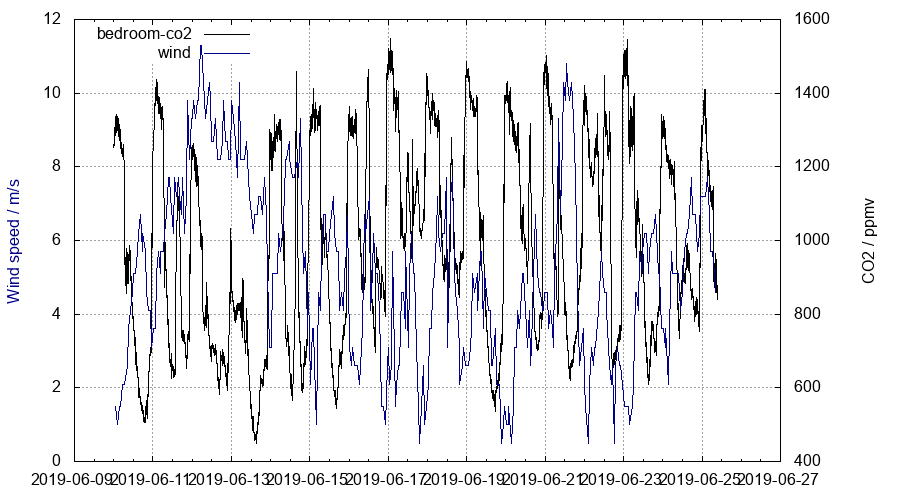

Bedroom CO₂ level (in the old house I'm staying in) and wind speed (at Wick airport, about 20 km away) for the last fortnight. I always leave the bedroom door ajar but otherwise make no effort to ventilate more than the house more than it does for itself. As you can see, roughly speaking the higher the wind speed the lower the overnight CO₂. I think with old houses if you didn't make a conscious effort to ventilate you at least got low CO₂ some of the time to recover, with a modern well-sealed home you probably don't get that much higher peak levels but you might well get them much more of the time which, it seems to me, might be more of a health issue.
5 minutes ago, SteamyTea said:
That is pretty impressive @Ed Davies,
Wonder if you can use a gas analyser and local wind speed as a proxy for air tightness.
Depends on how much heavy breathing is going on ?
