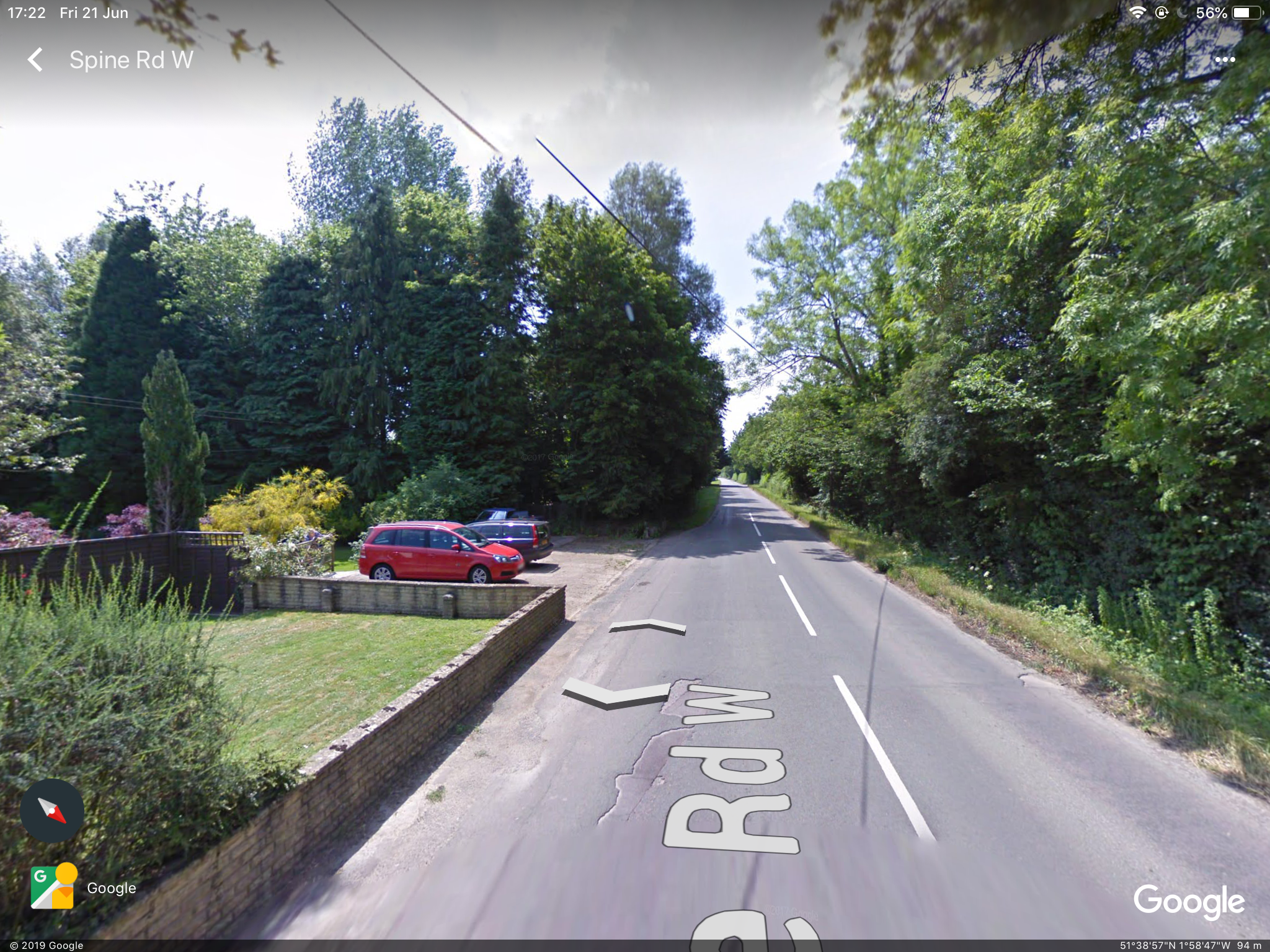

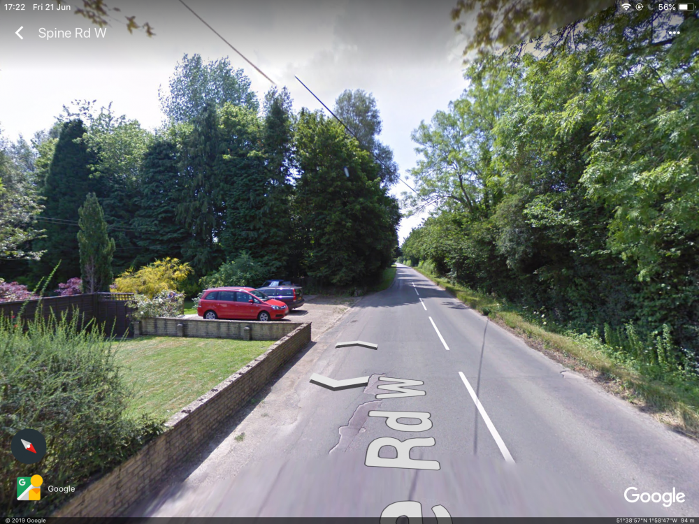

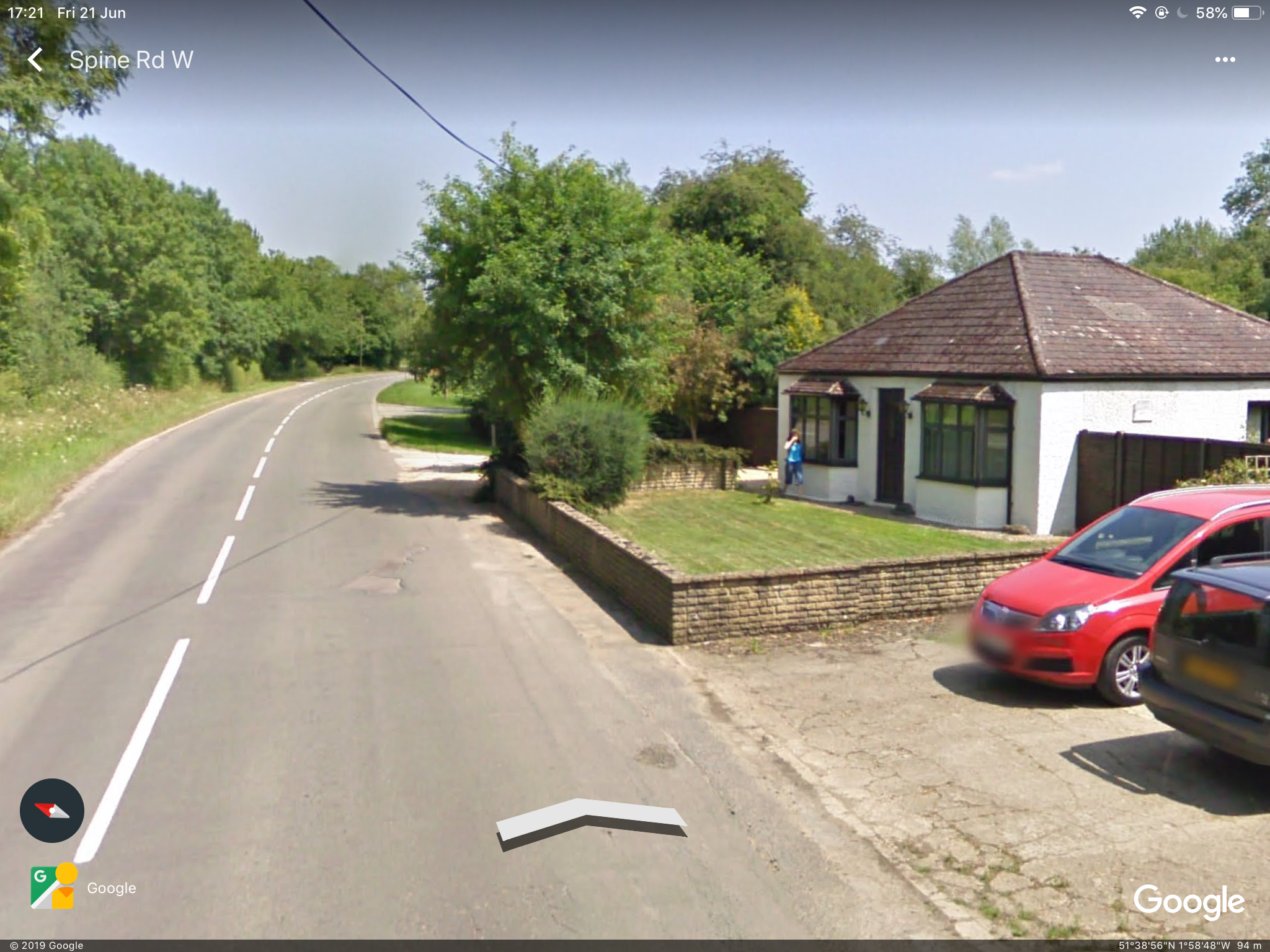

Russell griffiths Posted June 21, 2019 Share Posted June 21, 2019 Evening all. The house we live in at the moment whilst we build the new one, has a front garden with a fairly fast country road running past it. Now two years ago the view across the road was pleasant so we put up with a bit of traffic noise because of the nice view, however the view has changed as the landowner across the road planted a new hedge which is now 1.5m high so our view has gone, so we might as well try and cut down the road noise. What I would like to do is plant my own hedge on the inside of the low wall you can see in the pics. However this will really impede my neighbour getting out of her drive. Is there anything legally I need to look out for ?? am I allowed to plant what I want ?? FYI I hate her and couldn’t give a Monkey’s if she can see or not. As far as I’m concerned when her house was built they should have built in an adequate vision splay. ( this is something I used to do a lot of at work). FYI. Her house was built in my side garden by a previous owner who was a builder, so my front wall and her house where built at the same time, so he could have designed it any way he wanted. Are there any rules about planting a set distance from your boundaries she likes to go around bullying my other neighbour with verses from the high hedge act ( which I also know a lot about) i have looked through my house deeds and there are no restrictive covenants on anything I can see. Anybody have a view. Link to comment Share on other sites More sharing options...
ProDave Posted June 21, 2019 Share Posted June 21, 2019 I had some interesting discussions with Highways when I was sorting out the vsibility splay for my build. Initially the planners wanted me to "demonstrate control" over the area of the visibility splay but that would have meant having control over 2 neighbours front gardens. However the discussion with highways concluded that I did not need to demonstrate control as THEY had control, and if any neighbour plants anything that block my visibility, to contact them and they would arrange it's removal. It is not clear from the pictures but it look like from next doors entrance, your low wall is already set back from the edge of the road? Or is the neigbours entrance you are talking about where the red car is parked? You already have a bush right on the wall so I can't see a whole hedge would make any difference. Link to comment Share on other sites More sharing options...

Russell griffiths Posted June 21, 2019 Author Share Posted June 21, 2019 Ok bit more input, the neighbours drive in question is the one with the red car on it. Our front wall was actually built 3-4 feet in from the road edge regarding noise, that was badly worded, I’m more interested in cutting out the view of the passing cars. Regarding anything on our deeds, there is a covenant saying I cannot impede any visibility to the driveway of the property to the left of the White House, that’s ok as that’s our other place we are building now. There is a map in the deeds detailing an area that must have no structure over 2 feet high, this is on the exact opposite side to the corner I would like to plant in. Regarding having to disclose any past disputes to future buyers. ??? oh god it would be like a 50 page novel. Regarding selling, we believe (unless it all go pear shaped) that we won’t be selling. Link to comment Share on other sites More sharing options...
ProDave Posted June 21, 2019 Share Posted June 21, 2019 I would just do it. The trouble is, you really really don't want to be planting Leylandii But just about anything else is going to take some time before it is a useful hedge. Link to comment Share on other sites More sharing options...
Jeremy Harris Posted June 21, 2019 Share Posted June 21, 2019 Sounds as if you're OK to plant a hedge, from my interpretation of the planning rules. There's long been debates about what constitutes the "boundary with the highway" too, as in theory it would seem that a 1m high fence could be built on that boundary, a a 2m high one erected a couple of feet behind it, without breaching the requirement for planning consent. I've a feeling we discussed this a while ago, perhaps relating to @Bitpipe's front hedge? The driver's sight line referred to in the planning guidance relates primarily to the sight line from road junctions, not that from private drive ways. In general, unless there is a specific condition or covenant that applies, there is no legal obligation for anyone to provide a clear sight line from a neighbours drive. If there was then about 90% or more of the drives in our village would have a major problem, including ours and our neighbours! Link to comment Share on other sites More sharing options...
ProDave Posted June 21, 2019 Share Posted June 21, 2019 The law on fences and boundaries seems to have been relaxed. Now it just states "on a boundary" Before, it used to be anything between the building line and the highway could only be 1M high. so previously any fence, even one 6" in front of the house over 1M would need PP. Now it is a very grey area. If the wall was built 3-4 feed from the road (and the road surface now seems to have crept up to the wall) is it the case that your "boundary" is 3-4 feet in front of the wall? If so it is now arguable that putting a 2M high fence just behind the wall is not "on the boundary" I might be inclined to put up a fence. If challenged by planning, get them to give a definitive answer how far back you have to put it to make it "not on the boundary" and move it to where they say. Link to comment Share on other sites More sharing options...
