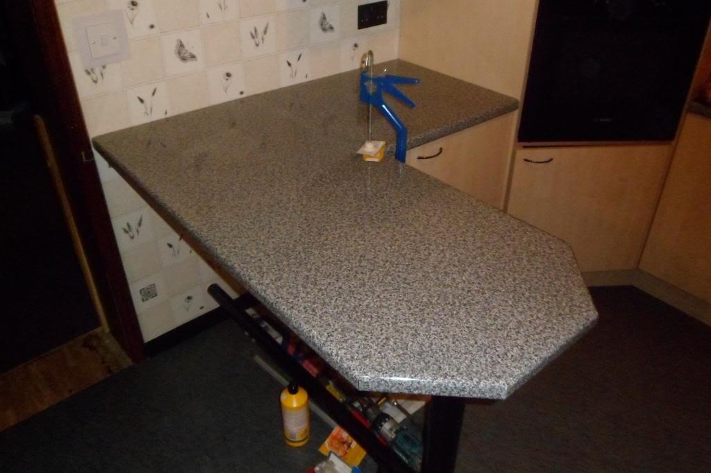

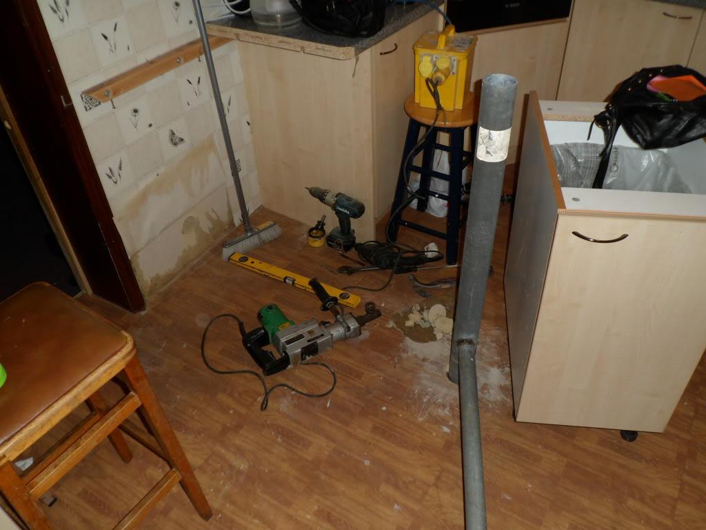

Onoff Posted November 19, 2019 Share Posted November 19, 2019 I cored a hole in the floor slab for my breakfast bar / island leg: One day this'll all go. Bloody kitchen floor is about 5" higher than it should be. Link to comment Share on other sites More sharing options...
