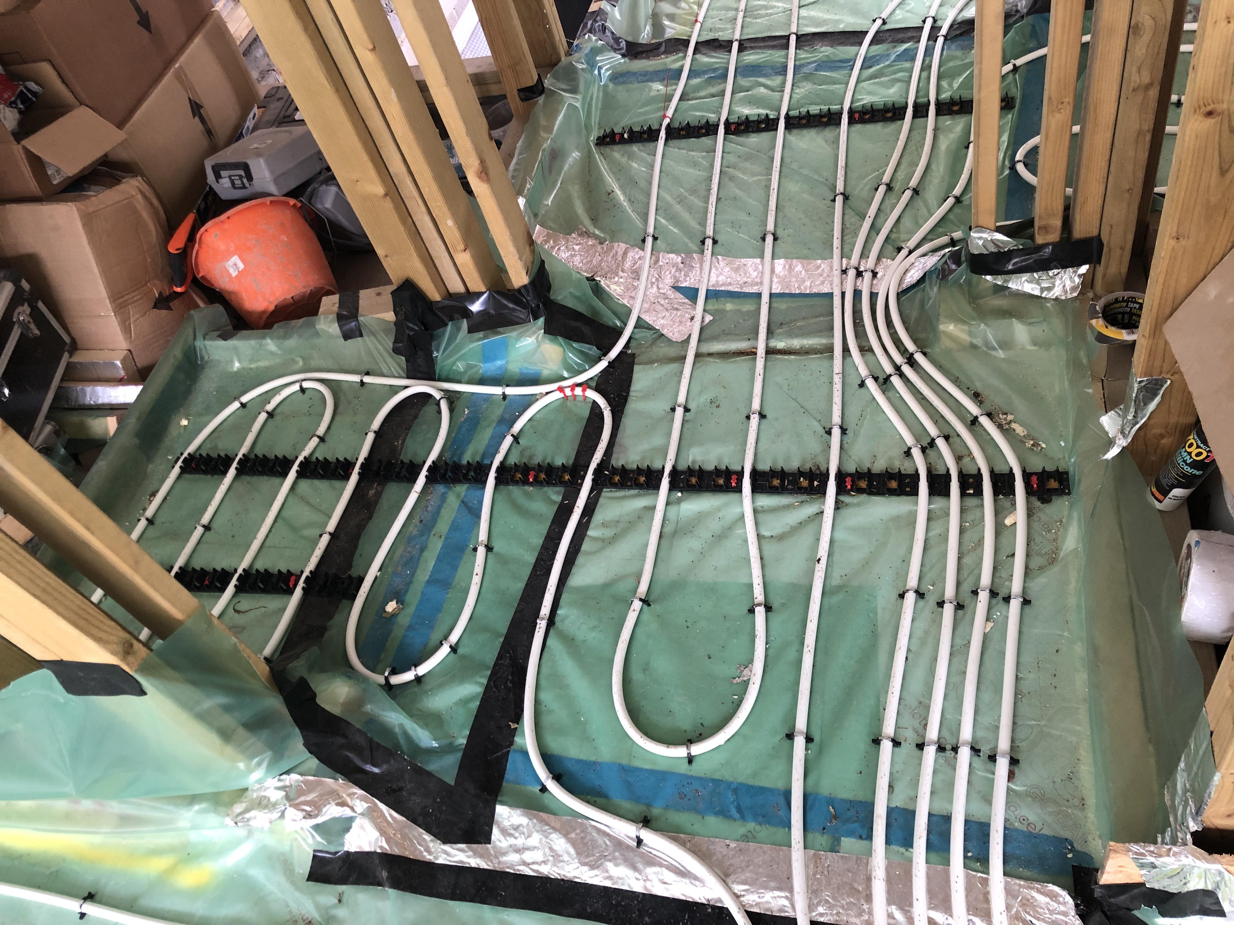

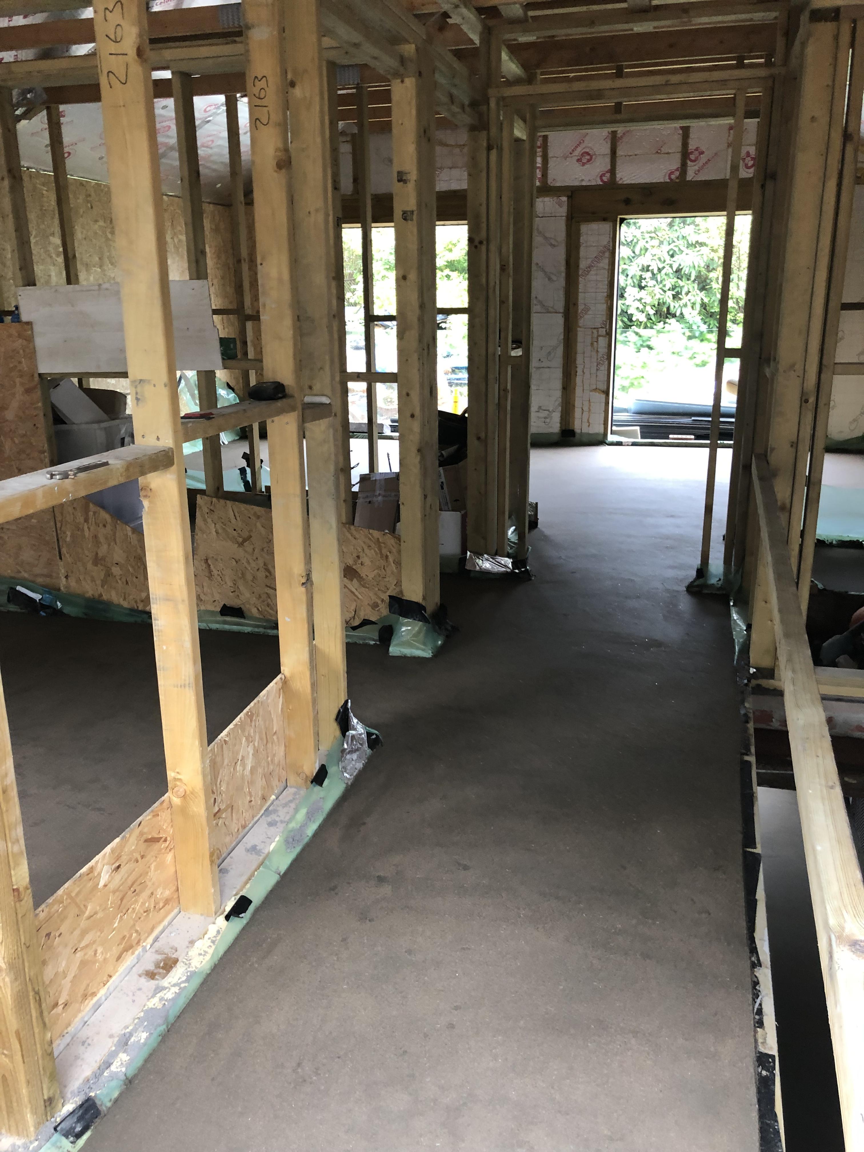

Pocster Posted June 13, 2019 Share Posted June 13, 2019 (edited) Hey all A nice simple question ! Once I had got all the ufh pipes in I attached zip ties at strategic points to stick up through the screed . Undoubtedly these zip ties will eventually snap . As it’s a sand / cement screed can I just paint lines with paint ? . I don’t want to put something on the dried screed that will prevent / mess up the tile adhesive . Some photos of pipes !! screeders there today . “ we won’t block the lane mate “ .... ?? Edited June 13, 2019 by pocster 1 Link to comment Share on other sites More sharing options...
Mr Punter Posted June 13, 2019 Share Posted June 13, 2019 I can never work out why UFH pipe runs always have a very congested hot 'corridor'. In your second pic there seems to be 7 pipes in 600mm. It looks possible to alter the design quite easily but maybe nobody can be bothered. Link to comment Share on other sites More sharing options...
Pocster Posted June 13, 2019 Author Share Posted June 13, 2019 44 minutes ago, Mr Punter said: I can never work out why UFH pipe runs always have a very congested hot 'corridor'. In your second pic there seems to be 7 pipes in 600mm. It looks possible to alter the design quite easily but maybe nobody can be bothered. Erm ; all covered in screed now .? Link to comment Share on other sites More sharing options...
joe90 Posted June 13, 2019 Share Posted June 13, 2019 42 minutes ago, Mr Punter said: I can never work out why UFH pipe runs always have a very congested hot 'corridor'. In your second pic there seems to be 7 pipes in 600mm. It looks possible to alter the design quite easily but maybe nobody can be bothered. Ours was designed with all pipes in doorways and I asked on here why I could not run pipes through walls to save hot spots, reaction was why not. It saved mtrs of pipe runs, I ran pipes in insulation through the walls and it made it easier to install. 1 Link to comment Share on other sites More sharing options...
Pocster Posted June 13, 2019 Author Share Posted June 13, 2019 (edited) 6 minutes ago, joe90 said: Ours was designed with all pipes in doorways and I asked on here why I could not run pipes through walls to save hot spots, reaction was why not. It saved mtrs of pipe runs, I ran pipes in insulation through the walls and it made it easier to install. That area is I think 3 zones . So it’s the return / flow for each zone . Needless to say this was the supplied design . Actually I got that wrong . That ‘clump’ of pipes are running back to the manifold which was behind me . Edited June 13, 2019 by pocster Link to comment Share on other sites More sharing options...

joe90 Posted June 13, 2019 Share Posted June 13, 2019 22 minutes ago, pocster said: That area is I think 3 zones . Yes, mine was flow and return pipes for multiple zones to/from the manifold but easier to drill the walls and run more direct. Link to comment Share on other sites More sharing options...
Pocster Posted June 13, 2019 Author Share Posted June 13, 2019 (edited) 1 hour ago, Conor said: Noob question, why do you need to mark on the pipe locations? Are you planning on drilling in to the screed at some point? Well ! My future staircase might land somewhere and need bolting to the floor . Built in wardrobes might need a floor fixing . Kitchen units probably won’t but nice to know where the pipes are . You never know !!!! Edited June 13, 2019 by pocster Link to comment Share on other sites More sharing options...

Pocster Posted June 14, 2019 Author Share Posted June 14, 2019 39 minutes ago, Conor said: You could have taken a load of photos and used augmented reality app! So obvious.... Lol i did take loads of photos with a tape measure in the floor - just in case said plan fails Link to comment Share on other sites More sharing options...

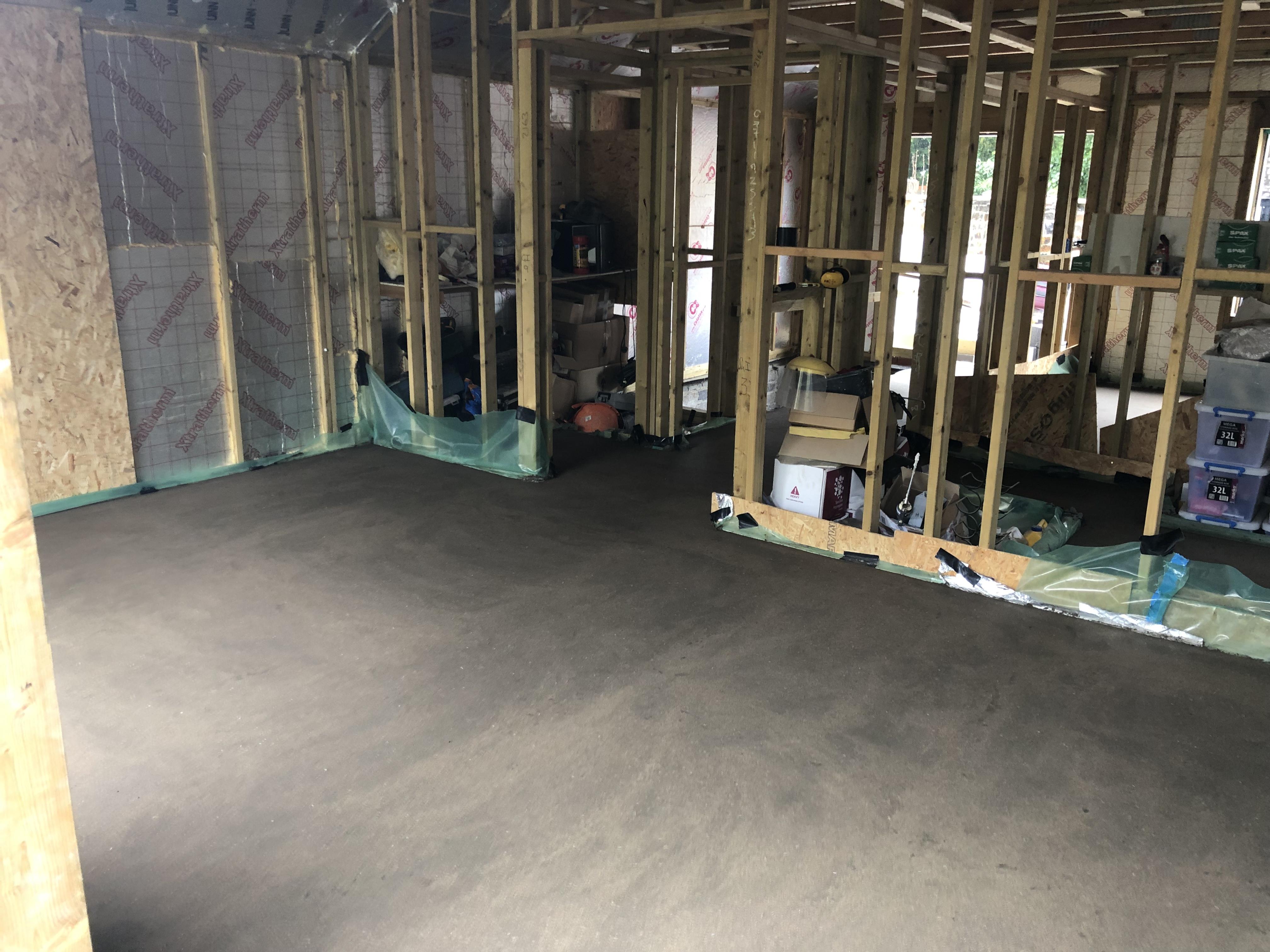

Pocster Posted June 14, 2019 Author Share Posted June 14, 2019 Here yo go @Onoff cant walk on it . But looks spot on ! Shame every trade busts my architecturally eclectic staircase ! . They must all be fatter than me . 1 Link to comment Share on other sites More sharing options...
Pocster Posted June 14, 2019 Author Share Posted June 14, 2019 Assume I cut the polythene around the edges - it has no purpose now ? Link to comment Share on other sites More sharing options...
