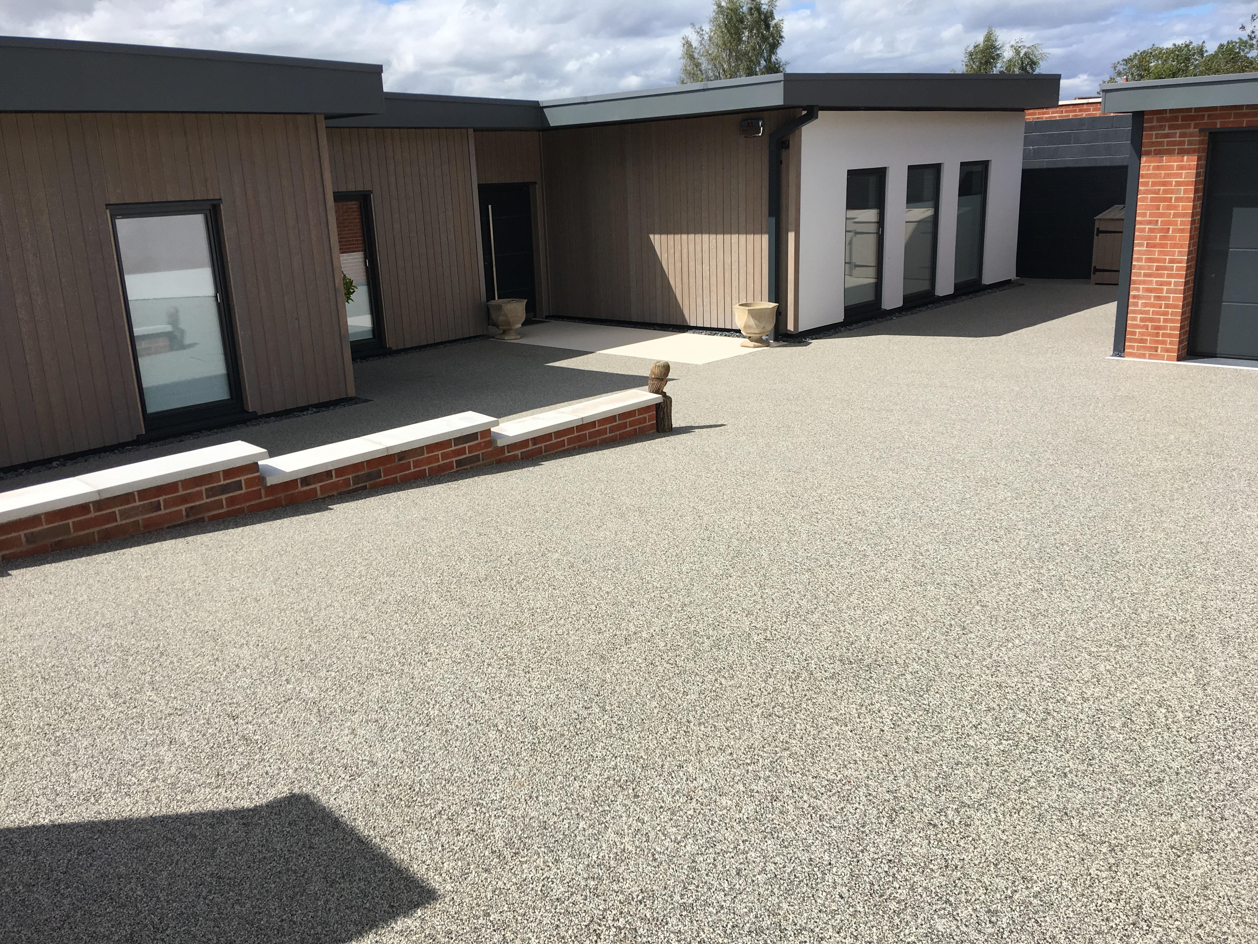

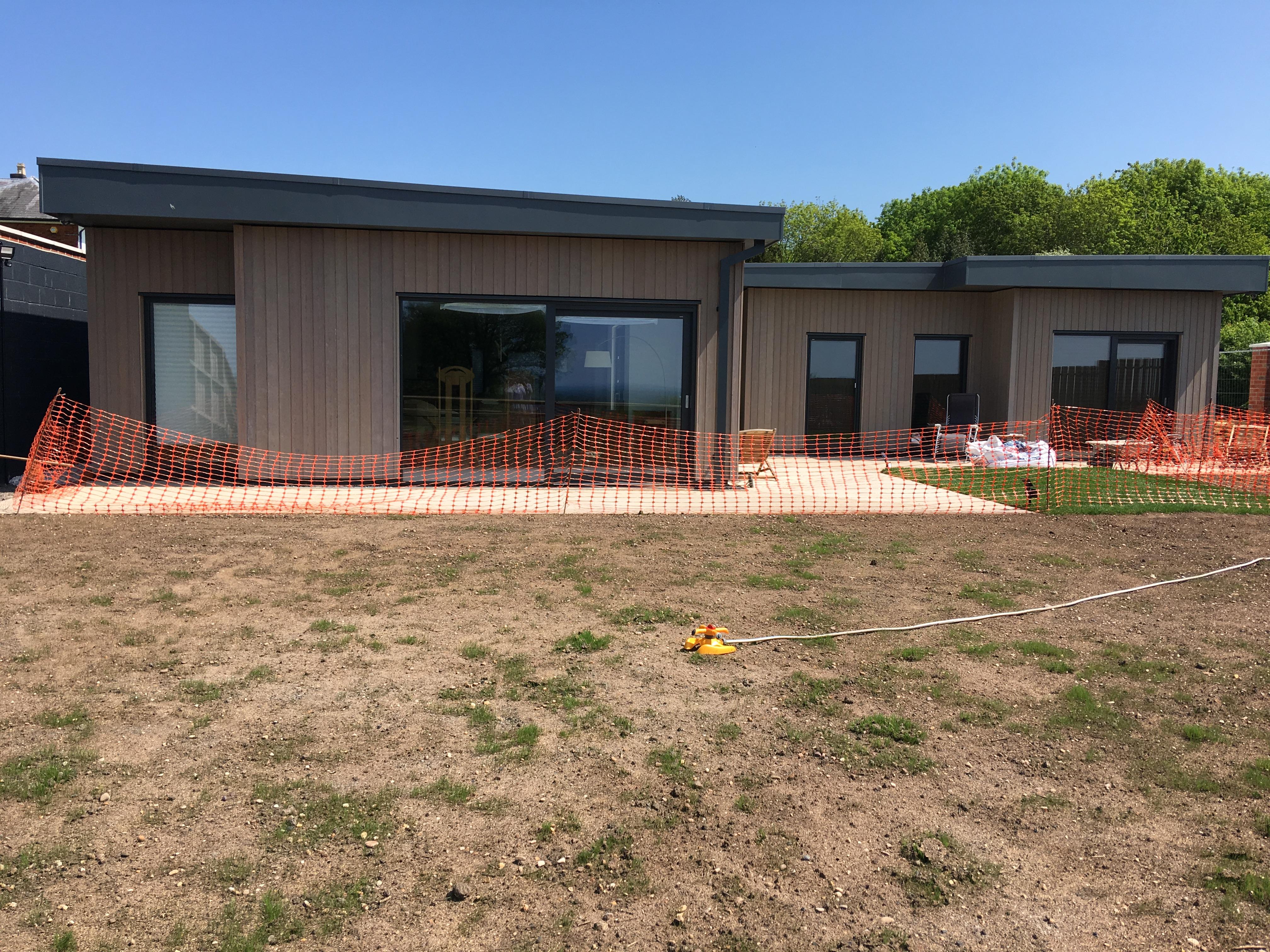

lizzie Posted June 12, 2019 Posted June 12, 2019 I have Silvalbp Siberian Larch with new Age Gris sacrificial coating - via Vincent Timber. Its a horizontal secret fix. Stainless steel fixings used. The quality of the larch was far superior to other larch samples I had from Vastern etc I had always thought I would have WRC and had lots of samples, was pretty set on one from Russwood with Siou coating. Last minute unexpected swerve to larch when I saw the Silva lbp Larch sample - it was a coup de foudre! Reason for me dithering on the cedar was really because of the colour variations even from v expensive supplier - Russwood. I was also concerned with what you term bruising...if someone bashed a garden chair into it would not look good all dented. The larch is reassuringly heavy and feels more durable. We are high on a ridge very exposed. Our larch does not appear to have moved much on the house in the last year however my bin store and meter cupboards have had had a lot of swelling and shrinkage. That may have happened on the house but we are just not aware of it. I had a superb carpenter to fit it. Very experienced and took account of timber movement. I wanted the sacrificial coating as I hate the uneven old shed look and blackened bits a no no for me. Ours is crisp and beautiful and we have white render and RAL 706 too. I hope it remains as beautiful as it ages. I can't say anything about the longevity as too new but I would be expecting more than 15 years from it. The pic is last year about this time. 1

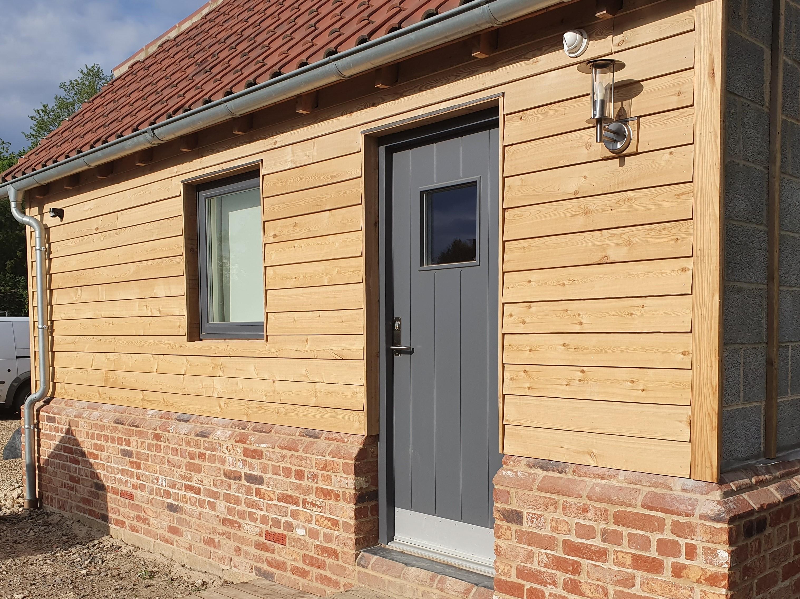

Roundtuit Posted June 13, 2019 Posted June 13, 2019 I'm currently cladding with Siberian Larch (well, when if stops effing raining..). It's rebated feather edge. My battens are as shallow as I thought could get away with (25mm) because I don't want to loose any more of the plinth bricks than I have to, hence batons at 400~450mm spacing, and all screwed with stainless steel cladding screws. I've left ~ 3mm expansion gaps between boards, and I dont expect to see much movement on it; it feels solid. Holes at the ends of boards are pre-drilled for good measure, and yes, it is taking forever! I've bought Sioo:X to treat it, but it will be a few more weekends before I get that on. This is my first/practice end:
lizzie Posted June 13, 2019 Posted June 13, 2019 9 minutes ago, Roundtuit said: I'm currently cladding with Siberian Larch (well, when if stops effing raining..). It's rebated feather edge. My battens are as shallow as I thought could get away with (25mm) because I don't want to loose any more of the plinth bricks than I have to, hence batons at 400~450mm spacing, and all screwed with stainless steel cladding screws. I've left ~ 3mm expansion gaps between boards, and I dont expect to see much movement on it; it feels solid. Holes at the ends of boards are pre-drilled for good measure, and yes, it is taking forever! I've bought Sioo:X to treat it, but it will be a few more weekends before I get that on. This is my first/practice end: If you still have some to do I would get the Sioo x on it before you put it up, much easier to do it on trestles
Roundtuit Posted June 13, 2019 Posted June 13, 2019 1 hour ago, lizzie said: If you still have some to do I would get the Sioo x on it before you put it up, much easier to do it on trestles Thanks for the tip. I was planning to get it up and let it dry/shrink for a week or two (weather permitting..), then spray the treatment on with a 2l pressure sprayer. I might try both. 1

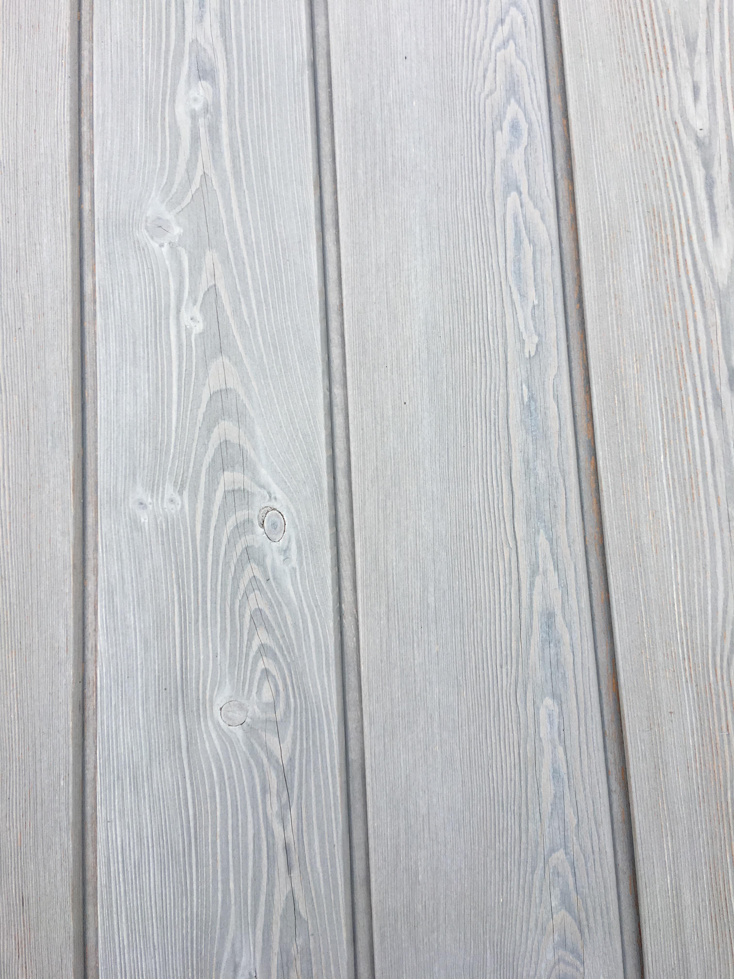

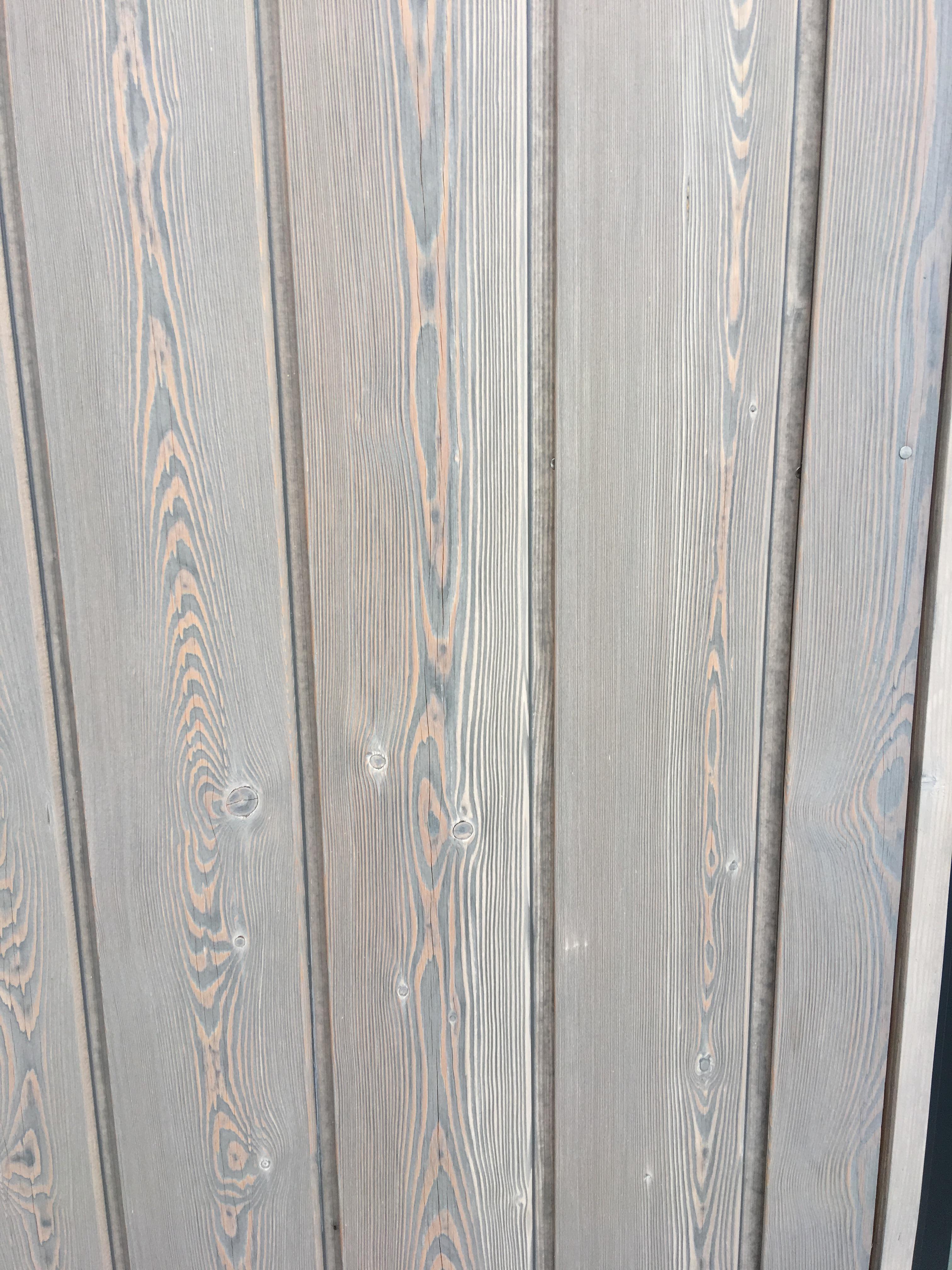

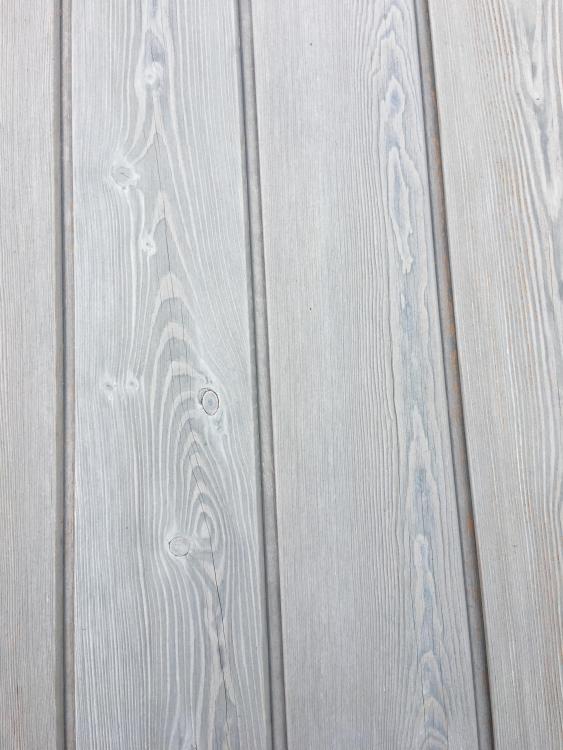

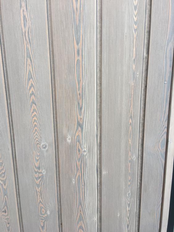

lizzie Posted June 19, 2019 Posted June 19, 2019 I have just noticed today that my larch is starting to ‘weather’ over a year on. The Silvalbp coating is doing what they say. Shame really as I loved it ‘new’. What is interesting is that I have a bench in a very exposed part of the garden. Seat made of left over Silvalbp larch. Been there about 9 months so much less than that on the house. The larch on the bench has gone a beautiful silver colour almost without me noticing it changing. The house larch which is more sheltered is a long way behind on the weathering when you compare the two. Photos don't really show it that well. 1
lizzie Posted June 19, 2019 Posted June 19, 2019 21 minutes ago, Danny68 said: What's the life expectancy of larch, very nice btw Thank you. They say minimum 50 years for good siberian larch.....will see me out I hope!
Danny68 Posted June 19, 2019 Posted June 19, 2019 Would that need routine treatment or just once when pre fitting
