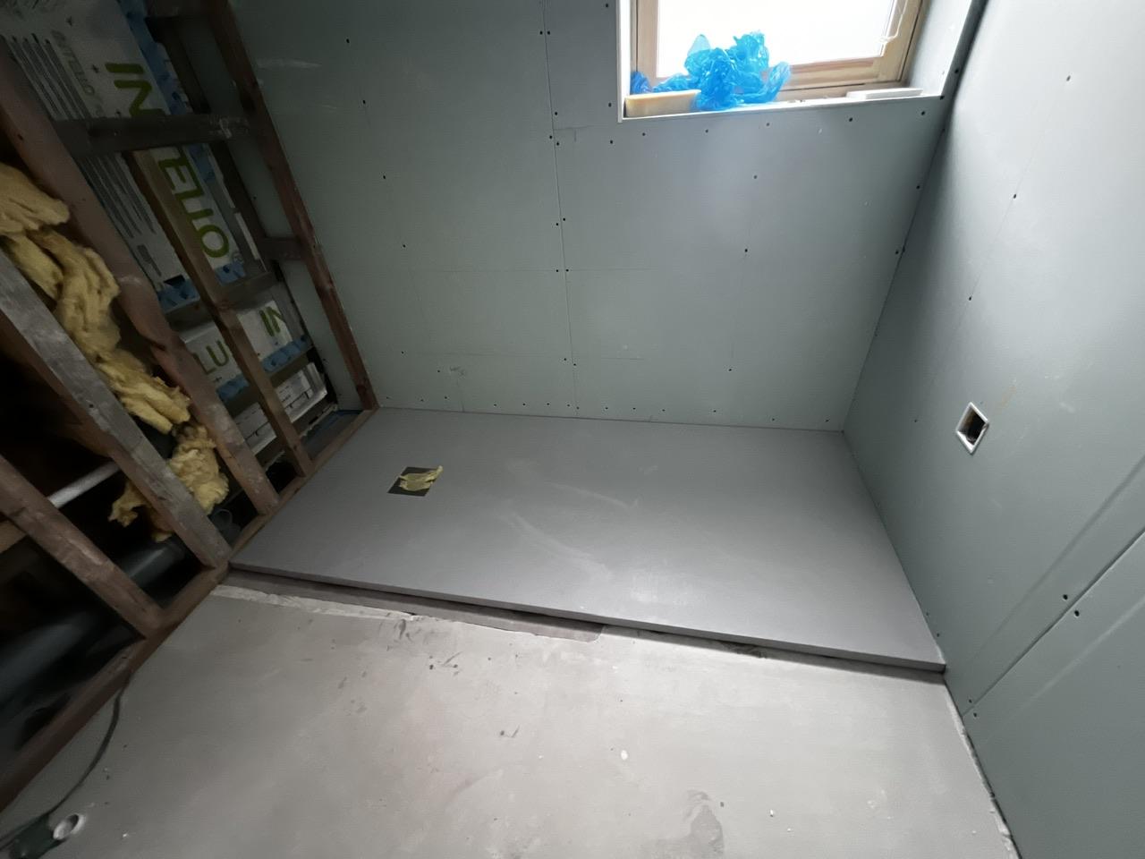

  18. We removed the worktop and cabinets on the back wall to get the space back but this was where the sink was going. Our Island is quite big at 3.3m by 1.3m with 9 long drawers that swallow a lot of stuff. Plus full height wall cabinets. The downside was the need to put the sink on the island. Yet to be determined how it will all work. It did also save £5000 in cabinet’s and stone worktop. We have a big utility room in the room next door so big stuff to be washed will go in here rather than in the main kitchen sink. This is what we’ve always done in previous houses so it’s something we’re used to.
  19. Caulk is better than silicone as it can be painted but make sure you use something that’s elastic so it’s less likely to crack.

  23. The dark grey stuff is is a self levelling compound (Arditex NA) which was the infill for the shower area. It has the same insulation underneath it as the rest of the floor but no UFH. The light grey is Cemfloor that has UFH within it. The shower tray is a stone/resin shower tray.
