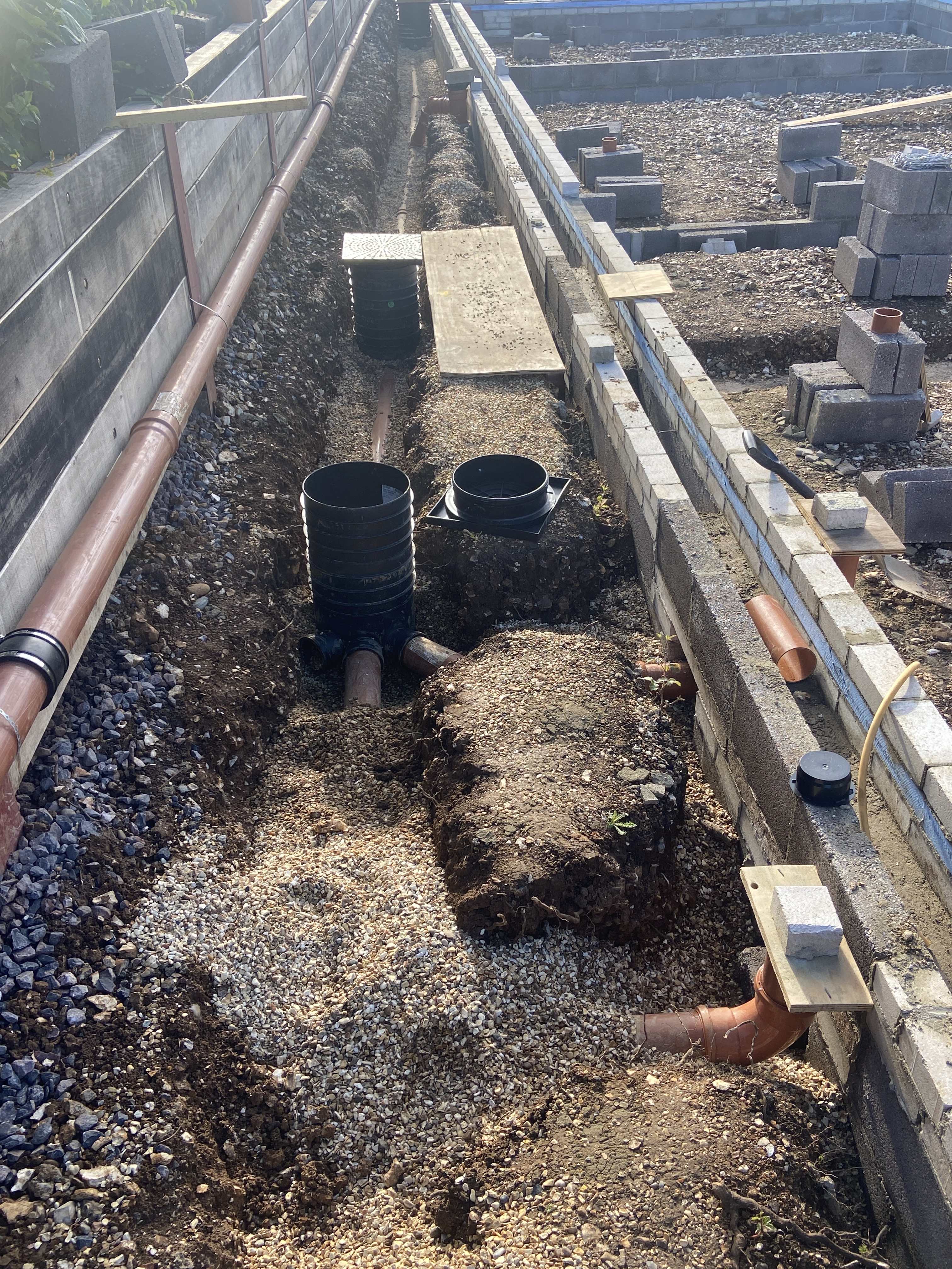

Rest bends haunched. Pea shingle layers done as described. Picking out obvious foreign objects impossible.
The excavated soil from the foul drainage trench is very flinty and I wanted to ask whether I could backfill the trench using said soil if I cover the foul drainage with 100mm of pea shingle or should I get someone in to screen it first. Trying to avoid unnecessary expenditure, but also possible problems in the future.
On paper it looks fine, but I'd just check Part H document to ensure the falls work ok with the arrangements connected to each run.

foul waste Foul drainage. Remove inspection chamber?
flanagaj replied to flanagaj's topic in Waste & Sewerage
Foul drainage installed with my own fair hands š -
Thanks Mike. Thatās why this site is so helpful. I hadnāt considered doing it that way š -

The image below shows the inspection chamber at the beginning of the run. As the first toilet comes in on the branch and the main leads off to the external SVP which is solely there for the sewage treatment plant, Iām concerned that Iām potentially going to get a blockage as there is no flow coming down the main run. if I remove the inspection chamber, I can then route the pipe into the main channel of the next chamber. This will enable the pipe to be rodded. I am then not sure how Iād then branch off for the external SVP?
