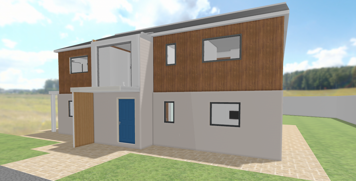

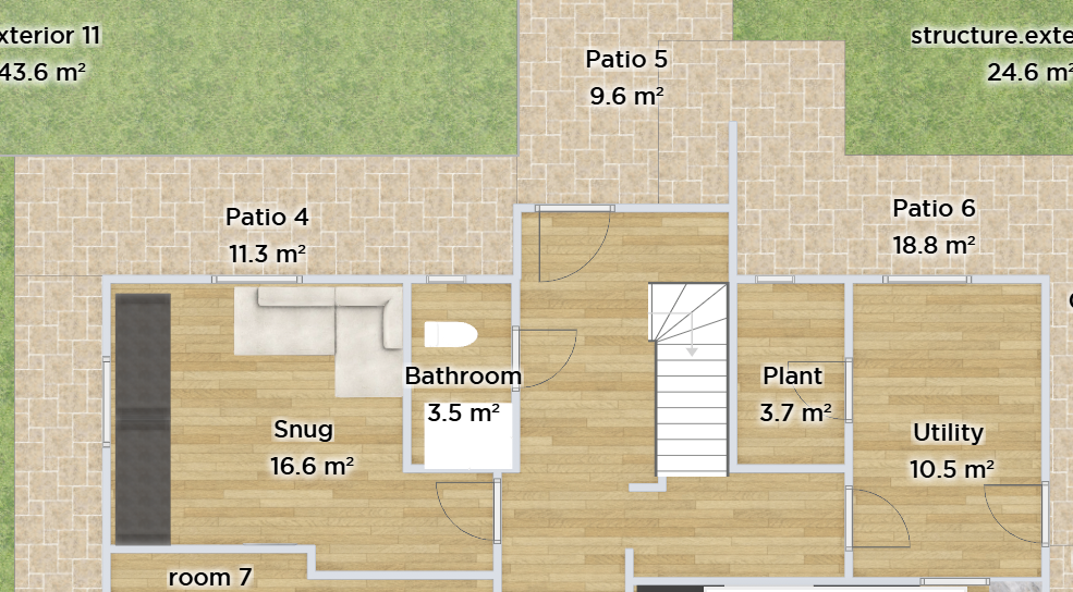

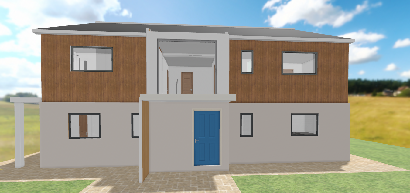

  12. Hi helpful people from last month, I've been playing around with facade options to try and address the massing issues. Done in budget-version HomebyMe so visuals a bit unrefined. Wondering about removing the standing seam and switching it for slates on the roof. Then a half render/composite cladding for the walls. We've also pulled across the porch a bit make more of a feature of the asymmetry, get more light and views upstairs and create a porch. Floor plan change shown here too. Any comments on this? Is silicone render on a timber frame really flexible enough to tolerate the movement!? Many thanks for your wisdom
  13. @garrymartin Thanks Garry for your thoughts. Keen to keep the plant room window as we’re going to have laundry drying space in there so will be in and out frequently. Good point that widening the little projection (and door/glazing) would add more balance

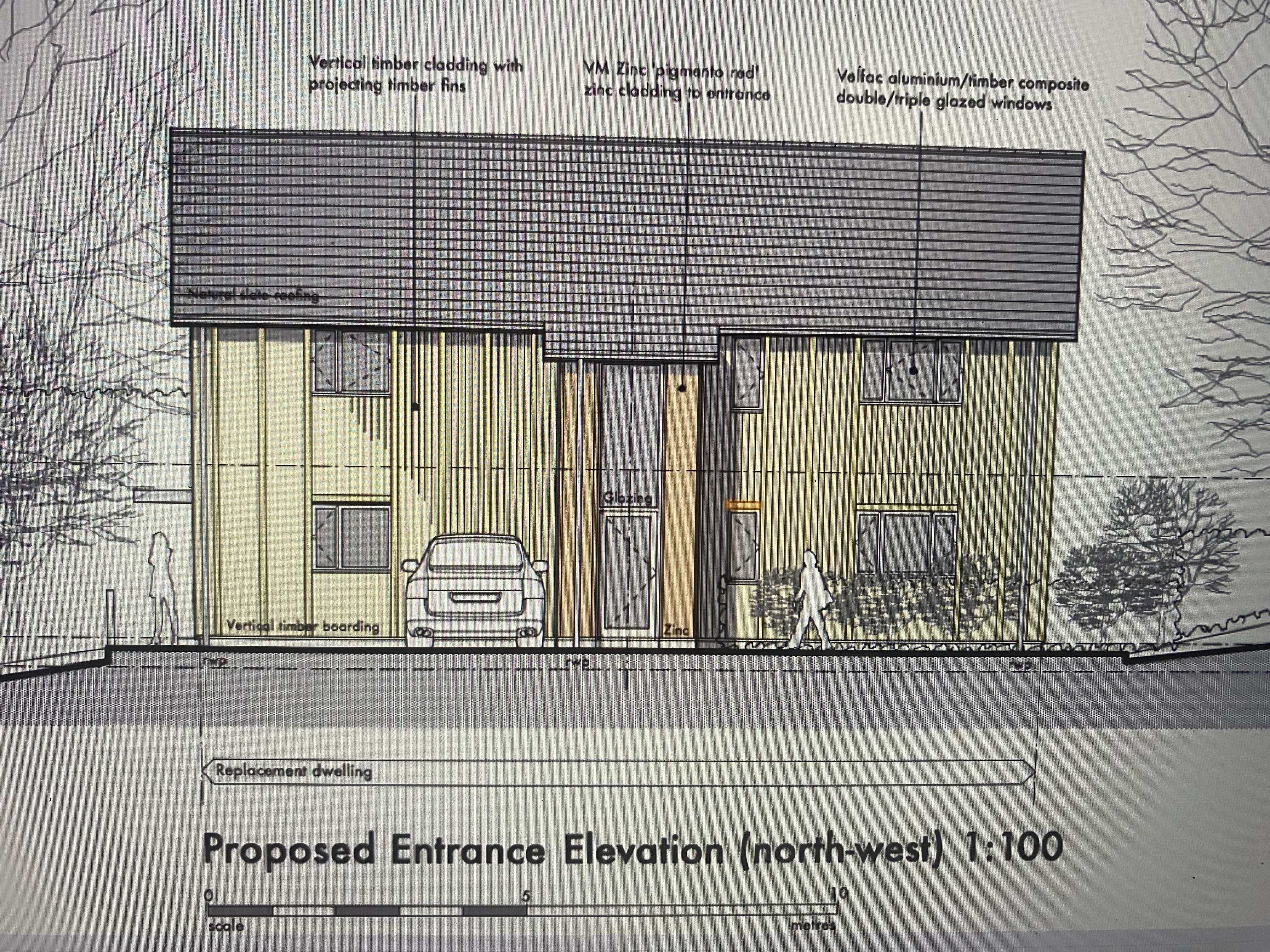

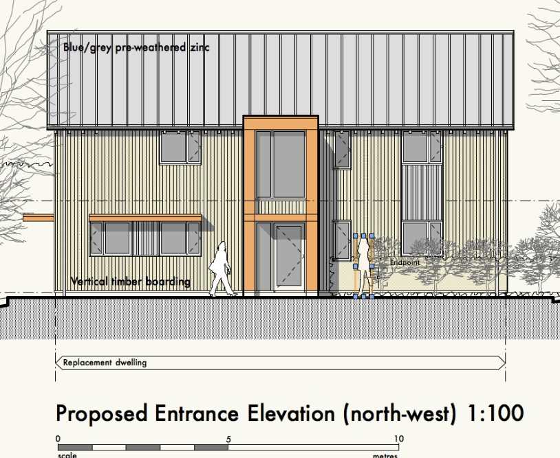

  14. Yes I’m not sure why the first floor looks to be wider than ground - it will be ever so slightly due to the metal cladding but not as it looks here. We thought running the metal cladding down around the front door projection would help the two sections mesh together better. It’s the same as the roof - not the orange Corten. Here are the other versions from the architect…
  15. @Gus Potter Many thanks for explaining this - I had assumed massing meant it’s all in one block, rather than the materials. Due to the slightly uphill, wooded and curved approach of the track leading to the house, the roof will hardly visible on approach. We included the half wall of metal cladding to break up the front facade which otherwise we thought was too blocky. We also thought a darker colour at the bottom (such as Metal Green Cedral Click) and then a lighter roof zinc-coloured steel roof would also help. We’ve played round with lots of variations and materials and are struggling to know what looks the best - if you/anyone has any suggestions on improving the front facade then we’d welcome them!
