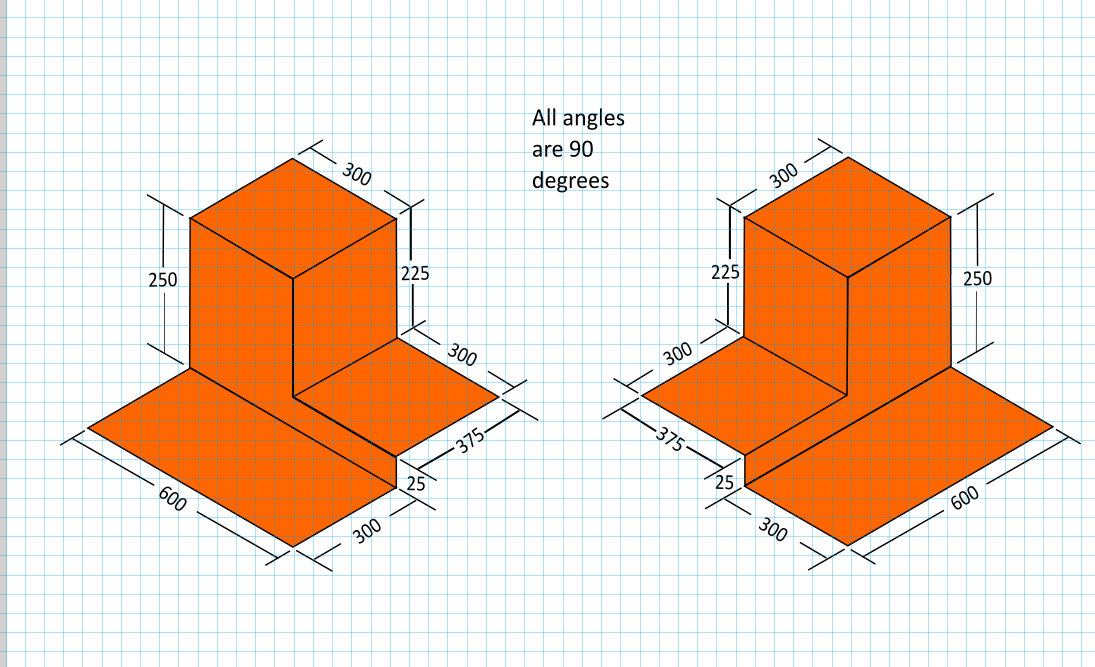

One other question. Do I finish the slab at the back of the inner leaf blockwork or should the slab come through the opening and finish level with the exterior leaf. If I do the later, do the bricks that close the cavity just sit on top of the lean cavity fill (left image) or should they sit on the concrete slab (right image) Eg, if you were looking at eye level from the front would it be the left or the right image below
Garage is attached. You are most likely correct that the cold bridging will be negligible and I can close off as per the diagram.
But how do you thermally break with PIR. Do you have a drawing or an image that shows this?

We are having a Radon membrane (but I suspect the same applies for a simple DPM) and am just about to put my order in for pre formed Visqueen units. As the floor slab protrudes across the 350mm wide inner leaf/cavity and outer leaf, I am confused as how you stop the slab getting damp from rain water falling on the outer part of the slab which sits outside the garage door, which then creeps internally inside the garage. Below is an image of the pre formed corners, but even if you did not have pre formed corners and cut and taped the DPM around the opening, you still have the issue of the slab running continuously through the opening and outside. Do you simple cast the slab in two sections and have a dpm upstand on the inside and have rebar mesh poking through to the 350mm wide opening section?
