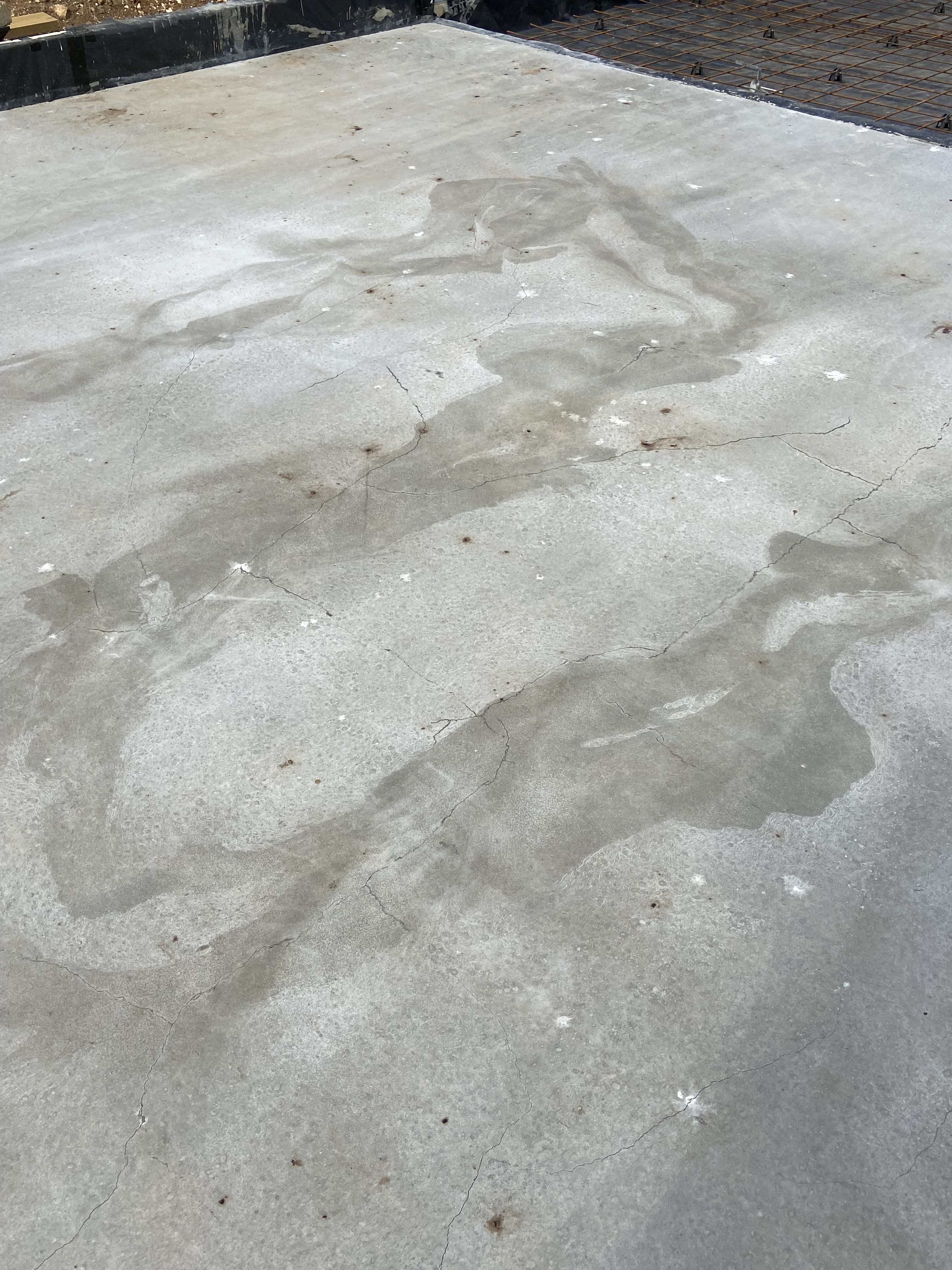

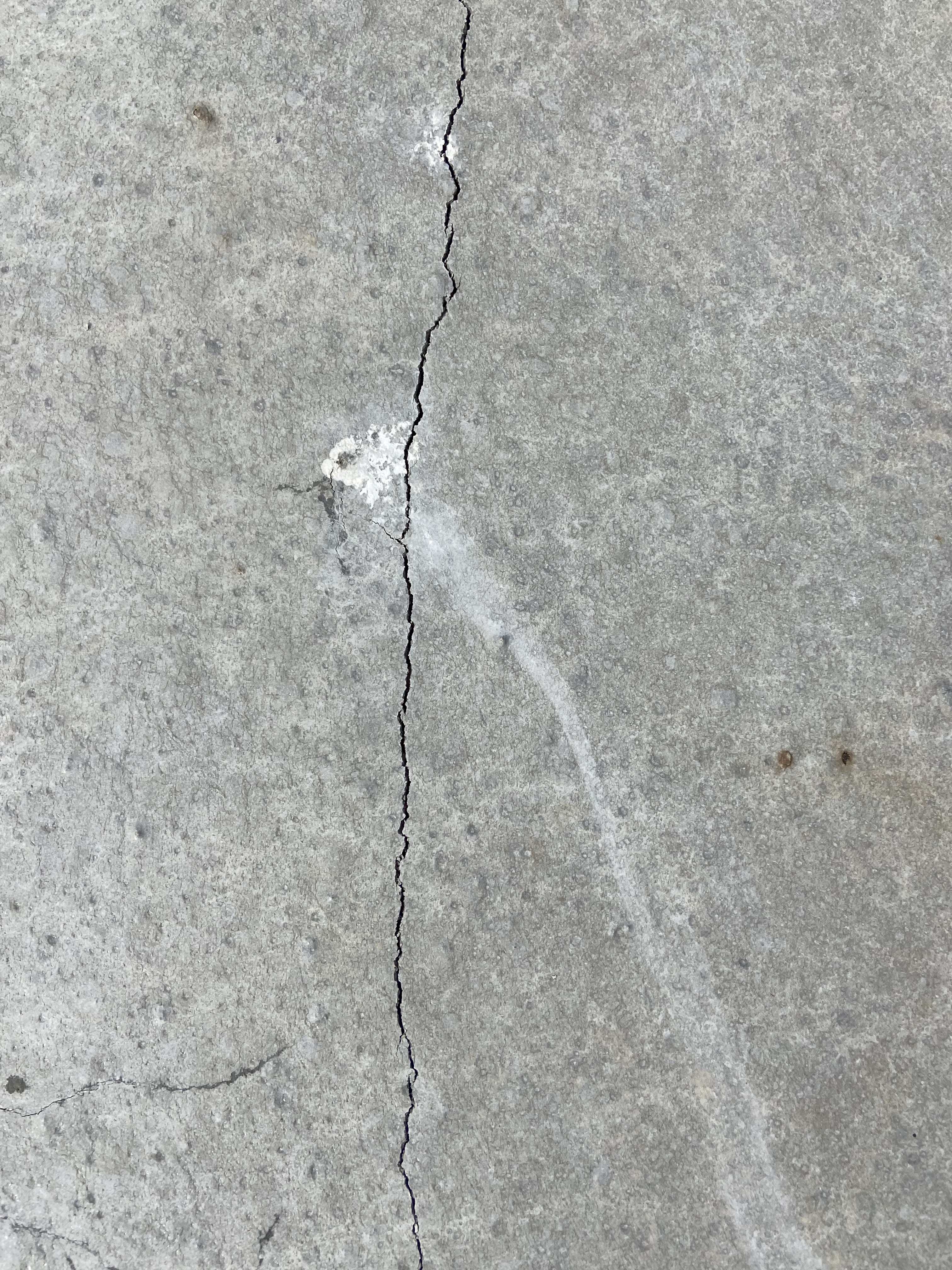

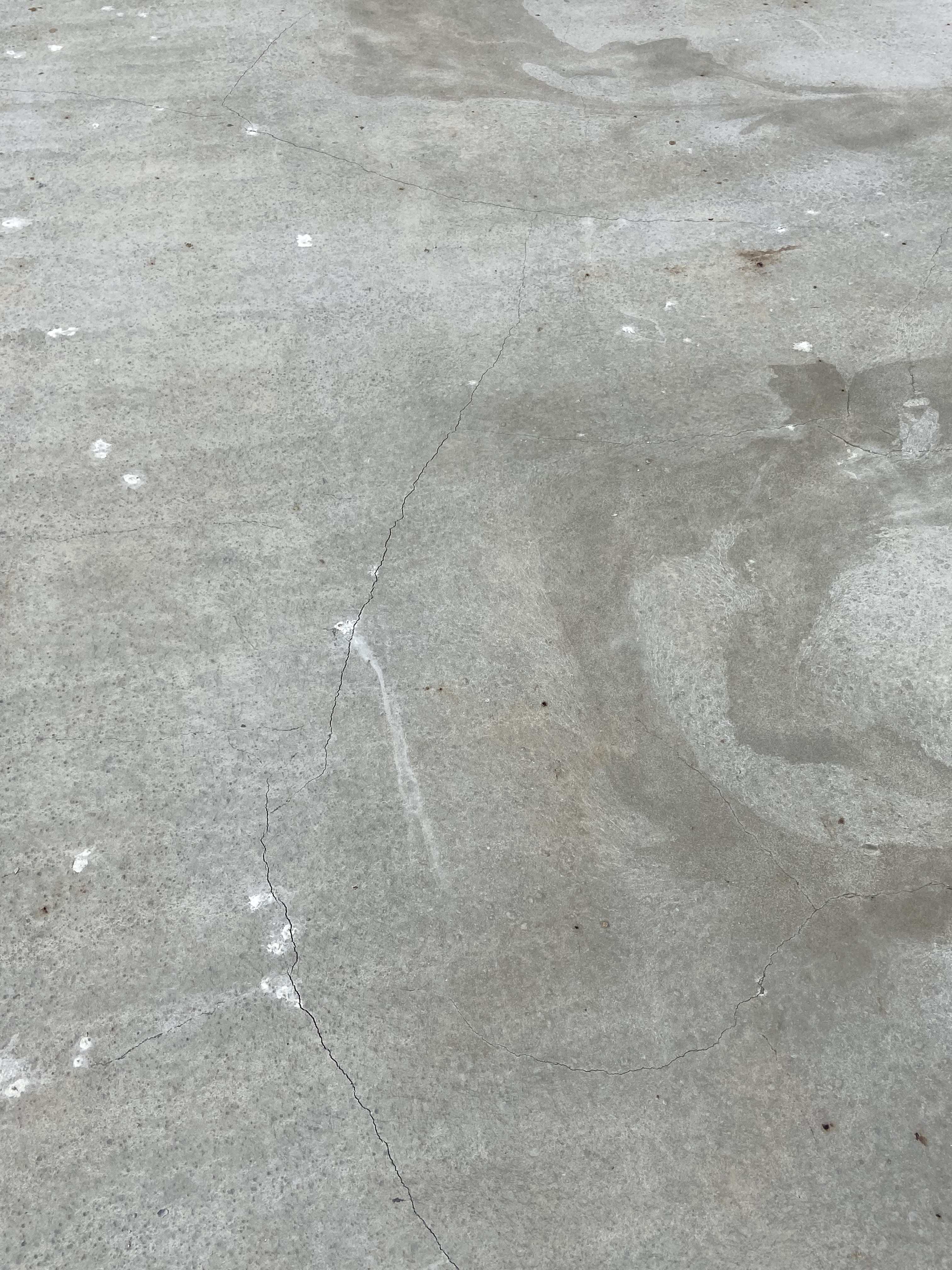

As requested. Here are some pictures. I’m seriously gutted at how it’s cracked. But it is one of those things and although I’ve done a garage slab before when it was 10C using traditional concrete and a poker and that had no shrinkage cracks. the SCC was £178/m3 -

So I did apply it correctly. Maybe not enough or should have used a Wax or Resin based agent. -

So feel free to have a chuckle to yourself, but the SCC pour went really well and the stuff is absolutely amazing. Slabs level to 2mm. What didn't go well and this was partly due to a lack of information available and me not appreciating the associated risks of trying to pour slabs in weather that is so hot, was the curing. Slabs unfortunately look like crazy paving. Curing agent was applied, but when it states "immediately after finishing" they don't mean dappling and when the concrete is still fluid. Cemex also advised that microfibers should be added, but then somehow didn't adjust the order (yes! I should have double checked) so that didn't help. Having A252 mesh has probably saved me from having to condemn them. But I would still recommend this can be done as DIY. So long as you can use a laser level and set up screed levelling tripods, then you will be amazed at how flat and level you can get slabs just by using a dapple bar. Just be careful of doing it in hot weather, as SCC has low water and a high cement content so not as forgiving as normal concrete. Note - I purposely didn't dapple a shallow pass on this slab as the finish from the first pass was perfectly good enough for below PIR As to pouring the remaining slabs. Well. I'm too nervous now. Especially, given the weather and previous attempt. Was considering using Hessian and water curing, but even then I am unsure. It's 15c at 8am when I poured and by 10am it's absolutely roasting and probably 26c VID-20260801-WA0007.mp4 -
