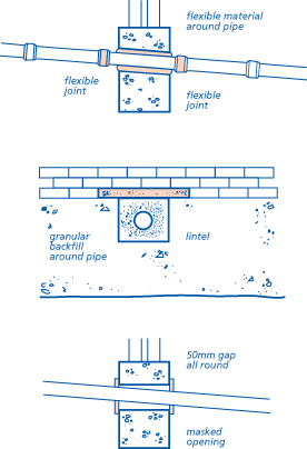

Because the location of the sewage treatment plant is quite low relative to FFL as a result of the site sloping off after the house footprint. As a result it might require the initial depth to be deeper than normal, so as to be able to get the correct invert levels.
If you have your soil pipes running internally and are using trench fill footings, then I suspect that there is a high probability that it will have to run right through the trench (see image) whilst I understand the image, I am finding it difficult to understand how you go about creating the void in the concrete. You obviously can't use a prefabricated hollow rectangle made of shuttering ply, as you won't be able to get it out once the concrete has set. I suppose you could use a solid piece of polystyrene which could be chiselled out after the concrete has set. I suspect I've got this completely wrong, so please explain if you have had to do just this. Ps - I assume the soil pipe is not in place when you do the pour?

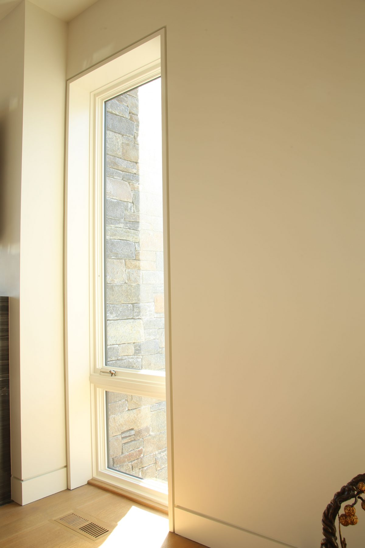

Not sure where to post this, but I thought general joinery, given it's the carpenter who installs the reglet. You can also download a pdf too. https://www.finehomebuilding.com/project-guides/drywall/installing-reglet-trim Another article on the same site had the image below. Using oak would look stunning.
