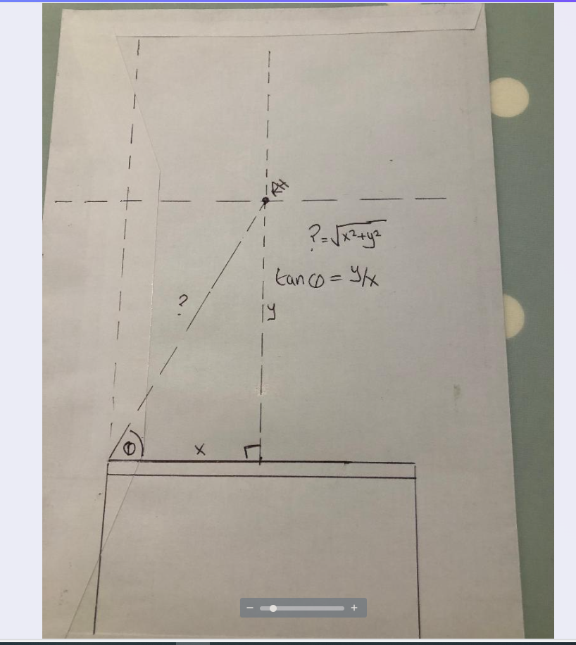

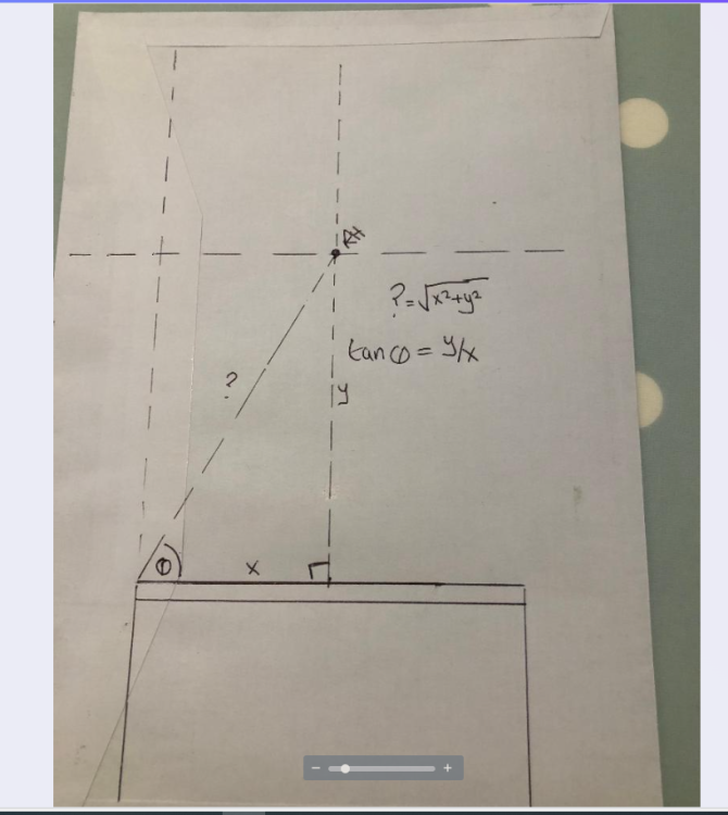

But how do you calculate said angle? I can obviously sit down and work it out, but my point is that none of the online rafter tutorials cover how you calculate the angle of your common rafter to ridge plate plumb cut according to your finalised ridge height and the associated birds mouth cut. -
Confused about birds mouth cut dropping ridge height
flanagaj replied to flanagaj's topic in Roofing, Tiling & Slating
Hopefully, the diagram below will help. So it's easy to calculate ?, but a rafter is 6" or 8" and this will then throw the ridge height up by a given amount. So although measurement ? is constant so long as the pitch remains constant, then it does not matter whether you use a 100mm or 250mm rafter, however, the calculation fails to take into account the width of the rafter. And as I mentioned before, if I cut a birds mouth after I have calculated ?, then my ridge height will drop when I seat the rafter on the wall plate. You say I am over thinking it, but until I see an example of how I calculate ? with a given size rafter, a birds mouth cut and my ridge height being fixed, then I still don't get how you calculate it. The key point here, is that if ridge height is fixed then to maintain the same ridge height with a different sized birds mouth cuts or even different rafter sizes, the only variable that you have to change is the roof pitch. If I use a 100m rafter then my roof pitch will be steeper than if I use a 250mm rafter. Simply due to the fact, that bot ends would have to converge at point RH, but the 250mm rafter will sit higher on the wall plate than the 100mm rafter. -
So I am perfectly fine at using trig to calculate the rafter length, eg hypotenuse of a triangle. But where my head is hurting is around the birds mouth cut. The depth of the birds mouth cut will drop the ridge by the same amount. And to therefore get the ridge height back to where it was before you cut the birds mouth, requires the roof pitch to be increased. What am I missing 🤯
