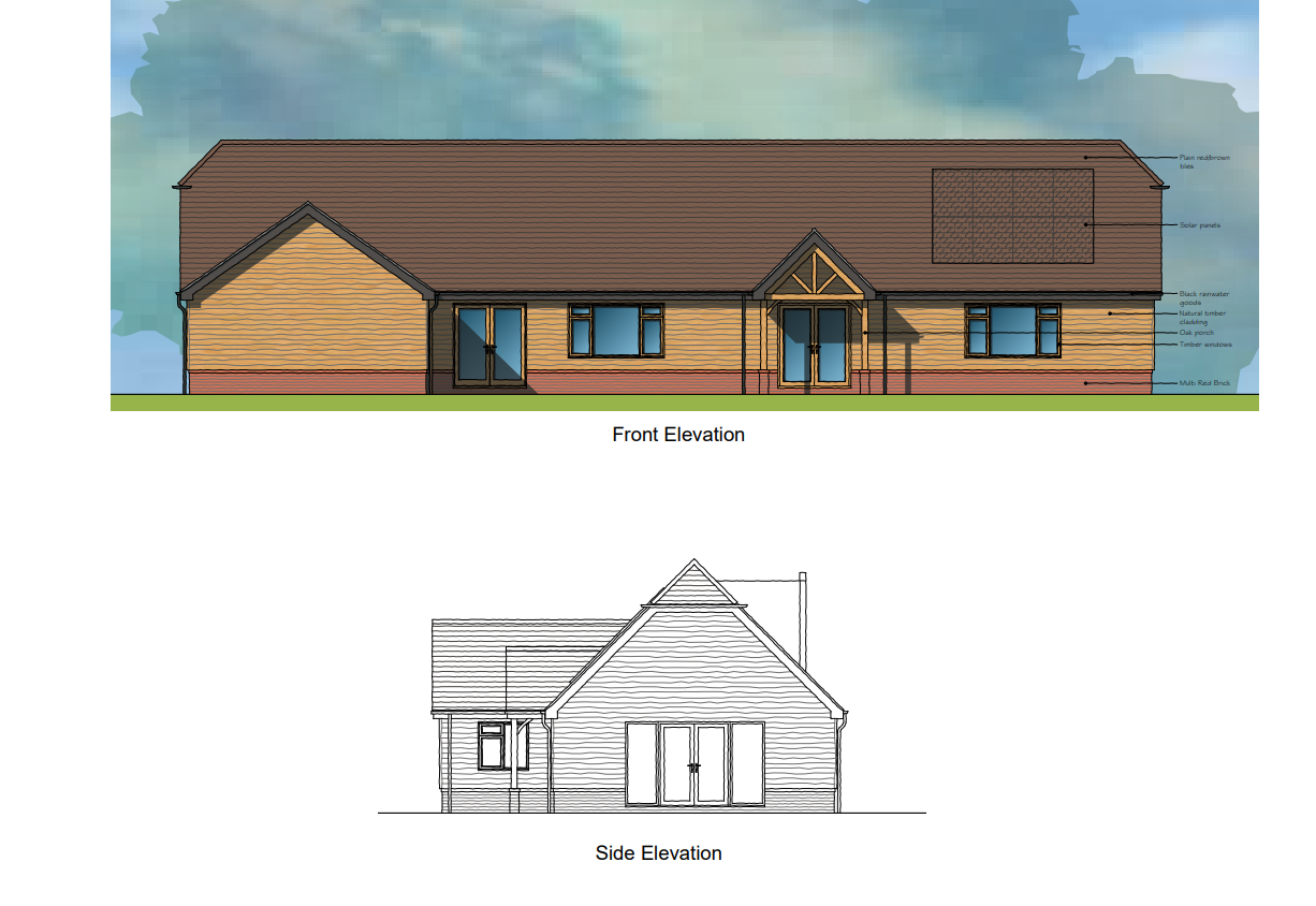

  14. I found this image on one of the blogs, and I just love how the cladding is recessed back into the structure. Our proposed build is faced brick, 150mm cavity and the block. Is it simply a case that for the recessed part you would use the following layup. 18mm osb Vapour barrier 150mm studwork with celotex between 18mm osb Breathable roofing membrane Batten Cladding.. As the thickness of this is less than brick + cavity + block it is recessed back so that the osb is flush with the face of the internal block work.

  18. This what I had in mind.
  19. I am not a fan of eaves, and am trying to understand whether I could dispense with them if you are having a clay tile roof. If you had fascia the same colour as your windows, I think this would potentially look very slick. The link below shows an image of what I am talking about. https://www.archdaily.com/952573/4-solutions-for-roofs-without-eaves-and-their-construction-details/5fc7ad6263c0179a2100009b-4-solutions-for-roofs-without-eaves-and-their-construction-details-image
