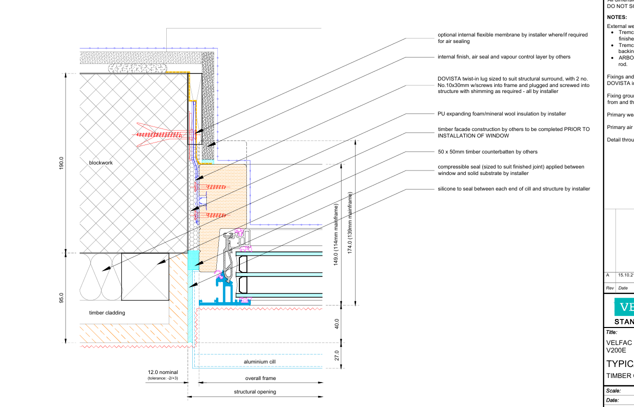

We have finally decided to go with the Velfac V200E window system. Good U values and also came in quite a bit cheaper than Norrsken and Rationale. I am looking at the installation detail for an exterior clad property with timber reveals and I am not convinced about it. The foam compression strip, I think is probably fine, but silicone against exterior timber does not sound like the best option. We are going with thermowood, so I am not sure whether that by it's nature will not absorb water and expand like regular timber will.
