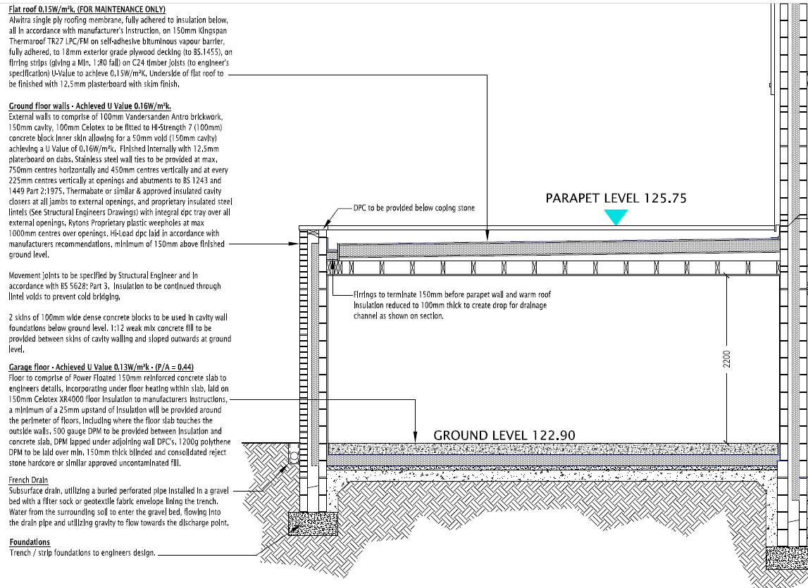

  11. One of the requirements for our build is that I want a garage that is not cold and damp. As a result the TA has specified cavity walls as per the main house, 150mm celotex floor insulation and 150mm Kingspan TR27 roof insulation. This obviously comes at a cost and I am wondering whether it is overkill and I could reduce the floor insulation and also the roof insulation a bit. There is no door connecting the garage to the house. The garage will be my workshop and gym so having something that is not Baltic during the winter months is the main criteria. I am also thinking of putting a radiator in too.

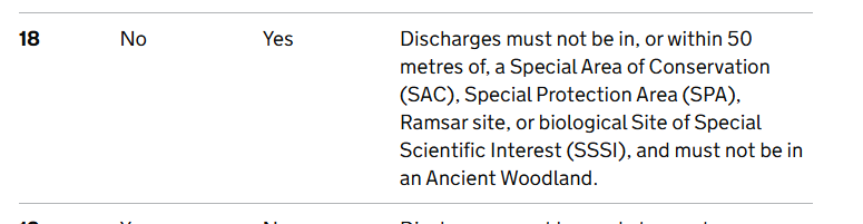

  16. I need to learn to read!! I have just given myself a great deal of stress and time completing the EA permit form. The Rules state Rule 18: make sure the discharge point is not in or near protected sites You cannot meet the general binding rules if the discharge will be in an ancient woodland or in or within 50 metres of any: special areas of conservation special protection areas Ramsar wetland sites biological sites of special scientific interest (SSSI) It states in an ancient woodland, not within 50 metres of an ancient woodland.
  17. Can I ask what the associated charge is. ChatGpt is telling me it is the region of 2-3k for the permit?
  18. We are unfortunately 42m downhill for an ancient woodland, GBR state it has to be 50m. Unfortunately, I cannot move the field so not sure what the alternative is.
  19. So having decided that I should apply for a **** EA discharge permit, they have asked where is the nearest sewage connection point to the property and also want a reference. Southern Water use digdat and I purchased a utility search from them before I purchased the land. But as expected, there is no foul water services. From what I can see digdat only provide a search within a given vicinity of your search location and they don't provide a search for something that is probably 2 miles away. Southern Water won't provide the info, but say I can travel to their office in Worthing (2 hour drive) are the clowns for real? Anyone else know how I can obtain "National grid reference (NGR) for the nearest sewer system." Why don't they just allow me to put "> 30 metres, see attached digdat asset map." We haven't even started and I have had enough. At leas the build will be more in my control.
