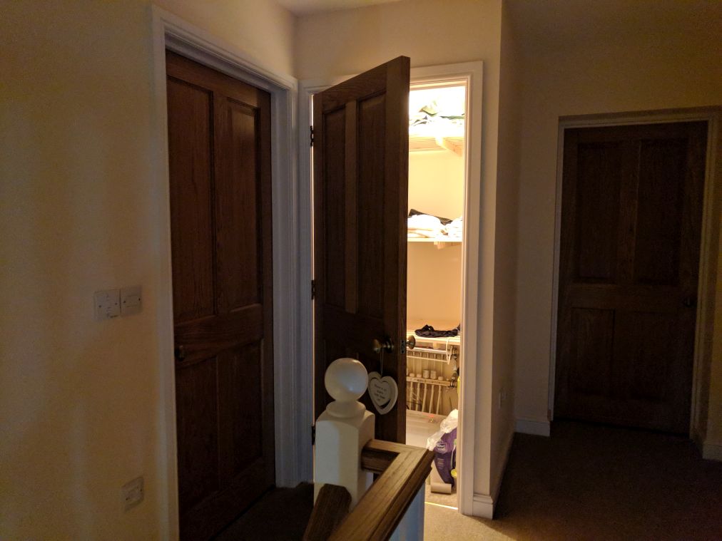

So its getting colder and my partner likes a warm (21-22degC) ensuite to get ready for bed. But we also both like a cold bedroom to sleep in (so no heating elements and currently 18.5deg). Sometimes I like to have an evening bath or shower in the family bathroom. All fine but for one point: when I have a evening bath it seems the MVHR runs at boost to vent my bathroom (good) but at the same time it is sucking the heat out of the ensuite and dragging the cold bedroom air into the ensuite so my partner complains. Am I at fault for trying not to have the whole house at the same temperature? And does a MVHR inline controllable valve exist (I can easily splice into the ensuite's extract)?

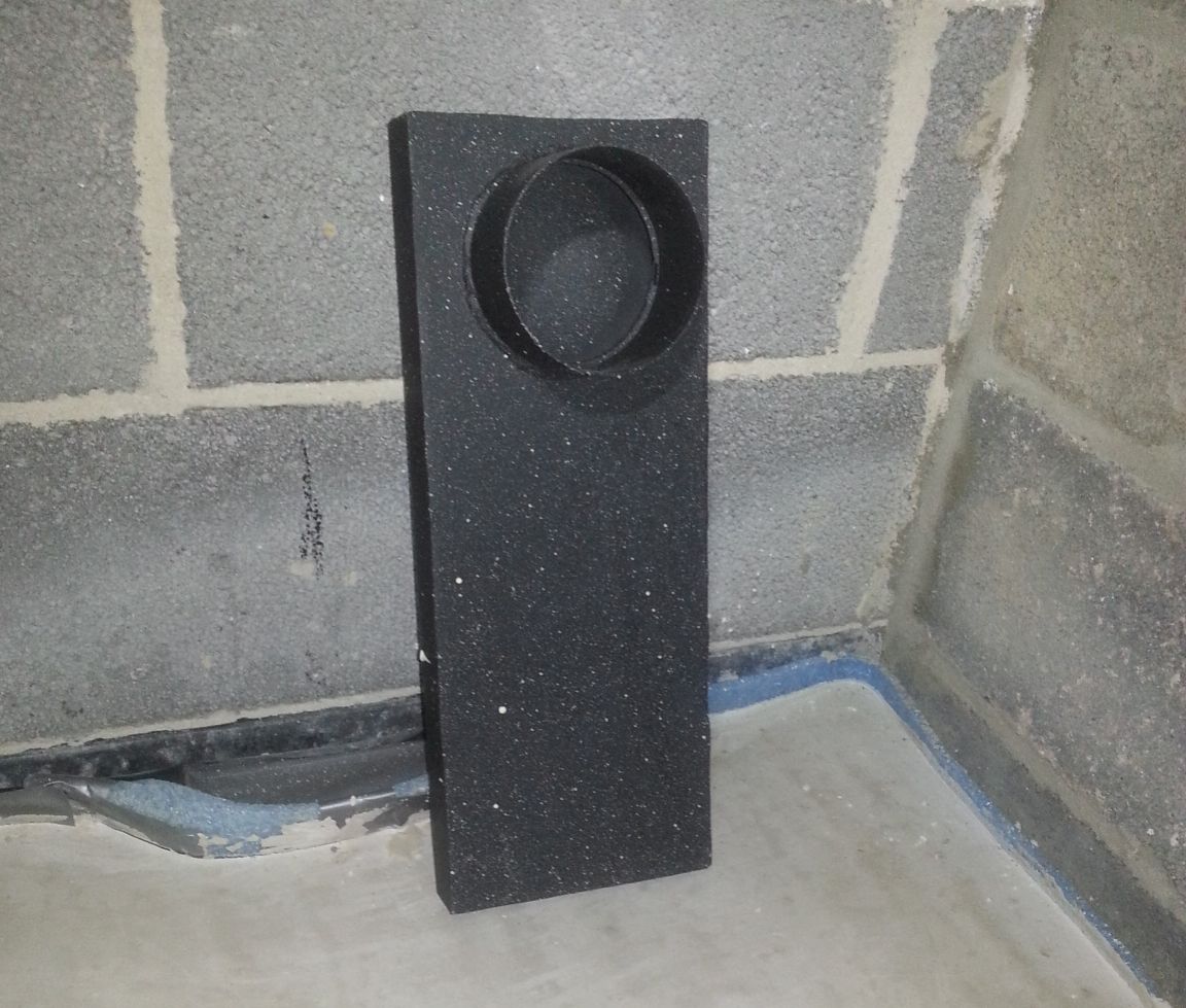

Quite fiddly! Luckily I decided to buy the log burner very early on so we could build the house around it! The Acer Oakdale did not have an option for a bottom air feed so my Hetas engineer got this adapter made up which slips (sealed with rope) a matching metal square tube that goes into the sub floor void. This floor metal tube was chopped into the beam and block floor before the insulation and screed were installed (you can just see it behind the black tube in this photo covered in grey tape )

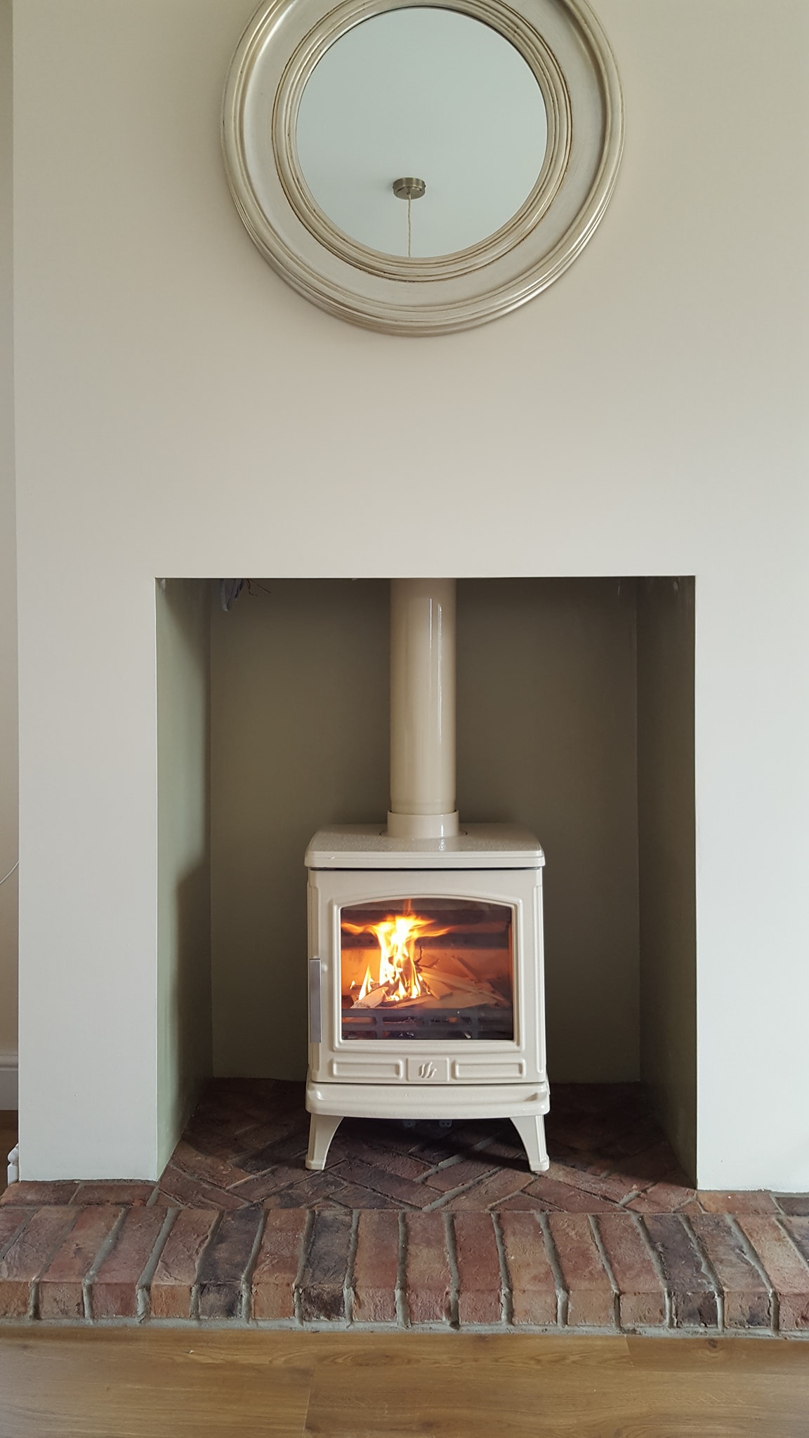

While not for those with near or true passivhauus, I've been very pleased with the little 5kW room sealed log burner I've installed in our large open planned kitchen/dinner/living room. It's only been installed for 3 weeks and now we can start using it regularly we are doing and it works a treat, especially as we can modulate it down nicely. Sealed air feed from the void under the groundfloor suspended beams fed by numerous external air-bricks. Looking forward to the real cold nights so we can let it roar a bit. An Acer Oakdale in Buttermilk - I didn't choose the colour...

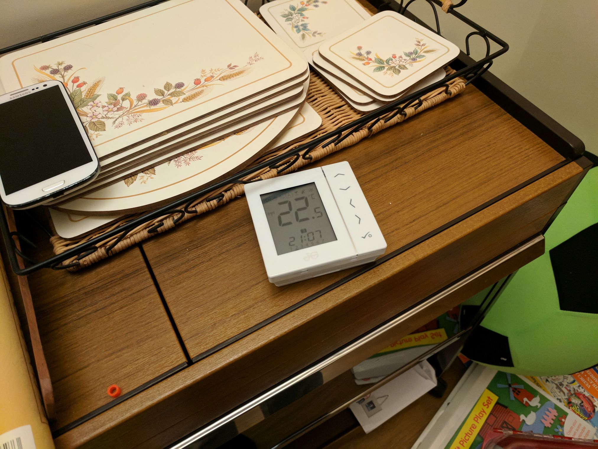

No idea if any better but this is what I have from John Guest (fyi that really is a hostess trolley - so maybe we are not trend setters!)

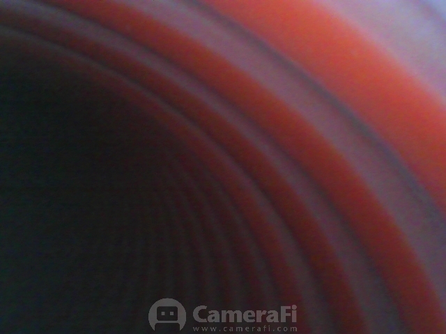

Would be curious to know what a view down a bit of ducting looks like if you have a spare moment. If that looks good I'll happily replicate here -

Any suggestions how to look at all of the MVHR pipework? (System doesn't 'feel' as effective as did prior to house blower test and have a small fly issue from one vent) Just wondering if I can push a mini wifi camera through the pipework without straining the pipework - most radi not too bad once camera got into pipework from room vents. Would a drainage camera work? Other ideas?

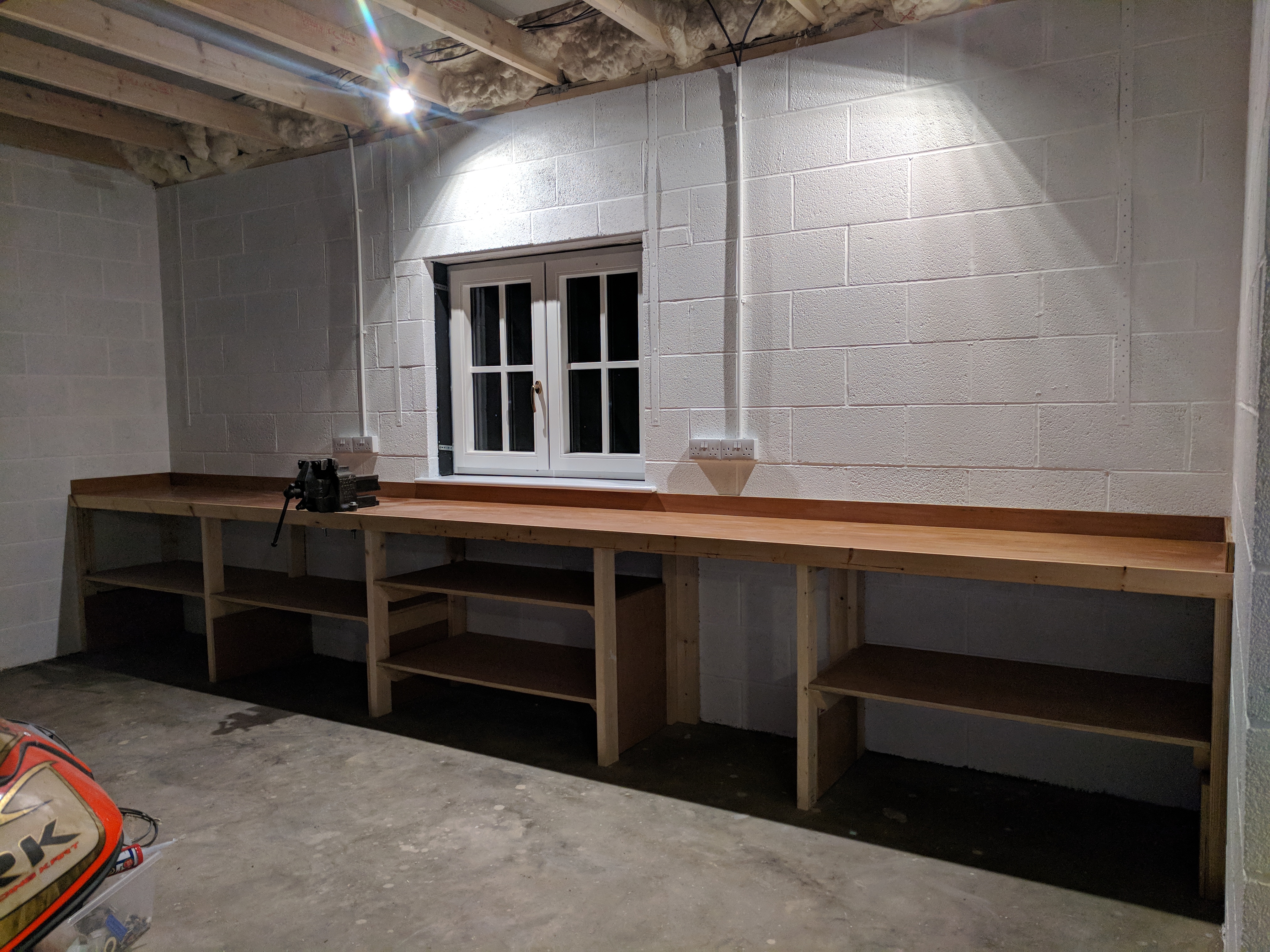

Finally finished the front garden.
readiescards replied to Gone West's topic in Landscaping, Decking & Patios
If you are bored now its done, feel free to pop over to Lincolnshire... :-)
