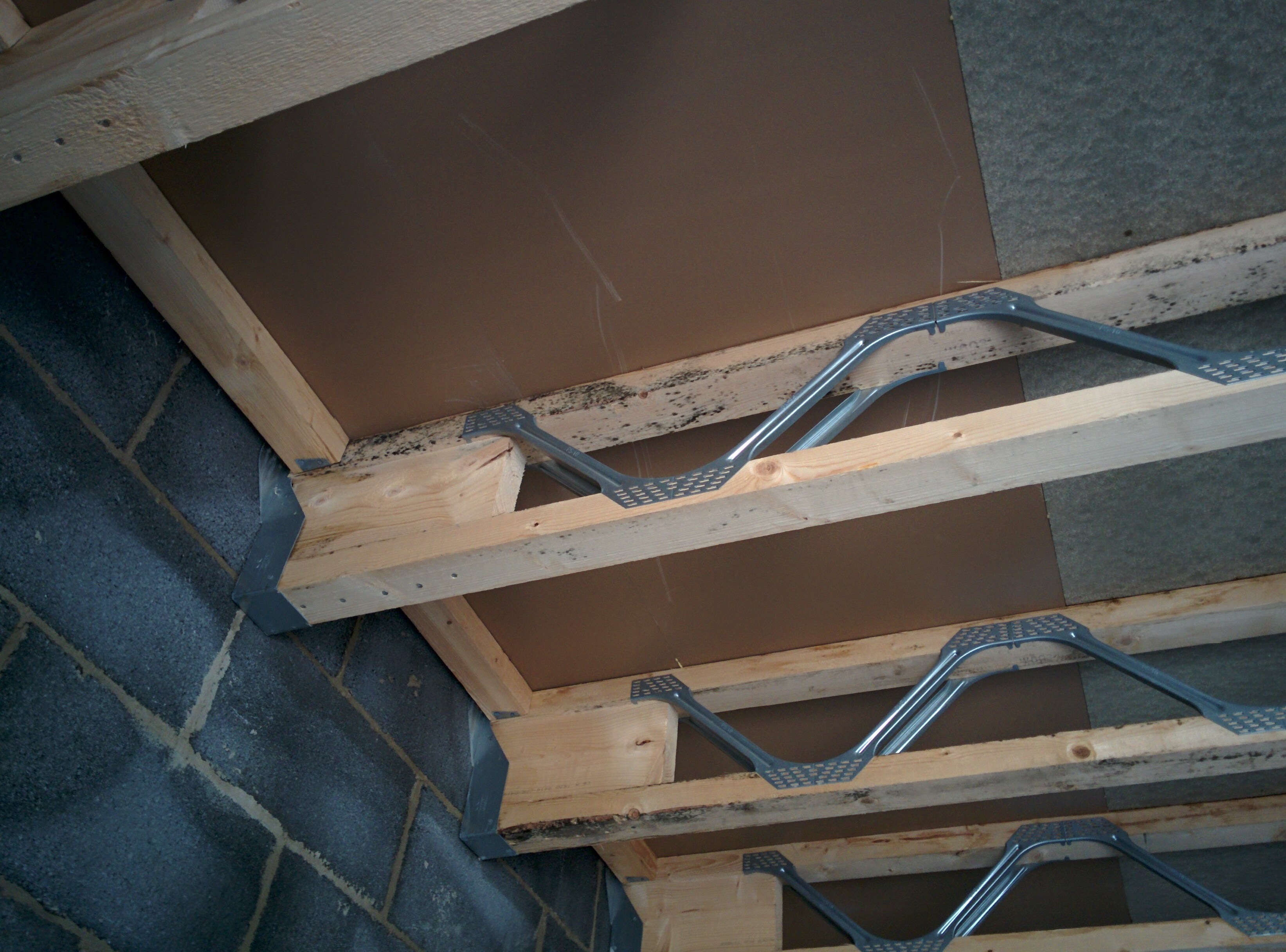

readiescards replied to readiescards's topic in Floor Structures
http://www.mitek.co.uk/Products/Posi-Joist/Posi-Joist-Handbook/ States: Posi-Joists™ can be designed to include single sided Posi-Strut™ webbing where appropriate to provide considerable material savings. So single sided seems ok. -

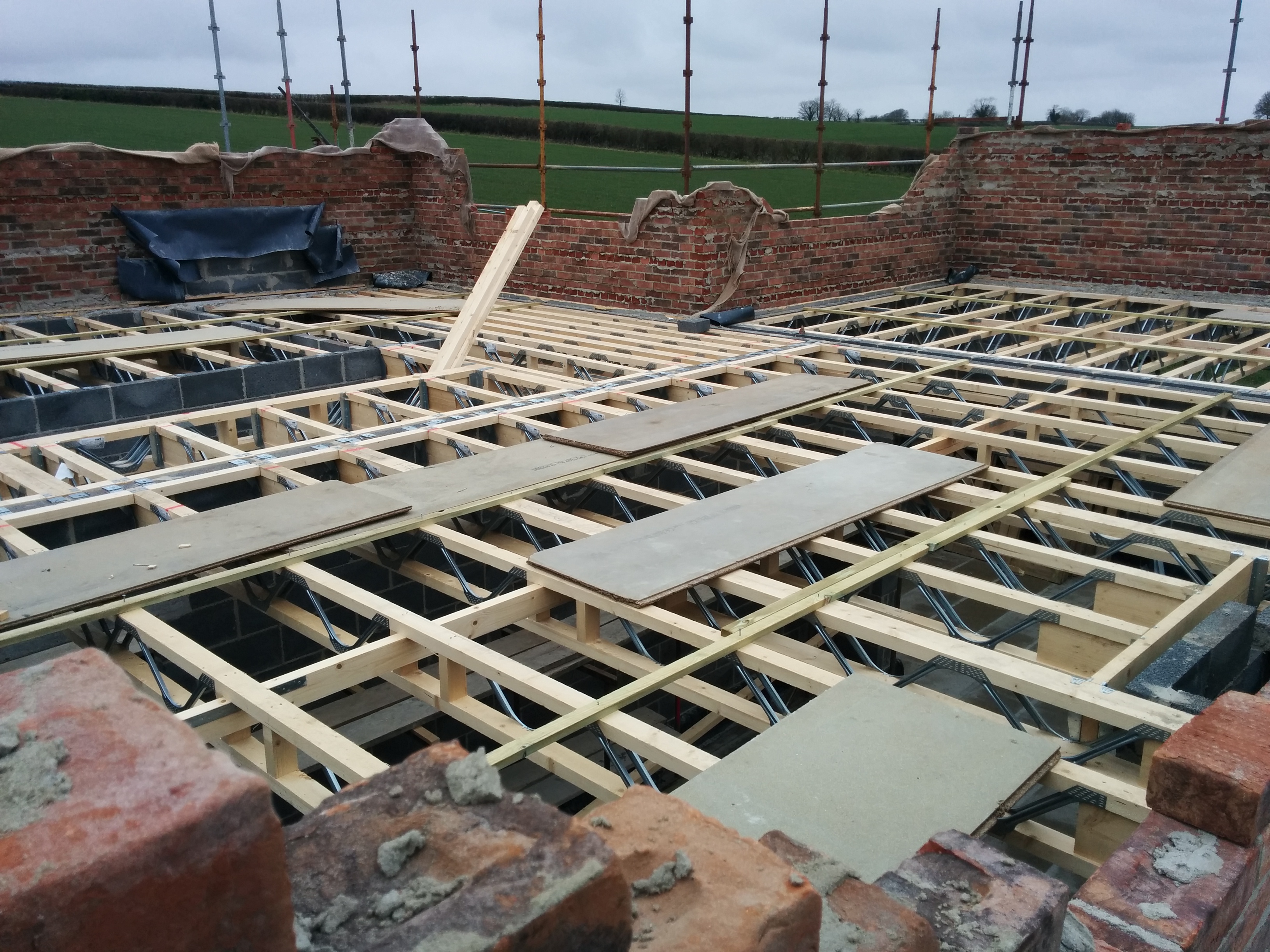

Floor bounce - PosiJoist Floor Vibration checks
Yes, nearest the camera is joists that make up the floor that bounces most annoyingly - you can just see the chimney. I'm going to try measuring the flatness of the floor using a rotating laser level as a reference - though with carpet and underlay down it is going to be tricky to note less than a mm but now that I can see the difference just across the bathroom door gap I think there will be something I can measure -

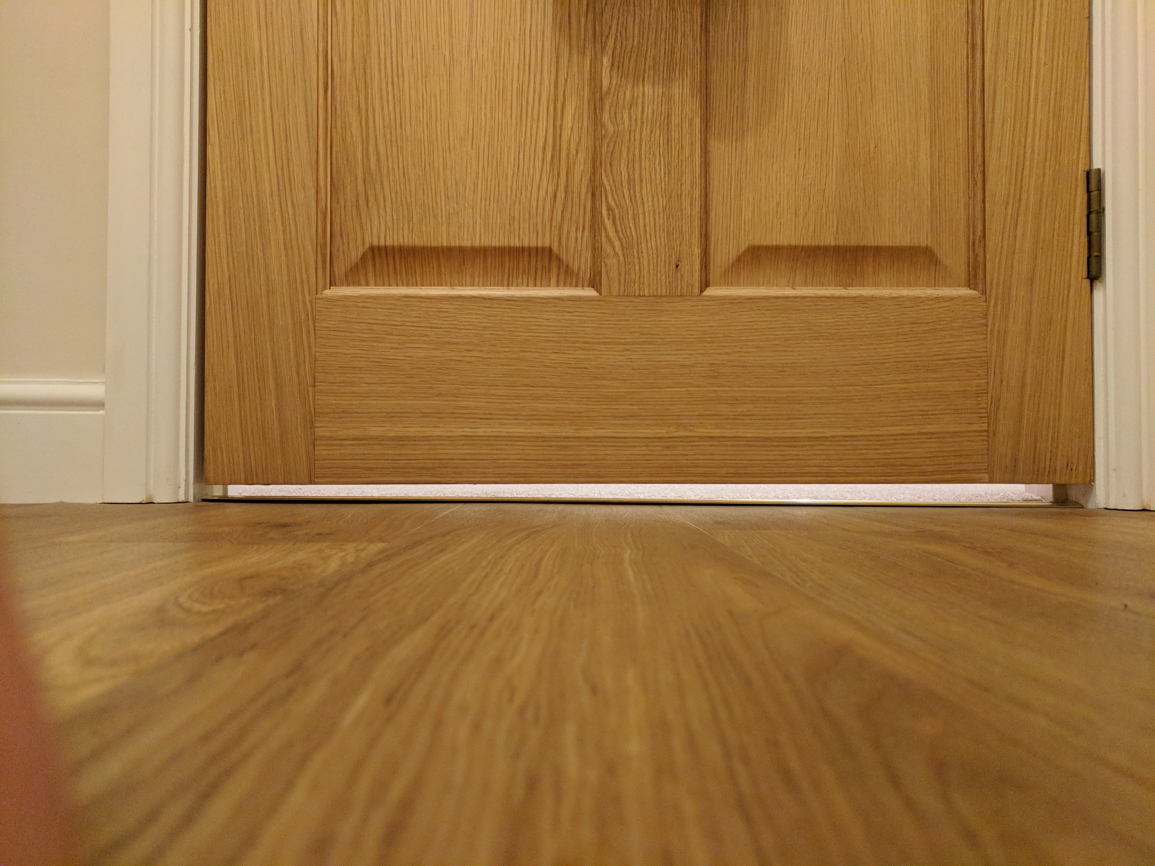

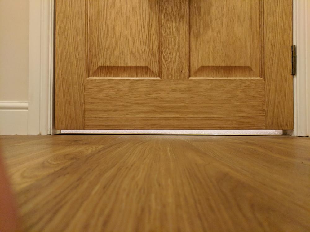

My partner's bathroom is part of the floor I'm at issue with. She just informed me the door gap looks odd. The door does not natural open or shut so I'm taking it as being a true vertical. And assuming the door bottom is 90degree to the vertical then this looks like confirmation the floor joists are not installed correct. Other reasons ? -
Unfortunately I don't know and the various photos I have are not that clear on that detail. The joist hangers used do not seem to have the two round holes shown in PSD05 - should the joists be screwed/nailed through these holes (if they exist)? The drawing does not seem to state if screws should be applied or not through these holes -
They are indeed into joist hangers - I think the builder proposed these to help limit drafts into the thermal envelope No idea if pre-cambered or not, difficult to assert now I fear. -
Yep our wardrobe doors do exactly that :-( I'm at a lost who to question builder gave the job to the merchant who used a local posi-joist manufacturer and they used software supplied by MiTek - who I think own the posi-joist design. -

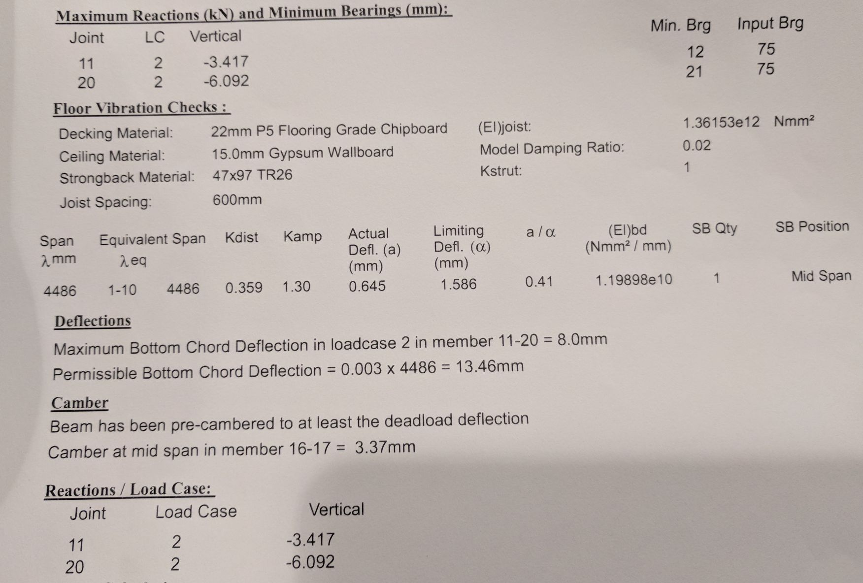

So I'm still trying to get to the bottom of why we have to tip-toe across our master bedroom otherwise the floor flexes causing all manner of things to move. Anyone able to tell me what the MiTek software used in designing PosiJoists 'Vibration Checks' section is trying to explain please?
