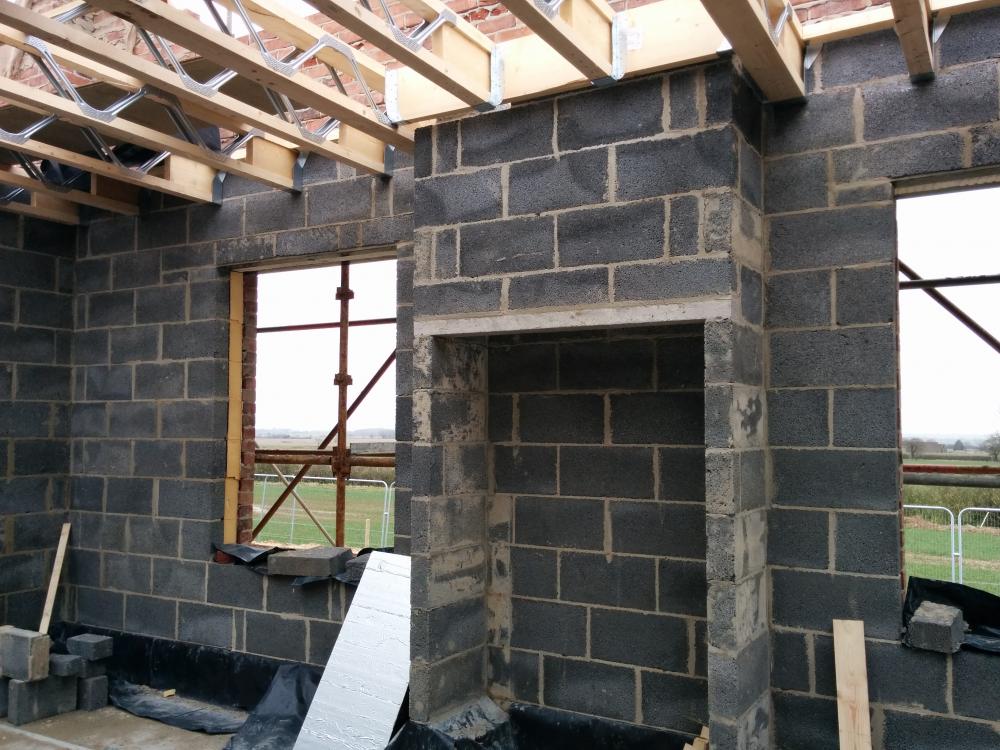

I think it is a trick of the camera as it looks level in the photo in this post: -

Thanks all, I've yet to try bracing that area from underneath to see what effect it has. I did notice in a separate part of the building not all the holes in the hangers where filled with nails - so suspect this floor (fitted by same builder) likewise is missing nails - as pointed out by @PeterW Nor can I see in my various photos any sign of packers to brace joist against the wall once installed. (If I understand correctly the implication is that there should be some). I now have the 41 page pdf document of posi-joist calculations but I'm reluctant to post it publicly while this floor issue remains. I would really welcome someone with a bit of posi-joist knowledge having a quick look through it if anyone has time, just to confirm the design is acceptable. That would be really appreciated. -

@Simplysimon I've managed to find this drawing. It does not give much detail so I've asked the manufacturer to see if they can send me a PDF version of the calculations - some 40 pages! -

Wow 147mm wide @ 400mm centres looks a thousand times better than mine - (even though my span was only 4.5m) -

The sag I measured is static The bounce I get when someone walks around is too small to measure with my gear -

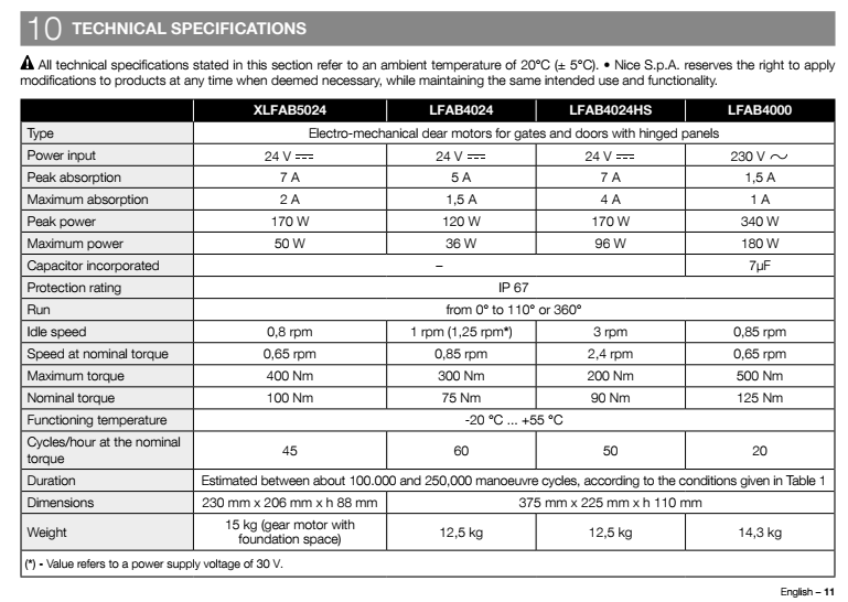

Darn was hoping could use 24v from the house to save digging up my duct to repair it for 240v. These automatic gates getting tedious, think I might tell my partner she'll have to open/shut them manually instead Thanks all -

400mm centres too? -

I had assumed the entire system was 24V - but will investigate -
Following on from: I've been looking at the Nice 24V gate openers. Just wondering from these spec which says 7A at 24V is worse case - what size cables should I use for a 25 m in duct cable run? Many thanks Paul

Using a spinning laser level on a trippod thingy I reckon there is a 4mm sag in the middle of the room. Bit tricky to be sure as measuring with carpet and underlay in place. Took plenty of measurements. Anyone else with 4.5m posi-joists able to tell me if they likewise have any sag? Thanks Paul -

No down lights but a central rose might just let me poke a small camera in -

The centre of the room (which is also inline with the chimney) is the worse place - but the whole room moves and rattles as one walks across it to be honest -

From the floor plan just under 4.5m
