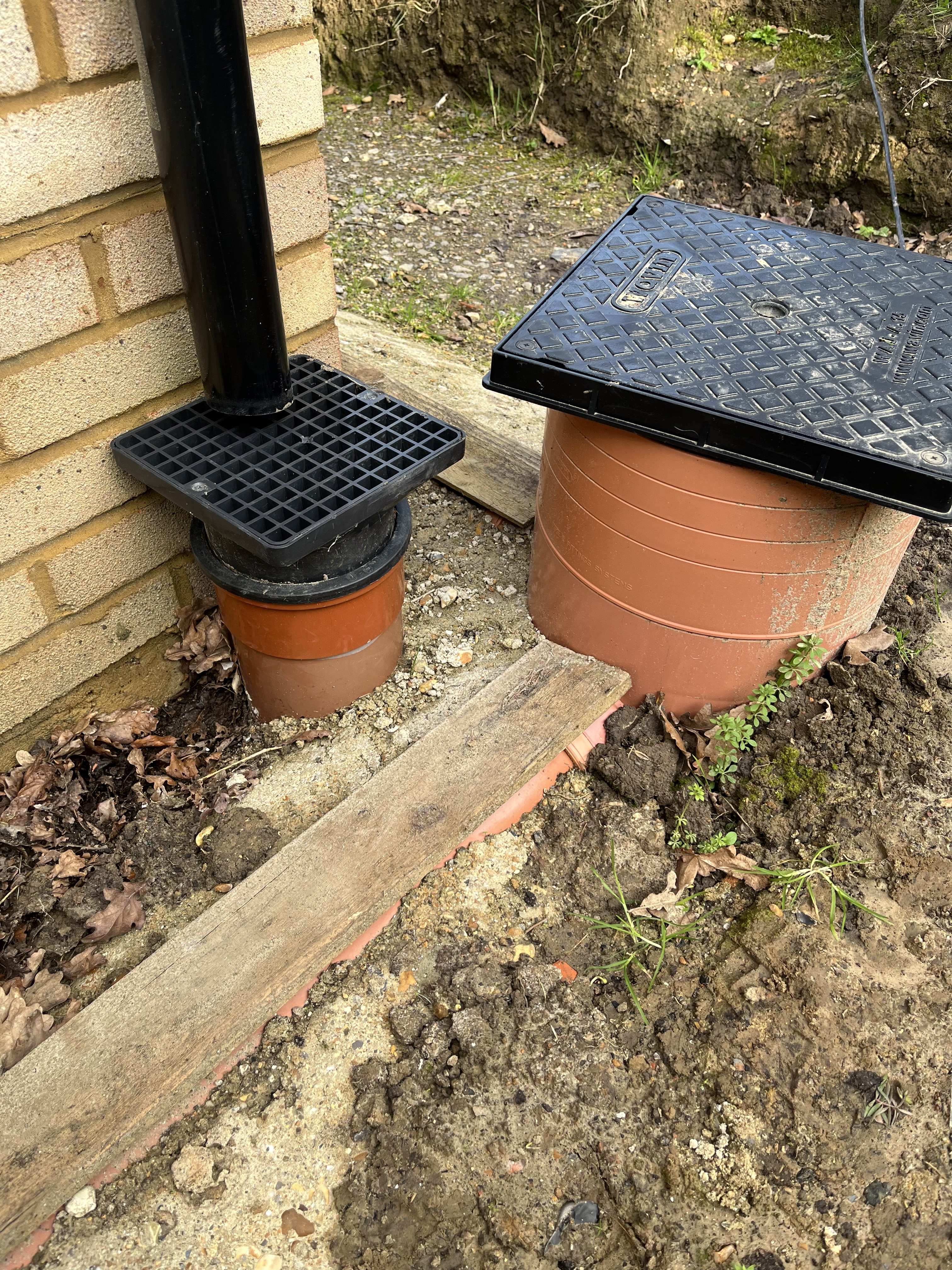

That's what I had to do. Had to break out a load of concrete to get access though, which is why I was looking for a short cut. Decided to do it properly though -

It's an option, but more hard work than connecting directly into the access chamber! -
Following on from the other topic I just posted, it would really help if I could connect to an access chamber (300mm) the same as in the picture (note it's not this one!) There are no spare inlets, can I create one in the riser somehow? Note that this is surface water, not foul. It would be a connection from an aco drain.
As per the title, is this possible? I've found 110mm hoppers with solvent sockets, but the riser appears to be around 150-160mm diameter. Surely there is a solution short of getting the hole saw out? https://www.toolstation.com/square-hopper-110mm/p71607?store=null&utm_source=googleshopping&utm_medium=feed&utm_campaign=googleshoppingfeed&gad_source=1&gad_campaignid=21019175163&gbraid=0AAAAAD-vLcXXXI5YTIGEGSG3qJOU7d06k&gclid=CjwKCAiAqprNBhB6EiwAMe3yhghXuo0-GWuBtdc3XxZJyOIMk0tlIYiI_Xj62GxKj9Jw_SYKfFeANhoC7NEQAvD_BwE
