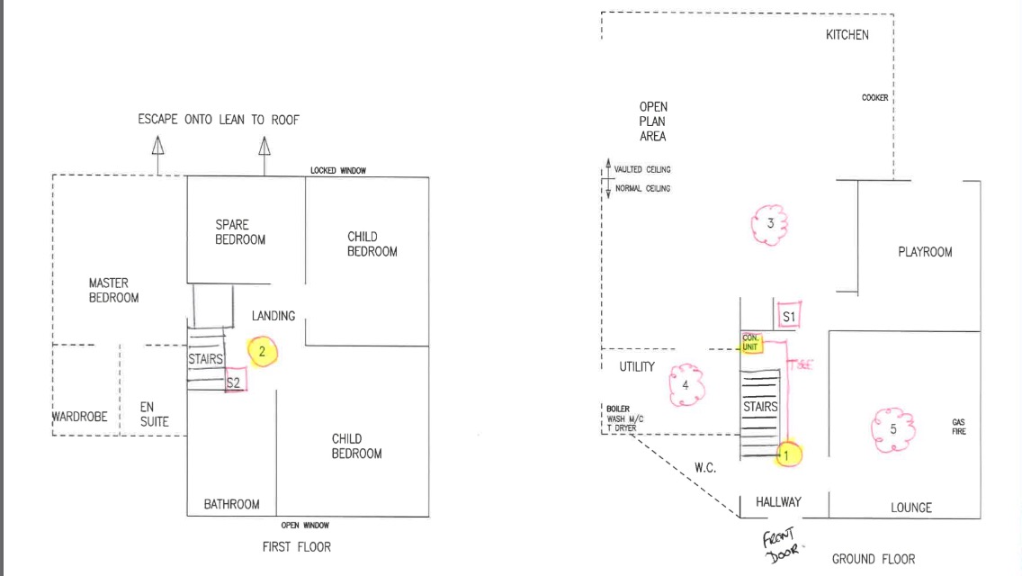

From further investigations I am confident I have identified the "power" lead to the first alarm and the lead between the two existing alarm positions. I've disconnected this joint between them but to keep things safe I have terminated the end of each lead in separate old fashioned junction boxes and switched off the MCB. This is under the carpeted landing so reasonably accessible at the moment. I've also sort of laid a length of 3&E as described above so the bathroom floor should not need raising for this issue at least. I'll look for alarms themselves in a couple of weeks.

I'm due to cover up smoke alarm 1 very soon so will be taking the opportunity to put some cable in the floor and hope it's suitable. As before, the T&E from the CU is existing and goes alarm 1. From there, the 3&E will go to alarm 5, back to the space by alarm 1 out to alarm 3 and back, then up through a cavity wall to the loft to alarm 2 as shown. Approximately 33m which should be ok for 5 smoke alarms on 1mm2 cable. The link between 2 and 4 will be trick and worked out later. If I moved alarm 1 about 500mm so it was under the landing not the bathroom floor, I could maybe come back to this later although the I would need to leave a cable or drawstrings in place between 1 and 2 or I find another route up to the loft from 3 up the bedroom wall or something.
This will be fine.

Having cleared the brain fog, I'm now looking at a smoke alarm layout here:
Following on from my questions, I am a lot clearer on things so I'd like to start a fresh thread focussed on a design. Smoke Alarms 1 & 2 were installed (badly) before the extension (shown by the dashed line) was built. They are connected by T&E not 3&E so were never interlinked even though they should be. I'm trying to find out the requirements I need to meet i.e. Buiding Regs and not break the bank. Consumer unit is under the cupboard under the stairs and the alarms have their own MCB switch. Alarm 1 has a JB with a cable in and out (floor void) and Alarm 2 has a single cable to it (in loft). So it looks like the Consumer Unit feed alarm 1 which feeds alarm 2. In doing some work in the house I now have an 'easy' route from alarm 1 to alarm 2 to replace the joining cable with 3&E to make them interlinked. But this does not address the issues with other alarms I may or may not require. The potential alarms are shown in the bubbles, 3, 4 & 5. The kitchen will require an alarm, shown as alarm 3 and I can get access to the normal ceiling area shown from above with 'moderate' difficulty. Nothing else planned for this open plan area. I'm not sure if I require an alarm in the utility but seeing as it has the boiler, washing machine and tumble dryer and its under my bedroom, I think it should. This alarm has 'moderate' access back to the consumer unit but 'difficult' to link it to one of the other alarms. Alarm 5 I am not sure if I require but it is another lounge area and has a gas fire. Again there is moderate access to installing in this room and linking to the other. Also, it would be nice to have a reset switch, shown S1 by the open plan room. Will one downstairs be enough? Do I require S2 shown upstairs? Alarm types to be confirmed once layout and requirement for alarms is decided. Also there's the loft(s) I suppose but no plans for those at the moment. Note, I don't intend doing the terminations myself now but I may have to put wires in the correct locations myself now for a professional to terminate at a later stage.
Raiding my ebuild account has brought up this: http://www.ebuild.co.uk/topic/18486-hard-wired-smoke-alarms/ (Save your breath, comments previously on ebuild) so the bathroom floor void one is the first alarm and the loft is the second, on a 'string' not a 'loop' as there is only one T&E Bloody hell, almost ready to consider an alarm plan.
