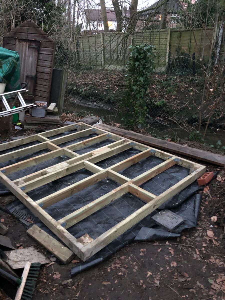

  3. We don’t get snow down here. Too warm with all the Chelsea tractor fumes. theres really not much to see till the shed goes on. By the sixth bag of postcrete I’d worked out how to do it, I.e. just leave it alone. It is a far more accurate construction than some studwork I had to do in the house...

  5. I am making Onoff magnitude increments of progression here. I had a 8’x6’ picture frame concreted into the ground at the start of the weekend and I now have a floor structure with joists and noggins and the scaffold board flooring sized ready for screwing down. TRADA tells me that 4”x2” is ok for a 6’ span. Well, maybe if I was using proper joist hangers... but once fully ’nogged’ it’s fine. Will be solid with the boards on top. Only fly in the ointment is that this nominal 8’x6’ shed is bigger than that so I need an extra 2-3” of floor width than the anticipated 8 board widths. So I’m going have a fashion some sort of fence arrangement to trim slices off another board for filling one or more gaps. so far this has cost about £50 for wood (10 x 2.5m C16 green treated 4x2 + 2.4m of 4x4 fence post), 6 bags of postcrete, approx £27 and small heavy duty brackets, £12 and some landscape fabric, £15. I have rooted round for fasteners from my stash, some 100mm screws I won’t use elsewhere and a box of clearance SS wood screws which helps a little. Saves money but also means 0.00032m2 less stuff to store in the shed when it’s finally built. A new new roof will be the budget buster but I’d don’t think I’ll be doing that for a bit. The galvanised ridges salvaged off the old garage will cover the gap in the roof for a few months.

  8. How to dry out a shed? My shed components are damp/wet and the floor - old scaffold boards - have been in the garden uncovered for years. Fair to say they’re soaked. I anticipate the shed will be watertight but nowhere near airtight. It’s needs a new roof covering which will be EPDM when the weather improves. without a purpose built shed heating device, I am tempted to light the bbq and leave it is the shed overnight for several nights to kickstart the drying process before using it. Of course I won’t burn it down, it’s far too wet to burn... any obvious ideas I’m missing?

  17. I was thinking its just the same principle as decking. Maybe I should use some decking boards for the floor too instead of a double layer of thin OSB2. spent the day re-assembling the kids playhouse which meant also re-felting the roof. and we’ve shifted 2 FIBCs off cheap bark that we’re sat where the shed needs to go.
  18. Having decided that I’d rather do this in the middle of winter than the summer... the ground isnt level, it gently slopes toward the brook at the bottom of the garden and I don’t really have anywhere for the spoil at the moment. I wonder whether its reasonable to create a timber base frame, 8’x6’ (400mm ctrs) and then raise it off the ground with 6 short 100mmx100mm posts, post-creted in? 6 holes dug, drop the frame on, prop it level just off the ground, then fill the holes with post Crete. how does that sound? question, how do you stop wildlife getting under the frame?
