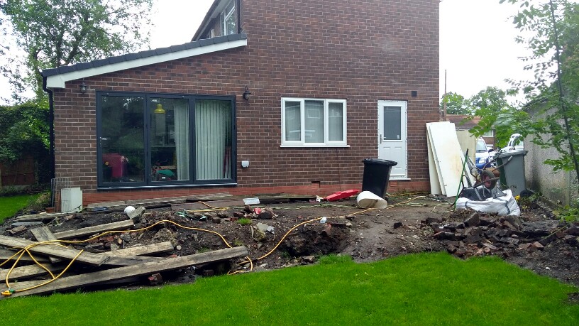

So this is where the patio will be. As high as possible under the bi fold sill, coming out 4ish metres with 1m ish retaining wall. All that material you see is backfill. One builder told us that any patio would soon be a mess as the backfill settles - which is can understand but I was expecting to put a proper concrete slab on it anyway. Instead he suggested a suspended patio on block and beam. Waiting for a quote back for that but sounds expensive. Could a ground bearing slab be put on the backfill?
This is the side of the extension where the drain turns 90 degrees and heads toward the front of the house with another black plastic inspection chamber which is vaguely located near the base of those scrap doors leaning near the corner. Over this area we intend to build a serious patio. I expect the pipe will again be just be covered by backfill, nothing graded. But will be a lot deeper than the first section. Wondering if this will need redoing before we build the patio. Also, where I took the photo from is approximately where I might want a drain from a future garden building. The grass is approx 800mm below the level of the right hand inspection chamber and about 10m away. This is where I'm wondering if I can get enough fall for a new drain from the garden.cant remember how deep that chamber is and garden ground workers put some paving slabs over it to get the machines into the garden.
So this is the back of the extension. Furthest input into the drains is on the left, the kitchen sink and dishwasher outlet. The pipe is so close to the current surface with just backfill around it. Nothing screened or sand or gravel. Intending to put a path above this along the rear of the extension. With steps down on the left hand side which means this pipe will be in the way. Could easily move the outlet to the right hand side so there isn't so much badly installed pipe so close to the surface. On the right hand side of the picture, there is a black plastic inspection chamber under the planks to the right of the down pipe

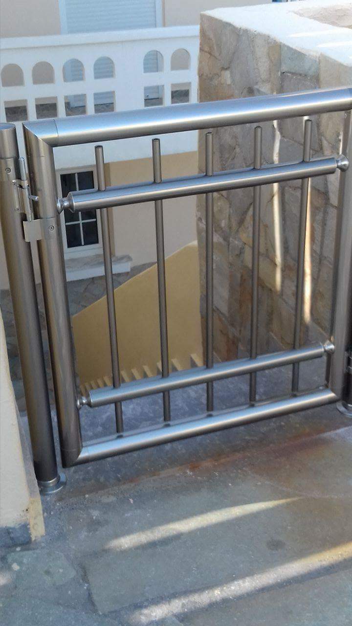

Thanks. I'm expected to magic up something before Tuesday so its not just shipping cost that's the issue. I just asked incase someone knew of something obvious that I was completely ignorant of. https://picclick.co.uk/Elgate-Gate-Latch-DLABP-D-Latch-For-Round-Post-171130194005.html Australia -

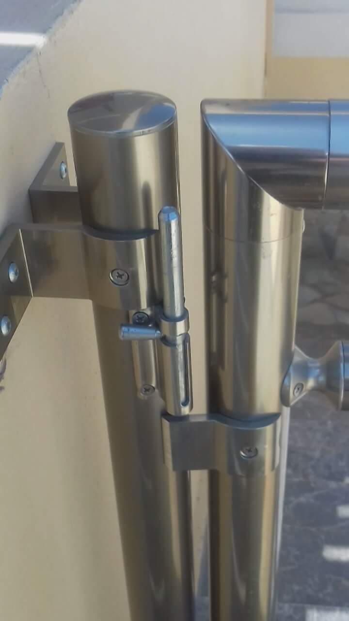

How many saddle washers can be found in your bathroom Not a proper solution is it? They say its aluminium but I've no idea. Whatever it is, it will be a standard size for this application. -

Been finding US stuff but was hoping to get a UK or EU supplier. -

They all look like flat versions, I'm looking for something to fit a tube. -

I'm being asked to source a falling latch for this gate to replace the sliding bolt type lock. See pictures. I have asked what size the tubes are, still waiting...
