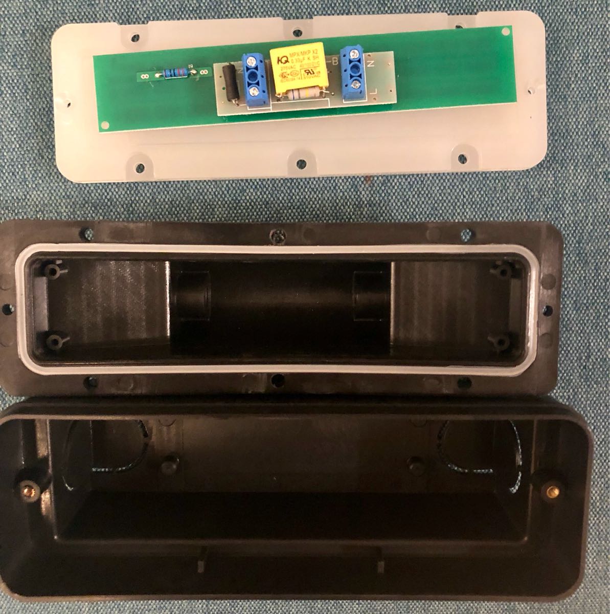

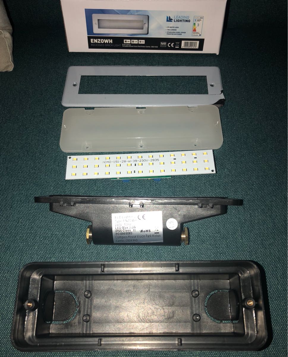

The back of the wall will be infill and covered by a patio. No future access from behind. Front access from brick shaped hole only.
Its going to be a block and (eng) brick solid wall. Brick left out for the light, then I would be going round to drill the block for the cable run. I doubt there is enough room in the brick space for the light and a JB but would have to measure it at home later. Plenty of room on the back of the blockwork but I don't have an electrician let alone one planned to come before the wall is back filled to terminate the swa into jbs and put a flexible cable into the brick hole.

Is 3 core 1.5mm SWA going to be any easier to work with that 4 core? O.D. is similar 11 & 12mm and still bend rad of 8 x O.D. Looking at how the cable goes in the light the cable needs to go in and out at an angle not from behind, perpendicular to the light. Also I'm not sure that the cable will go into those brass inserts... These cables are going to need to be exact lengths as there's no scope for curling the cable up in the hole like T&E. I won't be connecting any wires to anything but I will be the one going round pulling the cable into position and drilling through the back of the wall to leave the cable in the correct location before it is all back filled.

Back on topic, not sure that 4 core 1.5mm swa will fit that 20mm flex ducting. Lights from @Onoff rs elec supplies link. Not sure if safe or not but can’t burn a patio down. got a couple of cardboard tubes in lieu of ducting if it doesn’t arrive in time. Builder will be thinking, wtf?
