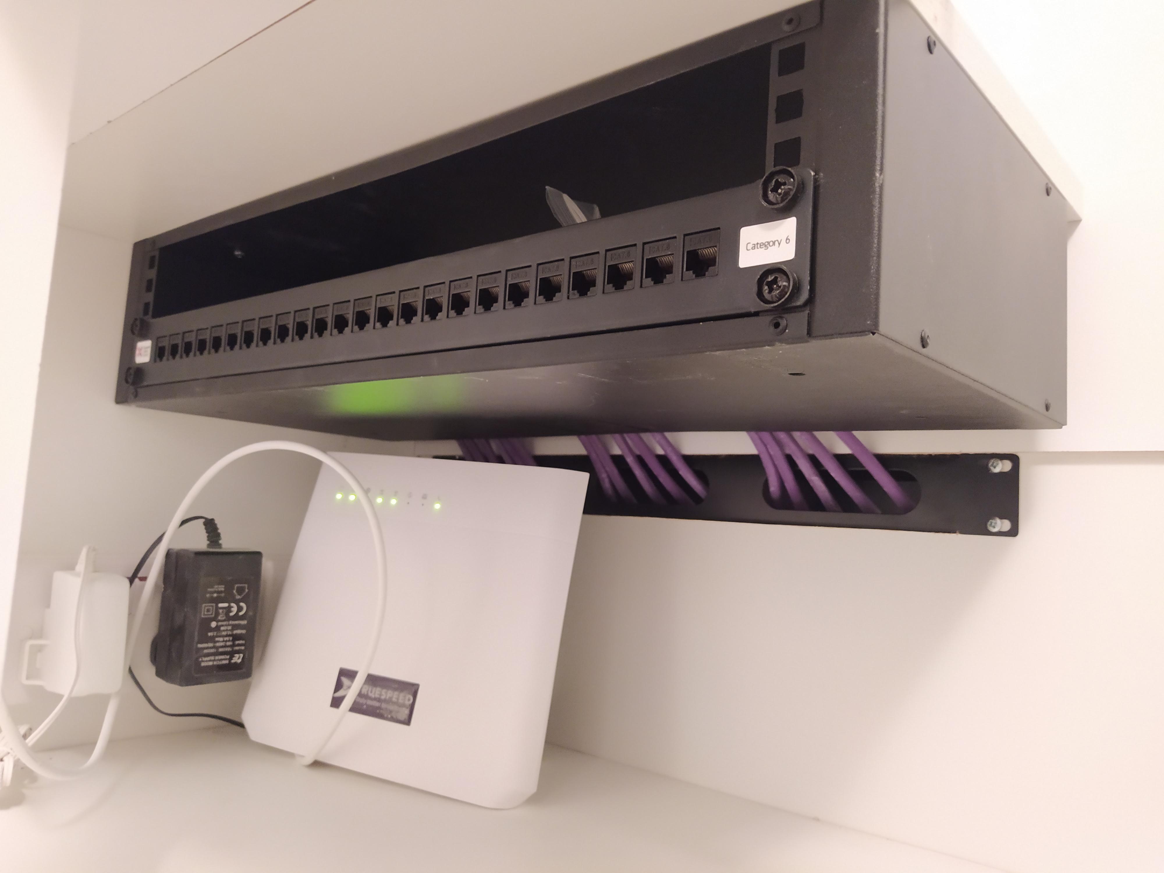

I have similar requirements to @Adsibob and will likely follow @JonJump advice and fit an unmanaged switch in front of my router with 2 decent ceiling mounted wireless access points. Currently looking at switch options and it seems that most 19" rack mounted POE options are all managed. Is that the case? I'm looking for 24 port total but only really need a handful POE. Currently have all 16x cat6 terminated and patched ready for the next step.. -
