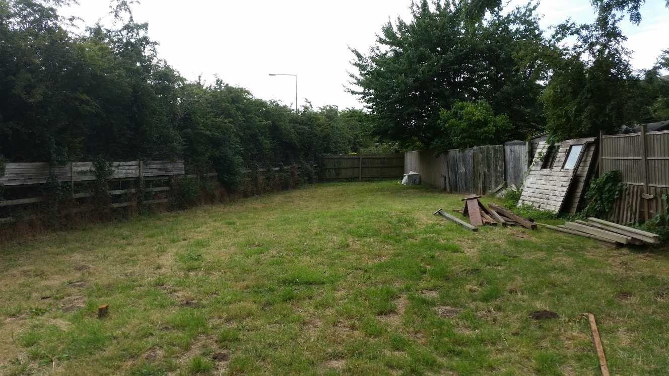

  20. Don't make me panic even more !! I just read the soil report <it just landed in my inbox> and if I am reading correctly.. as well as a gas membrane (methane etc) .....dt to being within a 250m landfill buffer (1970's) I might also need to "scrape 600mm off any soft landscaping or lawn and replace with CERTIFIED topsoil" I mean its a meadow ....its always been a meadow (or part of one) ...I have eaten fruit and veg from it, the grass is lovely and green. But I am expected to throw away 100 tonnes of great soil? (see pic) ..the moles LOVE it too !!! <alternative being> to go down a route of test pits, pipes in the ground, 4 months of testing, send stuff to labs.....OH and fork out £3-£5k I must have been a bad man in a past life
