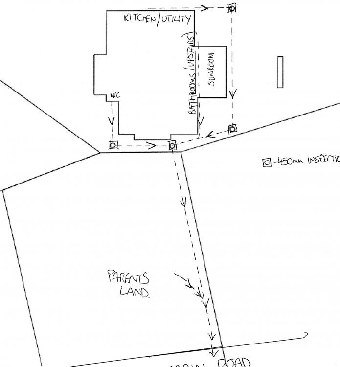

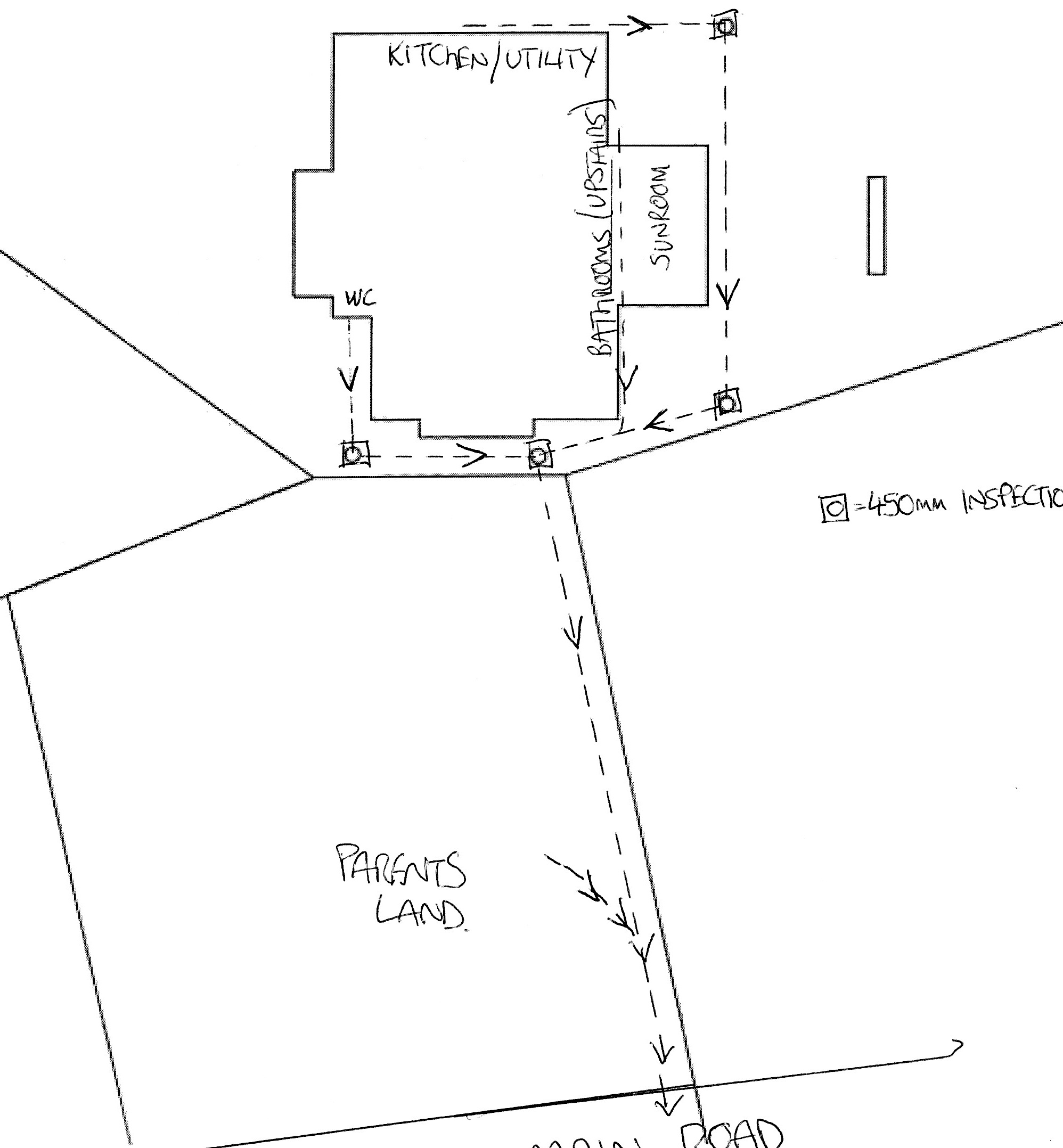

thanks Peter ...I feel like I am back at school Work getting handed back with lots of RED on it ... remember the old "See Me" they used to put on it ? I wonder do they still do that LOL * I get the top bit ..that extended line is a" Rodding eye" right? * and then it runs the full length (about 15m) picking up the downstairs WC, and that "angle" is OK ? i suppose after all there is no other "chunky" waste going down there ...except the wifes leftover lentils ! *On the right hand side, I can see that it runs UNDER the property, would this also have a rodding eye at the top right, as i keep reading that it should be rodded "downstream" only ..would that be right? sorry for the questions PS. I suppose the optimal place for the "stench pipe" is just above he sunroom in the image (to the right of it as you look at it)? and am i right in thinking the downstairs WC does not NEED a stench pipe at all ?..to be honest i dont really understand their "mechanics"
- 17 replies

I think i MIGHT be over thinking this sewage diagram. Perhaps i am going loopy with inspection chambers I have been advised that its FINE to run waste UNDER the slab ...but I don't like the idea of it ... ..Do you know what I mean ? I like to be able to get at stuff without demolition ! Anyway ...I have been looking at where waste will be originating in this build 1. Downstairs there is a small WC and of course a fair bit of it coming from the greywaste in the kitchen along the wall 2. Upstairs its all located along the one wall ...basically above the sunroom, well not exactly ...but you know Now if these sites I am reading suggest that every time you make a substantial turn, you need an inspection cover ? Well as you can see below ..I will have FOUR ....is that normal ? Also as we are PICKING UP our parents waste (they are currently on a cesspit) its a fair run out to the road. When i manage to get the top off and check the invert level ..i hope i can get enough fall along this legnth , as I am guessing the more manholes ...the more STEPS DOWN i will be going ..and may well end up UNDER the Road Mains That will make me a gibbering wreck !?!?
- 17 replies

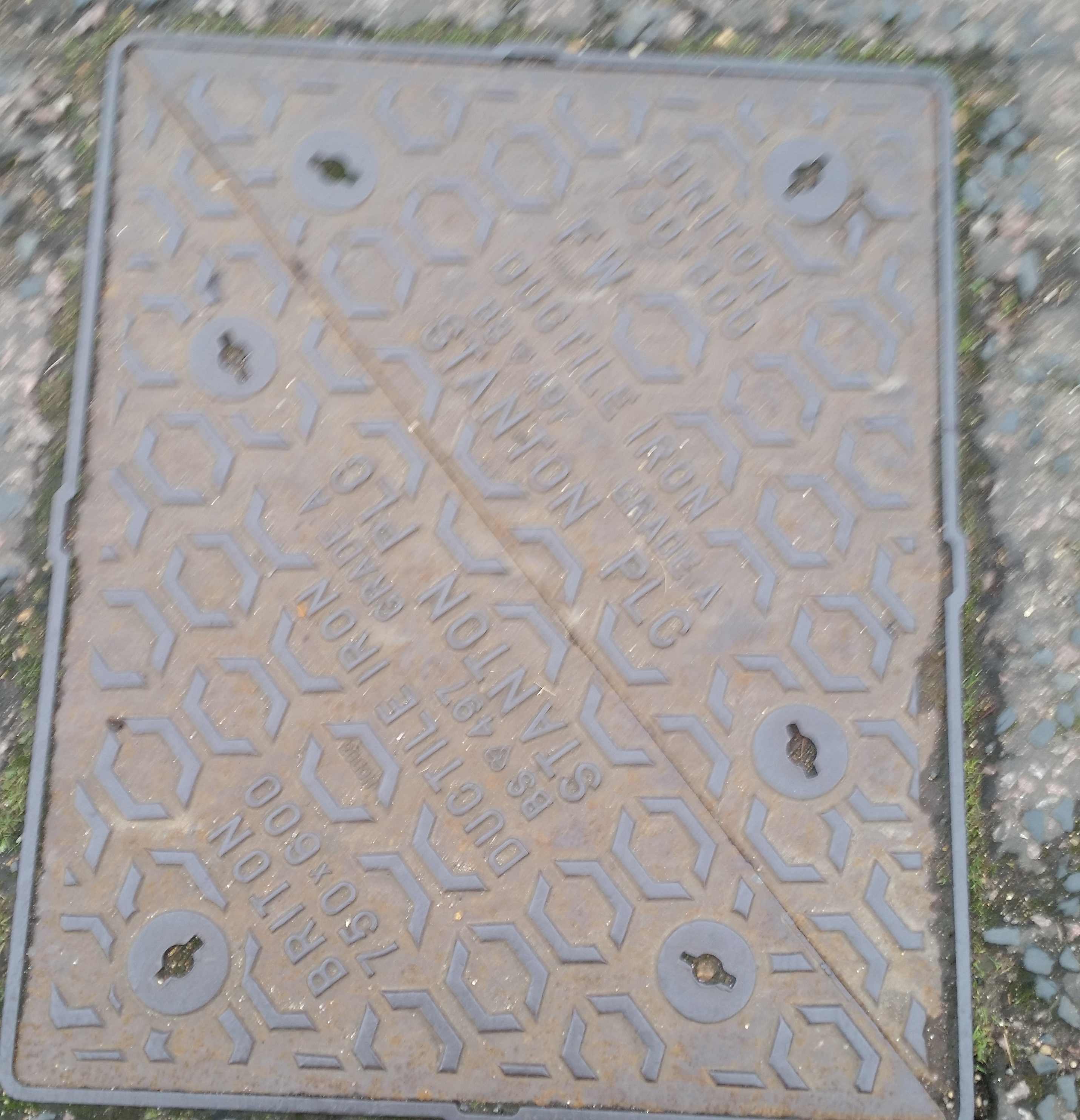

well, I have called it quits for today ... the bar gets it up ..but not enough to get a wedge under it as the lip on the lid must be at least 3 inches, I am guessing both sides need to be lifted SQUARE or they basically jar so the full time results are ... 3 hours, 2 men, 2 steel handled grafts, BIG screwdriver, lump hammer, 2 manhole keys and a 4ft crowbar = 0 Manhole cover =1
- 17 replies

Good Idea Peter ! Brute force to avoid a £70 a day hire charge (for hydraulic lifter) ....I like it I had a little blue one in the garage ..but i am thinking i will mosey down to Screwfix for this BABY !! https://www.screwfix.com/p/roughneck-gorilla-bar-48/29330
- 17 replies

Will do thanks J.. I just trotted out to the road with my newly purchase £8 manhole keys to get a quick invert level ..(whistling as i went) WELL..I was ambitious to say the least. I was swinging back on them like King Kong on Big Ben and I am 20+ stone ...and i think it moved precisely 1mm So i thought ..I know !! ..I will put a pick axe in the hole and get some leverage ... Yes...you guessed it ...snapped the damn handle in half LOL Either these drain covers are stuck or they weigh 100 stone ! maybe both!! it is a SPLIT cover ...now I am thinking perhaps they need to be lifted in some sort of sequence ? or perhaps they have been welded or fixed together God ..I feel weak ps (I stopped whistling) PS just in case you all think I am daft..i DID ask Anglian water for this information, and the gist of the answer is as follows: We will send you an area map of the sewage and water supplies in your vicinity, with the various manholes marked on them. a) No we cannot guarantee these diagrams will be right as work is constantly ongoing and you may need to cross check with your local authority planning department* b) We cant give you an accurate invert level, as if inaccurate (due to surface changes) we could be held accountable, but you can measure it yourself, no problem* * not verbatim, but you get the idea
- 17 replies

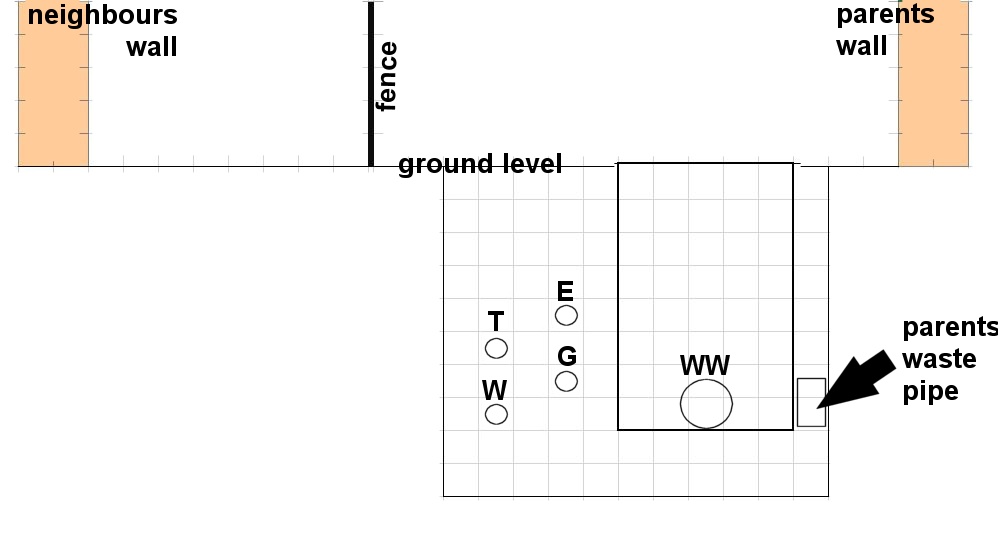

thanks Nod I just have a LOT to squeeze in one trench to be honest its this "underground" stuff that frightens me the most.. ..what with the pipes going UNDER the sunroom are back at the house, and everyone talking about 1:50 and 1:80 falls etc some people are telling me that I will need a soakaway as "they" dont LIKE you sending rainwater down the sewage drains ...but i cant find any reference to it ..good or bad on the forms i have (sigh) *they is normally meaning the council/BCO/environment or any other God-Like entity that makes rules for us to follow
- 17 replies

Good Afternoon All Well its time to finalise my drawing and sewage and services layout. As some of you know (due to location) ...I am actually bringing ALL my connections past our parents house (on the edge of their land) In return for letting us, we are connecting them to the main sewer with our build half the houses here are still "on the pits" ..including theirs Now I have tried to measure everything in 10cm / 100mm blocks and got the drawing below. Obviously this is the "busiest" part as this is between our parents and next door and it is where they will connect to our sewage via a 450mm manhole (which is that box in the middle Looking at the below and bearing in mind that T=Telecom. E=Electric G=Gas and W=Water and of course WW = Waste water (sewage) Will i be safe using this as a cross section for the Building regs ?
- 17 replies

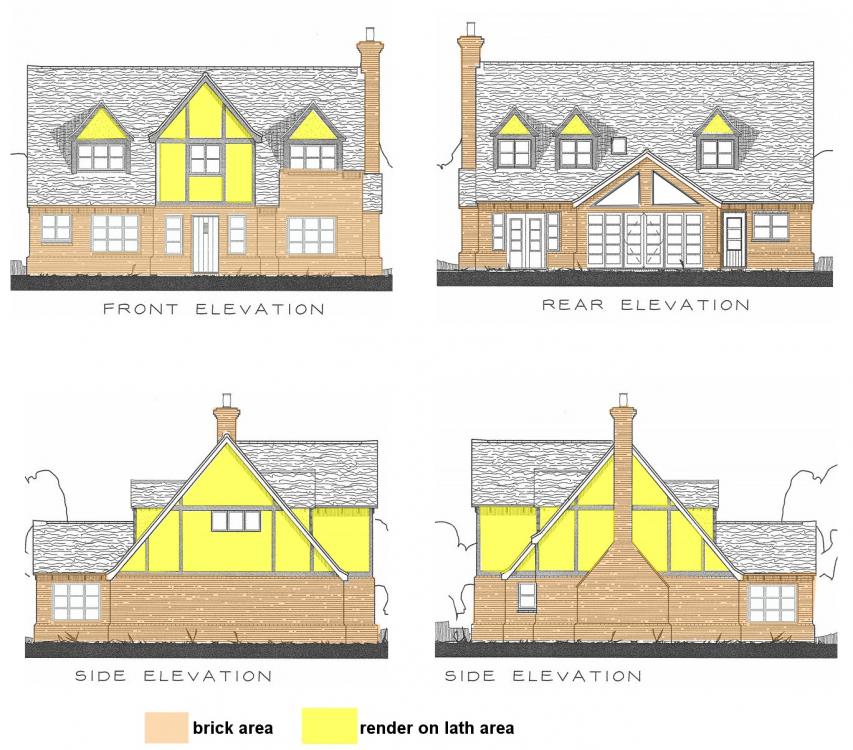

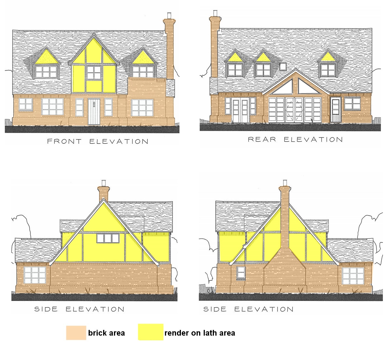

Well as we move into costing (while i wait for final Building regs to be done) I have discovered a strange enigma "Brick Slips" Our house design has copious brick slip cladding, but a REAL brick chimney planned. But ALL the bricklayers we have spoken to don't do them, never heard of them, suggest tilers, and all the tilers we have spoken to (some recommended) have never done them either ...but are prepared to "have a bash, for cash" ?! Now the company that sells these is http://www.brickslips.net/ I have contacted them for a list of their recommended installers in the SE ...tumble weed time! I guess they only want to sell and not get involved with recommending Does anyone have any experience of these, just to give you an example ...Brick slips or Brick Tiles as some call them: here is a video of them going on (although I am not sure this will be the applicable way on our Timber SIPS Potton build
- 15 replies
