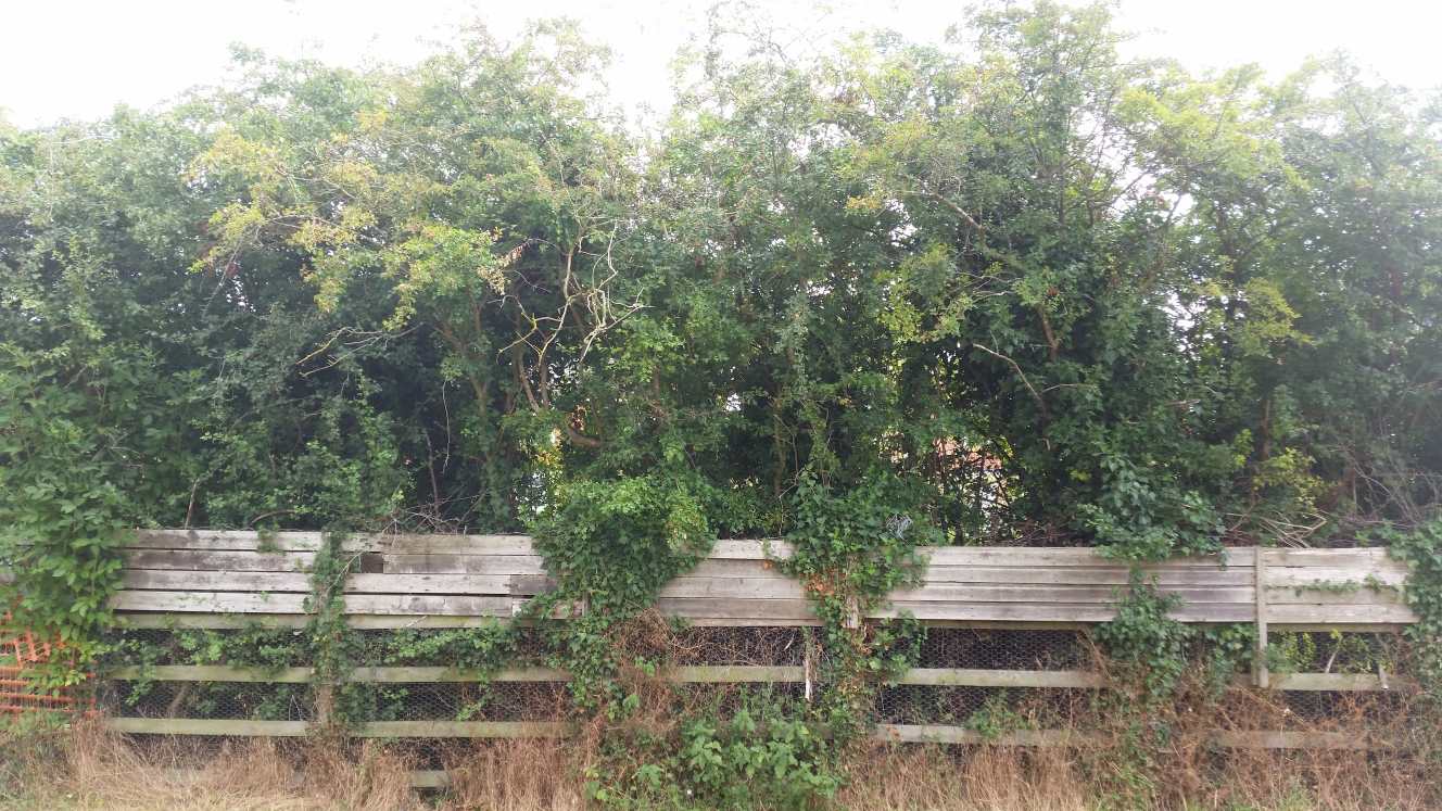

not sure it was "dictating" basically they disagreed with the first stage of planning consultation as they felt that the removal of 3 hawthorn bushes (see above pic) would be a real detriment to the areas "character" or something like that ....I mean i have about 30 of them ALL along my land border ...(on the road side) ...but i needed to basically apply to cut 3 down as without this ...I wouldn't have a DRIVEWAY in ..so kind of essential . dont get me wrong ..I am not a "tree hater" and i tried to enter into dialogue to get guidance ..but the reply was plain and simple ....basically in simple terms it said " i am against the development because i don't think we should be cutting these 3 bushes" ...thats it. I was hoping for some guidance or advice ...but I am afraid if you need to trim a few trees around here you feel as welcome as Salman Rushdie at in IS Birthday Party. OUCH

To be honest i had the Tree Survey done a few weeks ago ..and you are right ..its heras fencing and signs and stuff. Not sure where i should put them though as NONE of the trees are on my land at all LOL..its a load of hawthorns growing along my fence here is a piccie

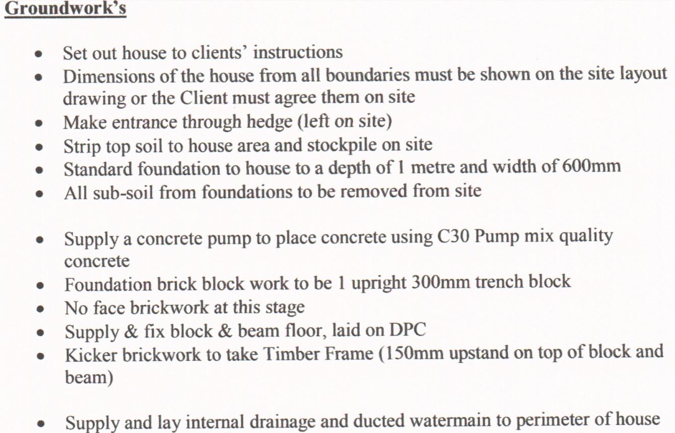

Hi Simon, well I am glad you are underway anyway ...Good Luck with Everything So what you are saying is my quote isnt bad ? Out of curiosity what is your footprint area and where are you located in UK

Hello Everyone, I am progressing with some quotes for the foundations for my Potton home. I must admit, the prices have me a little daunted as they seem to be a lot MORE than I was told about 6 months ago. I am not suggesting I am getting "shafted" but I want to run it past you guys to see what you think. I am building a Potton Timber Frame and have been advised that Block and Beam would be the way to go ....easier and more friendly on the surroundings (i.e better received by planners) The house area from looking at the architects footprint and adding on roughly 50cm around (I just did this to be on the safe side for my working out ...I am not sure if it actually done) ..I am coming up with an area of 121.81 Sq Metres with a Perimeter of 49.82 Sq Metres. Now I have the first quote and it is over £23k, I know this company is trusted and has done many foundations for timber frames...But does this seem expensive? I have snipped the basics from the quote below ..so you can see what it entails ...hopefully someone on here will know what some of the specifics mean thanks

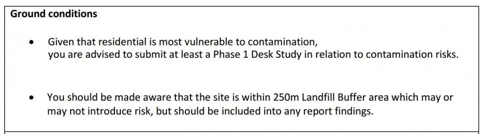

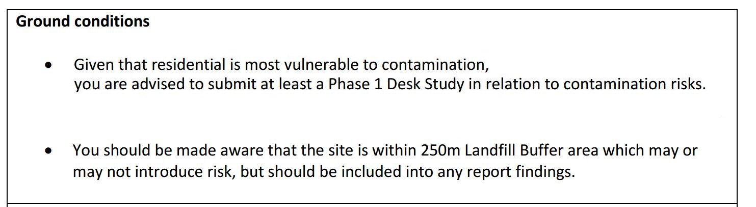

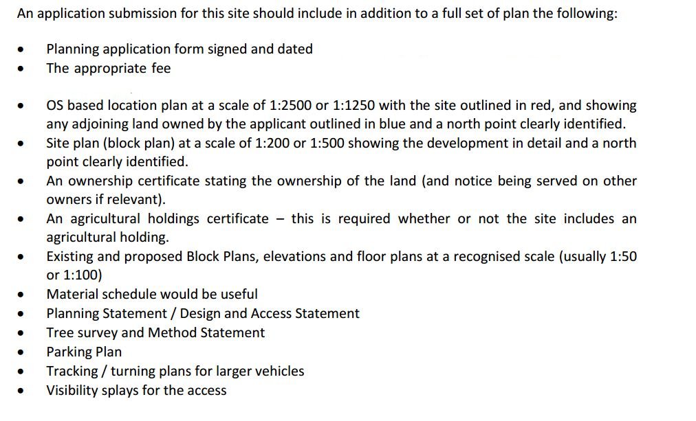

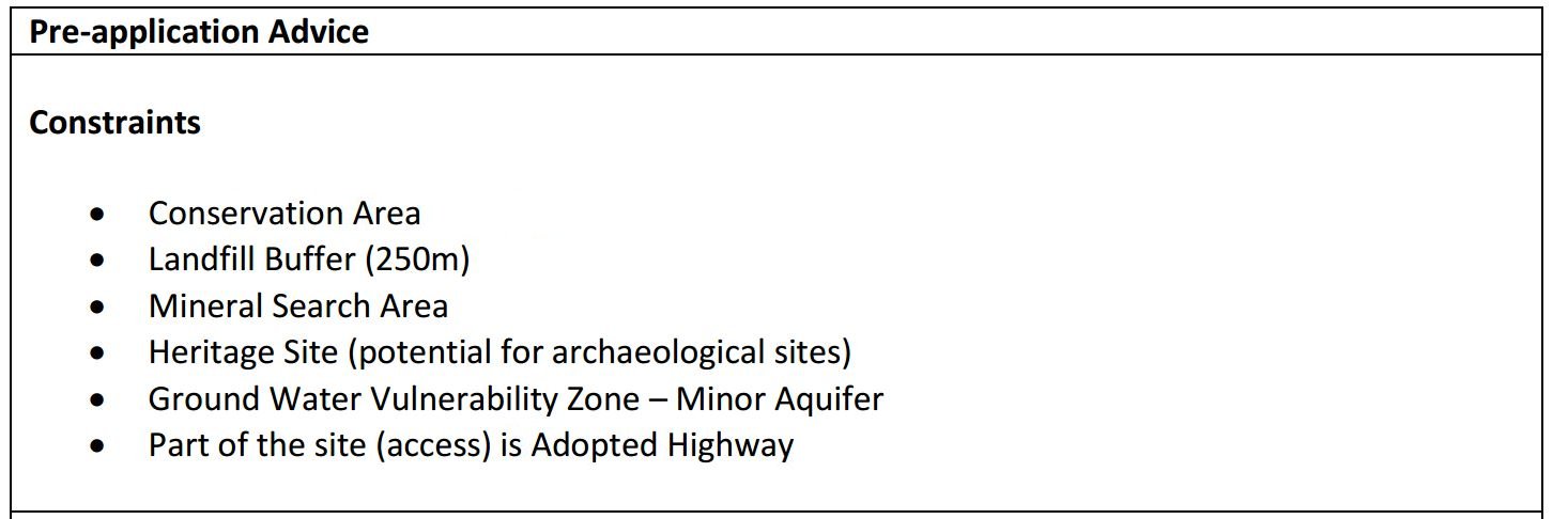

Well I have cut and pasted below what i think are the relevant sections of my Pre-app advice. * the first one is dealing with "constraints" * the second mentions a "desktop study" phase 1 ... * the third is a list of what I need to submit ...it does not mention a phase 1 desktop study on soil?? but I took it from the previous entry on the pre-app advise that it would be "advised" what do you guys think ?

that is a fair point! let me get the exact wording and report back thanks
