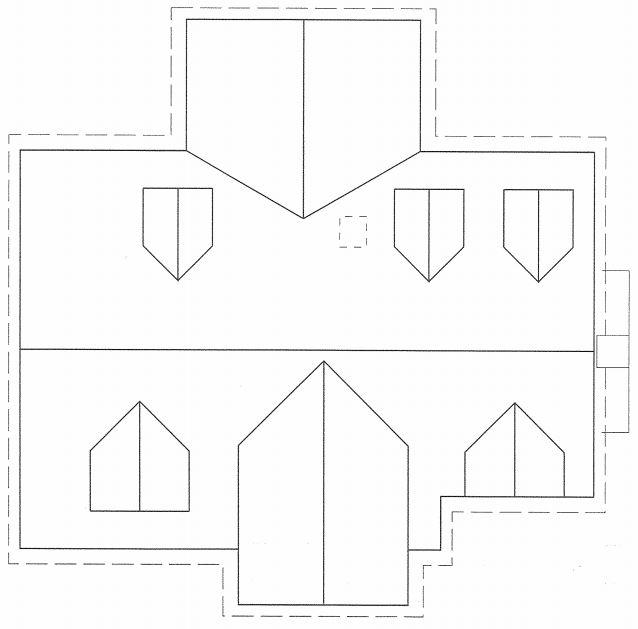

  8. ok so forget the roof "tile area" of 195m2 ? If i look "top down" on my house "squared " it is 12.5m x 12.5m give or take the odd cm so 156.25 m2 But then if i remove the areas that dont have the building on it ...thats taking off 37.75 m2 So the total AREA of the building (and i suppose roof too) is about 118.5 m2 Does that make sense ?

  10. thanks Ferdy, i did think that the incline may add to the volume per second ...or something, but i understand what you are saying. My roofer tells me the "area" of tile is 195m2 But the WHOLE area of my house footprint RECTANGLE is 12.5m x 12.5m Basically the whole grey square below ..and there is lots of cutouts too

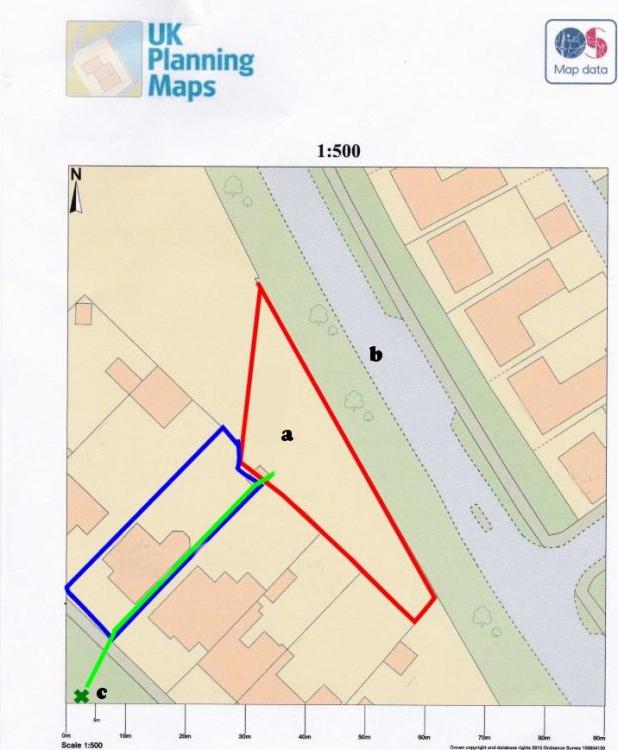

  11. hmm.. thats a fair point Mr Jurassic sir. I wouldnt say its rural .... My issue is I am on a road (where I am the only building for on THAT side) for 500 yards each way There a new estate (circa 7 yrs) across the road, but i am told that it is "unadopted" and so I would need to seek permission to connect to ANYTHING over there. So we decided to connect ALL our services via our parents property/land ...which we effectively back-onto. This has the benefit (for them) of getting them OFF the cesspit and onto the mains in the road, but thinking about it there is also rainwater drains in the road ... The only think that scares me with that is the HORRENDOUS cost of connecting on the main road for Sewage already! as its 20m from their house across a road ....with all the red tape and stuff attached to that

  18. Hi All, I have read a lot of the older posts on BH regarding these, and wondered if anyone had any recommendations. I had planned to put my new build onto Mains sewer, and for those that have read my other posts ..the plan was to channel through parents land to get to the closest access....moving them from an old brick cesspit too Sadly, the lateral that should have been there ..isn't and after spending a few hundred and digging up loads of their garden it appears "anecdotal" tales of the mythical ...spur to all properties ..is just that ...a distant race memory from the 1970's What led us to believe that there MAY be a lateral or spur there is the neighbours connected several years ago ...but this is where a can of worms well and TRULY opened ...apparently that connection is not "legal" according to the water board and no work or application was filed and that i cannot connect to that anyway as it breached this rule and that and the other ...they will now be contacting the homeowner as they have never received a penny in sewer charges .....OOOPS! ..Well how was I to know? (sigh) So now the alternative is for us to "core drill" at 2.7m deep at Main sewer which is about 20m away across a path, green verge and yes ...a road. I have had a few quotes and to be honest ...After everything is done ...I doubt i will have much change left from £15k-£17k ...Which is a killer for us. So I am back to thinking about an alternative ....We have a decent back garden (or will have) and i suppose the front is possible also .. We do KNOW about the older brick cesspits ....and to be honest ..we were not impressed ...emptying at least twice a year and then having to rod it several times also and being stood up to the knees in well ...PIT & SHISS ....Not i deal ..well of course this pit is 40 years old ... I am hoping there is a modern equivalent that doesnt smell in summer and that needs minimal maintenance ...OH, and keep the council happy. Easy?
