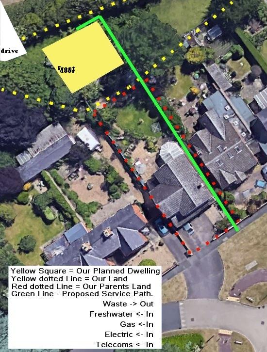

    its tricky as the main waste (due to all the bathrooms and kitchen, etc is on the FAR side. the utility room is ALSO on the far side ....home to our leccy meter and gas meter. so its a good 15m around he house to the border, and another 30m tot he road where ALL the services are. Best explained by this piccie My idea was to dig a trench with enough fall for the sewer, then get that and the water in at about -750mm, then backfill a bit and then put in Gas, elec ...and some sort of "ducting" at 450mm so I could pass a telecom line through .....later it would be a BUSY hole ...but does that matter ? ..I was going to cap abpve the pipes with some protection in case of anyone digging years later ..still deciding what with
  14. Hi all as you MAY know my house is on a very "funny" bit of land and the gaps at the corners are a little (ahem) tight I need to connect to services water, elec. gas (and telecom?) I am connecting via a service trench on our parents land to the road at the front (we are on land behind them) The total length is about 40m (to the kerb at their side the meter boxes are at the opposite side of our house..so that accounts for a bit of the above 1. with the above utilities (once i get the relevant meter boxes in) can i a) just run the correct service pipe ...yellow blue or black down the existing trench to the border 40m away ? b) as it has to go essentially AROUND the house (as I am presuming it can't run through the foundation) what are their rules on turns and bends? gas worries me a bit to be honest
