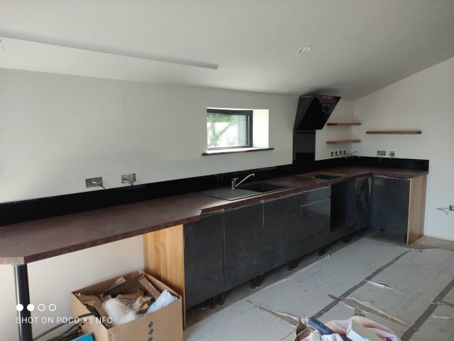

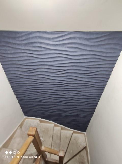

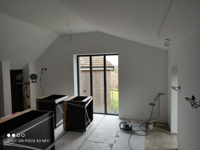

Time has seamed to have gone so quickly and work has not keep up. I thought I would have finished a long time ago but still working through, but some light at the end of the tunnel. Have managed to make the stairs and first fix pluming and electrician has finished first fix then all the plaster boarding and skimming done what a Christmas. My arms did not know what hit them. Now onto second fix so have fitted the kitchen and bathroom out and put in the feature wall behind stairs. Plumbing all finished just need to get the SAHP hot water system commissioned, and second fix electrics has started and also have started to lay the LVT flooring. I used the Eger flooring with the protective covering and did not realise you can`t glue the flooring straight on top so have hade to lay 6mm ply down first but as i am using it on the stairs have also had to add to stair treads to keep the rise the same.

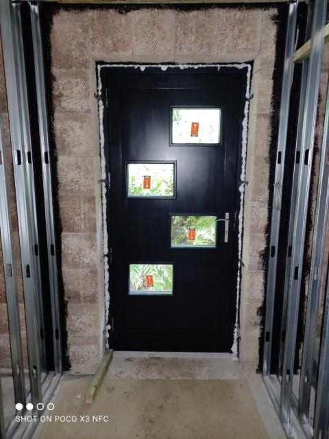

Hi sorry for the late reply some airtight paint but I moved a partition over so one had to be redone but will be covered when I do the parge coat and then dot and dab did this behind pole plate before fixing and around windows.

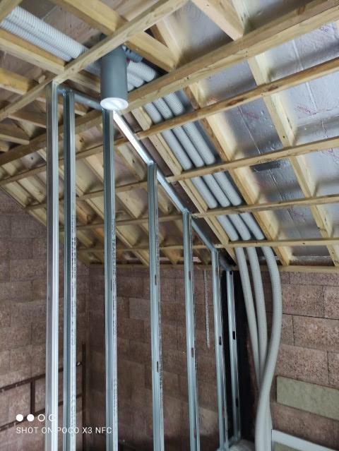

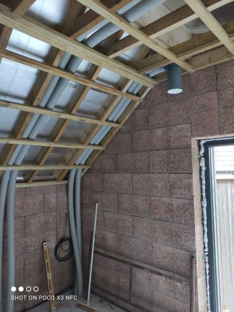

Hi Have managed to get watertight and have insulated the roof in the house but still have the garage to do, In the house I have used 150mm PIR in between rafters and then 2 layers of 60mm PIR, also sealed all joints with airtight foam, using large washers to hold up insulation until fixing the timber for the service void thought insulation into the rafters, then counter batten for plasterboard. Have now started first fix plumbing and mvhr system. So moving on if not as fast as i would like.

Hi Yes you could do this as my windows are wooden I prefer to fix with straps but yes fix into the blocks, fixing hold very well. Keith
