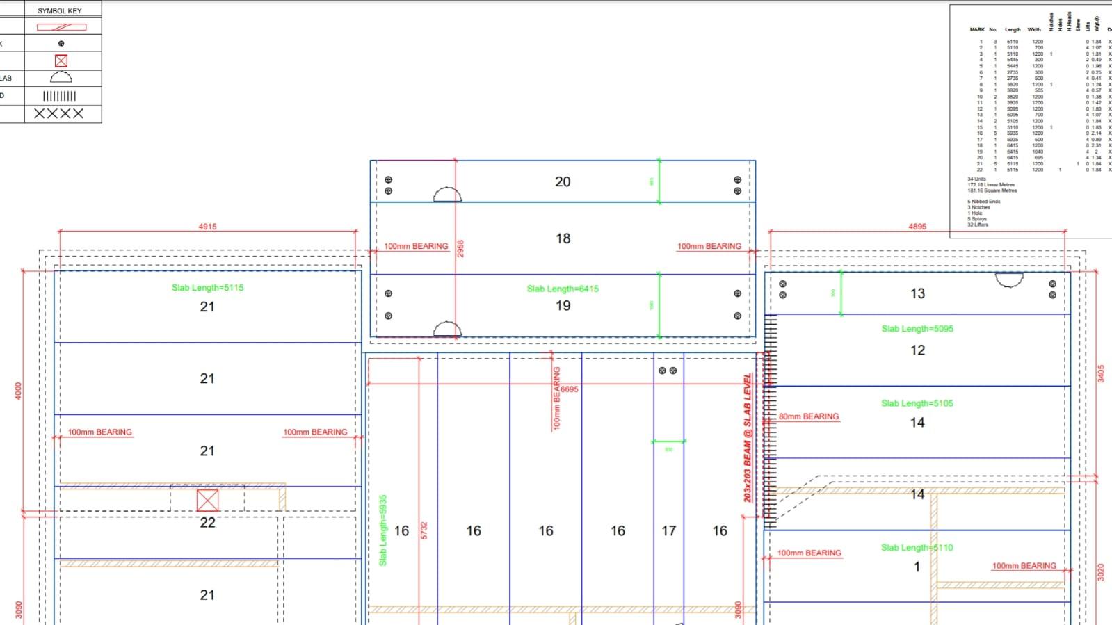

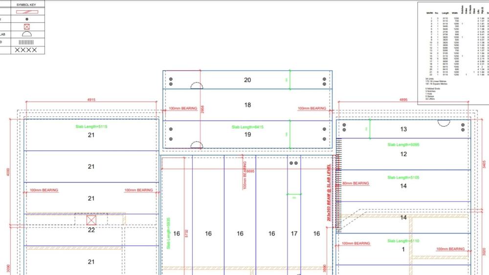

  1. Snip of precast drawing

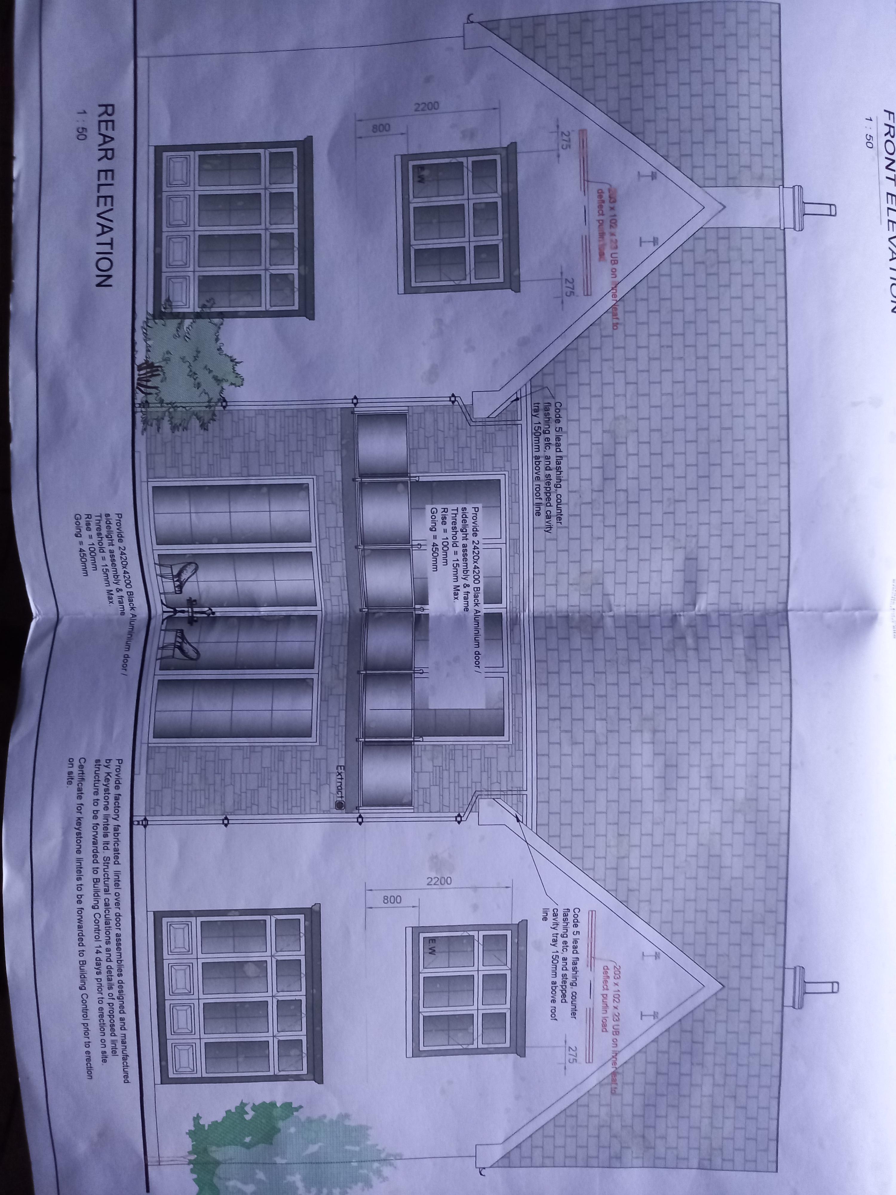

  2. I don't have any SE drawings that show anything bar steel in the roof , I can post elevations but they show even less detail about the porch. I can get one of the SE's at work to have a look at it but I want to settle my head on it first

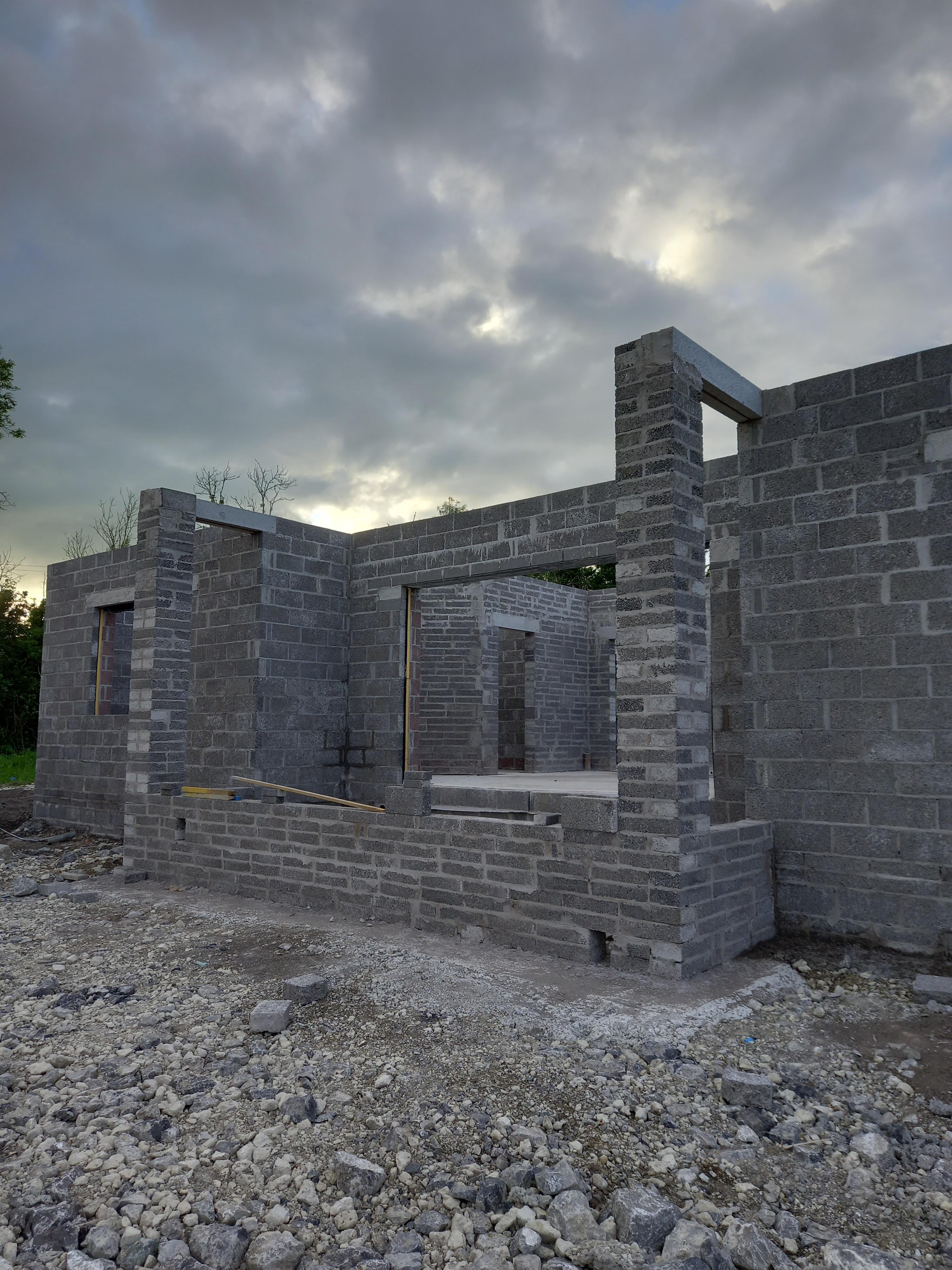

  3. OK Gents, I have precast slabs coming next week and have a conundrum I need help with. The attached photo it shows the rear of my house with has a covered patio which will also act as a balcony for the master bedroom. This will be achieved by using 200mm precast slabs spanning between the external leafs of the external wall and for the last 1.5 meters it will span between the lintels shown supported on the blockwork piers and the external leaf of the external wall. So to my question do I need to put a Steel between the 2 piers to stop any movement towards or away from each other OR the fact that I will pour a monolithic slab on top of them which will be 100mm wider than the slabs at the rear and parallel between the piers with will bond them and should also stop any chance of sideways movement. Apologies if this is a bit rambling and doesn't make sense but it one of those things is very clear to me but I keep ping pinging between my decision and the time is NOW.
